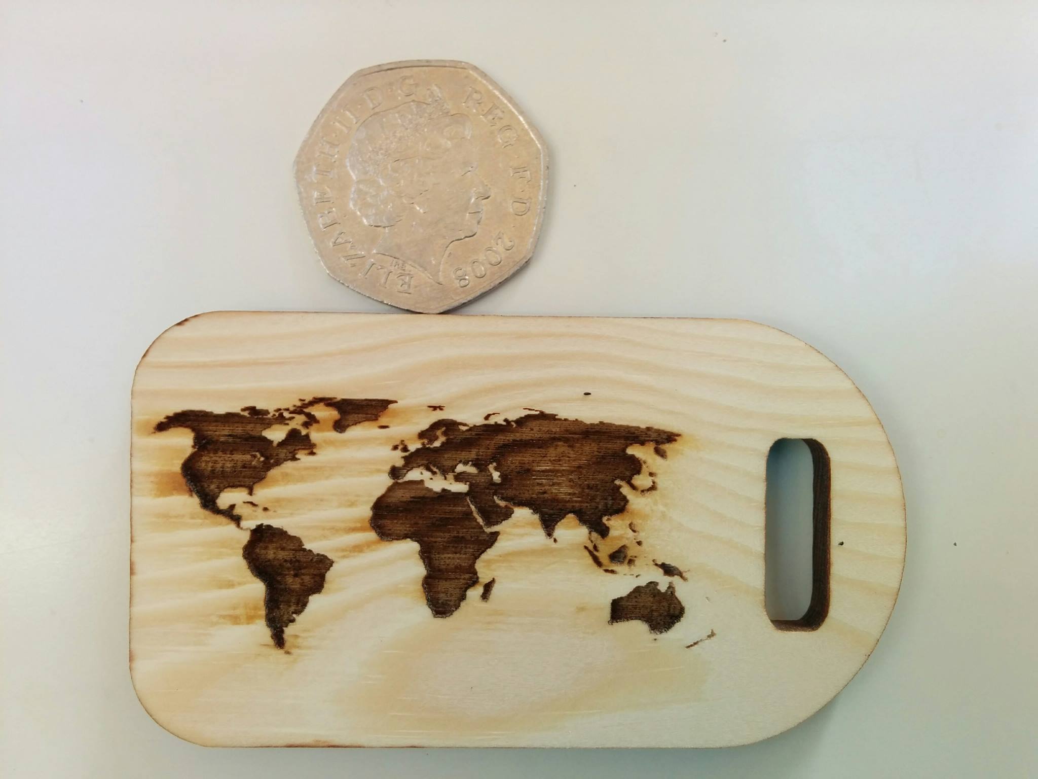

    Hi
    The machines are minimal in terms of elelctornics so most parts can be sourced on ebay. The only expensive part and maybe difficult to get is the laser tube. The sellers are pretty good at responding too. As for the software, it is basic but good enough for the job.
    see example 6mm pine, cut at 90% power 20mm/sec, engraving 30% power 200mm/sec:
    The good bit is you can send data to the machine through USB, Ethernet or just plug a usb stick in.
