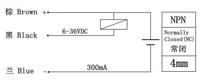

    may be a stupid question, but is there any way to wire lj12a3-4-z/ax NPN DC6-36V limit switches using only 3 wire cable where there are 2 wires plus separate shield? A way i mean that will reduce electrical HF interference from plasma cutter for example.
    Question comes from my ignorance and having a roll of that cable
    so i figured maybe the +-thingy could do some miracle and save me to buy another roll
    If you want to reduce electrical interference put in a fast diode to VCC to dump any big spikes and look for current rather than voltage. (To look for current stick in an opto isolator)
    OK. But i will need separate power supply for that optocouplers, yes? Now what comes to my mind is that my Galil DMC-2183 & 2 ICM-20105 Opto I/Oboard maybe has that already . later will read again the 300 pages manual

    If you want to avoid interference I would suggest twisted pair. I have a notion that there is a lot more to getting a signal in to and out from a Faraday cage than I know about
    As others have said, twisted pair might help. It's really intended for balanced/differential signals, but you can probably get a fair approximation to a ground plane by connecting half of each of the pairs (eg., the striped wires) to the same ground as the breakout board, and running your signals in the other halves of those pairs.
    Also, a ferrite around the cable may help; they're fitted to VGA cables (and the like) to suppress high frequency noise.
