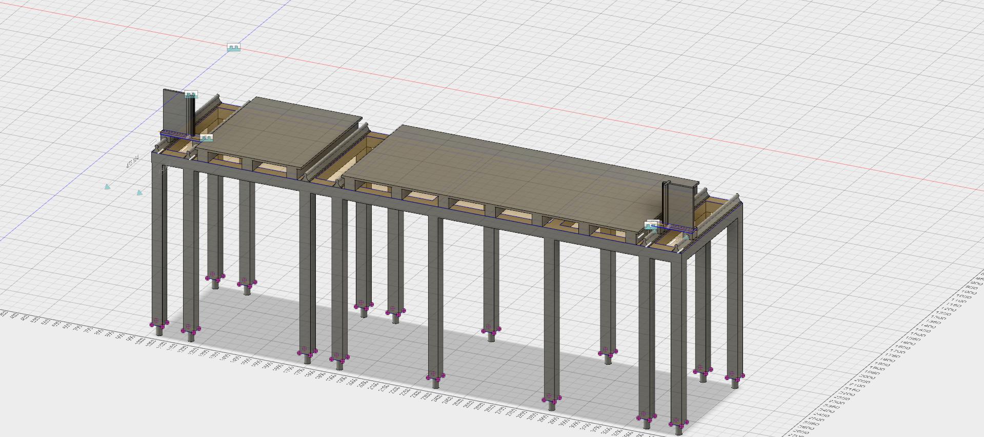

    I found Autodesk Fusion 360 (thanks again to the info here) which integrates CAD and CAM so have started using it. I'm brand new to Macs so am still learning the in's and out's of screen shots etc.
    I won't be having the foam cutter anything other than flat as it wouldn't be possible to keep the foam block and the cut part in the correct position at the end of the cuts and would cause damage to the parts. With the block flat, I can use double-sided tape and gravity.
    Better keep drawing, hopefully have some info and pics for you soon.

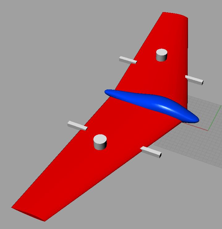

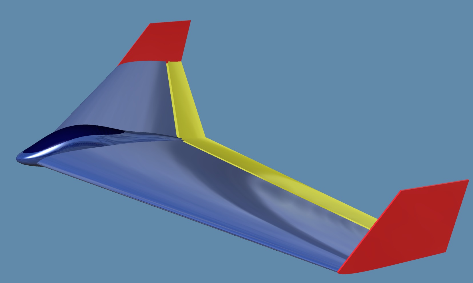

    Sorry can't help you with any info on the 4 axis hot wire but Silyavski may have a point depending on what you want to do. If you need to cut a lot of wing profiles rapidly the hot wire is obviously the way to go but if time is on your side then simple 3 axis milling is not such a bad idea as it gives you a lot of options that hot wire can't do. A relatively flimsy but fast 3 axis router dedicated to foam cutting should be easy to build.
    Had to dig around to find the model but several years back I did cut a few gliders for a friend on my router. He asked me to cut two wing profiles and I suggested we cut the whole aircraft in one go. The entire model including the fuselage was cut from one big piece of foam with a two sided strategy excluding the wing tips which were glued on afterwards. The screenshots below shows the model I drew using his wing profile. I know sh%t about aerodynamics so I just went with a sort of a teardrop shaped thing for the fuselage so he's got somewhere to put the battery and receiver:-) The white round bits you see on the wings are just supports used when I turned it over to cut the bottom profile. The piece of foam was bigger than the model so it was supported at the wingtips as well.
    Don't think I have any pics of the actual cut models but apparently they flew very nicely :-)
