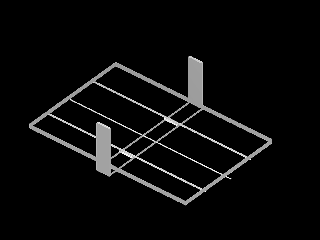

    Oops.. Forgot to set my render settings... This is a bigger image...

    The cable design looks funky! But I am still unconvinced by using an active system, I would be concerned about slippage, stretching etc..
    Dont know if this will help but here goes........
    The cable system shown looks like it is one continuous cable. I recently had the joy of repairing a Freelander electric window How ever the way it worked looked to be adaptable for CNC. (now the hard bit)
    It used 3 cables. 1 connected the two slides together (via pullys) so they always stay the correct distance apart(i.e. anti-racking) each slide then had a cable going back to the motor. These were attached in opposing directions,(as one wound on the other wound off) In effect the sytem is only ever pulling and cant slip because each end is locked to the drive pully.
    The only dificulty is that the distance of travel is governed by the diameter of the pulley and the width (no, of turns). If you increase the width to much then it will cause an arc and introduce an error.
    If circumference = pi x D then a 100mm dia. pulley with only 5 turns on it the travel would be 1570mm (if Ive got that correct ) would probably need a belt reduction to the motor to get any reasonable power.
    For a bit of stainless cable and a few pulleys its got to be worth a try

  4. I would be concerned about slippage,
    No they can't slip; theres two cables, one from left/rear to right/front the other from right/rear to left/front.
    Basically, if say, the left side moves forward, it pulls on the cable which pull the right side forward it the right side moves it pulls the left side.
    As long as the cable tension is maintained (e.g. by a spring) the gantry cannot twist or 'rack'.
    Hmm.. Still sounds like a lot of cable, surely stretching is a potential issue? Also additional belt reduction is another layer of complexity?
    Bearing in mind this is an ultra cheap mdf jobby (will make the next one on the mdf machine), I was looking for simplicity and ideally a passive system..
    Still, if you have actually used this system and got accurate results from it, I will investigate it as another option...

    I would have fought that the wire would be able to rip the machine apart before streching becomes an issue, I'll have to check the tensile strengh of stainless (got an equation somewhere for calculating stretch)
    Belt reduction isnt that much of an issue, some people use it on ballscrews anyway to reduce alignment problems with direct drive.

  7. I was looking for simplicity and ideally a passive system..
    Well, that's what I was talking about. I.e. the gantry is still controlled by your lead-screw, the two cables just stabilise the gantry.

    Instead of all the pissing about with pulleys why not make each of your your gantry sides a little wider so that you can space your linear bearings further apart to prevent racking, yes you would loose travel distance but it may be easier, this is what I have done with mine for exactly the same reason. I have also upgraded my X rails to THK 20mm and put two bearings on each side, slightly overkill for what I am doing but better safe than sorry.
