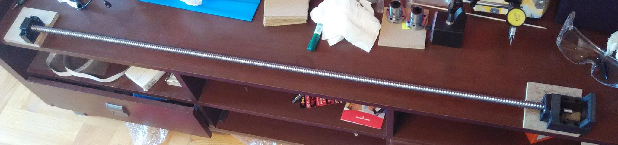

    I bought two HIWIN balscrews and asked seller to machine ends. I've put the long ballscrew (1,3m / 4 feet) into bearing blocks (BF12) and it is stable only in one position (which I guess, means that it is either bent or machining is not concentric).
    Here what's happens when I hand tighten the bearings (2x 7001A - DF cinfiguration). Bearing Block is moving in a circular fashion. When I press it down so that it cant move, ballscrew becomes hard to rotate
    https://www.youtube.com/watch?v=bfo-9KJfJu0
    I know that it's not on a perfectly flat surface - is this the reason for it or it is the ballscrew?

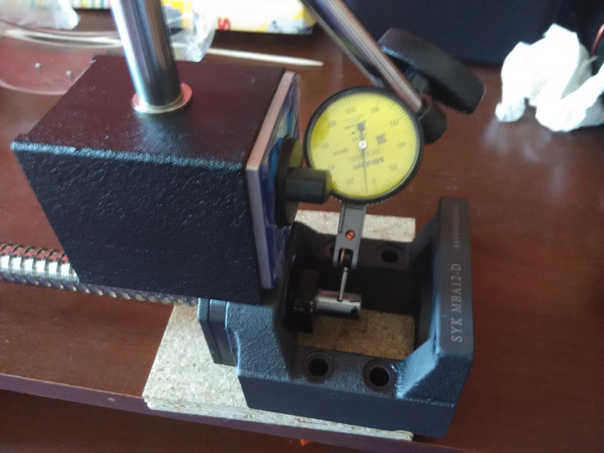

    I've also measured concentricity as shown on the picture below and TIR is around 0,1mm / 0.004" which, I guess, could also mean that bearings are not concentric.
    Any ideas whats wrong?

    It appears like the either machining is not concentric or bearing block isn't but to be honest untill you get the end bearings fully fastened down and everything tightened correctly you won't be able to tell.
    I've seen screws look much worse than this on bench turned by hand or drill and be perfectly fine when on the machine.!
    I'd suggets you mount it and setup correctly attach a stepper then do some measureing.!

    Thx for reply. I hope you're right.
