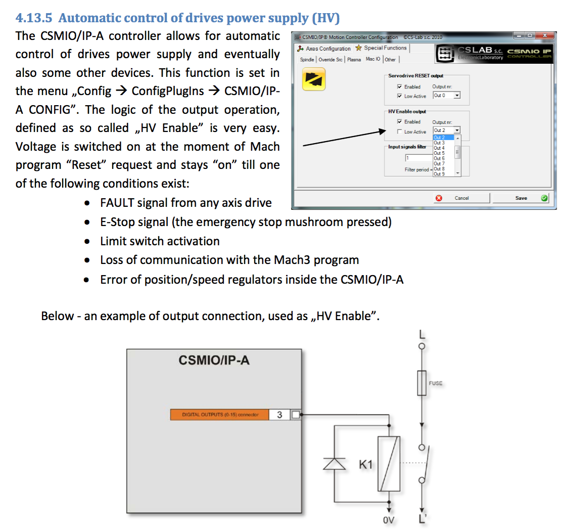

    Thanks. I have a question about enabling '0V' for the drives.
    Currently, to enable the drives, I need to provide 0V to a certain wire which allows a relay to activate (24V).
    I have looked at the wiring diagrams and believe I understand how to wire the limits, E Stop, spindle activate etc.
    What I am unsure of is how to enable a 0V grounding to enable the drives. I could reverse the wiring which means that it will switch the relay on, on providing 24V. There seems to be a specific way to do this in the manual as per below. Here, it seems to be for the same purpose but the 24V and 0V are reversed. Is this what I need?
    There is also an option for 'low active', does this inverse the logic to satisfy the current need for 0V?

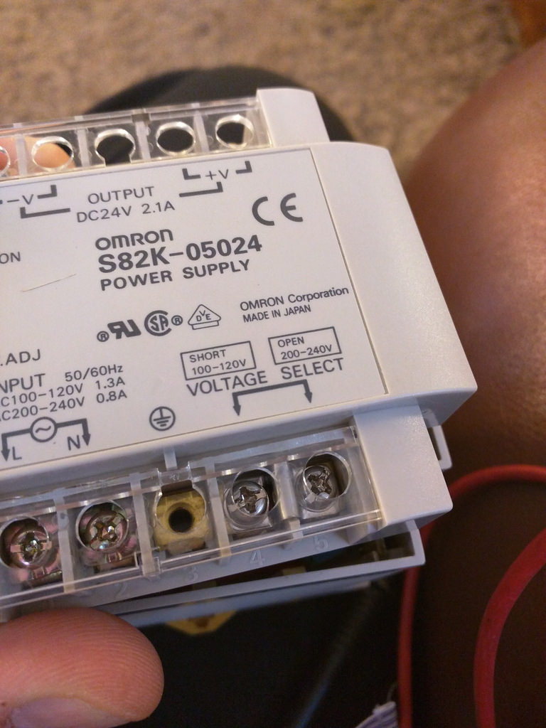

    On the topic of the 24V PSU, if you look carefully, there is a bridge there .... :-(

    Chaz the Cslabs Controller outputs are PNP logic so you can't control 0v only Load. So change the relay around and provide it with Positive.
    The way the outputs work is you provide 24V and 0v to each bank of 4 outputs. Then each output switches the Load. The Load must share the 0v of the Output.
    It's similair with Inputs as well except that each individual Input is provided with 24v & 0v but you can choose which to sense. So can use NPN or PNP logic if required.
    The HV option could be used for enableing the drives but again it just uses an Output so will be PNP logic.
    Low active just changes how it reacts or switches and doesn't inverse the voltage etc. IE: Active if Voltage goes High(24v) or Active if voltage goes Low(0v)
    Or in case of outputs If OUTPUT High Turn it Low when active and vise versa.!
    EDIT: If controlling relay with OUTPUT make sure the relay coil load isn't more than 250mA otherwise you'll damage the OUTPUT.

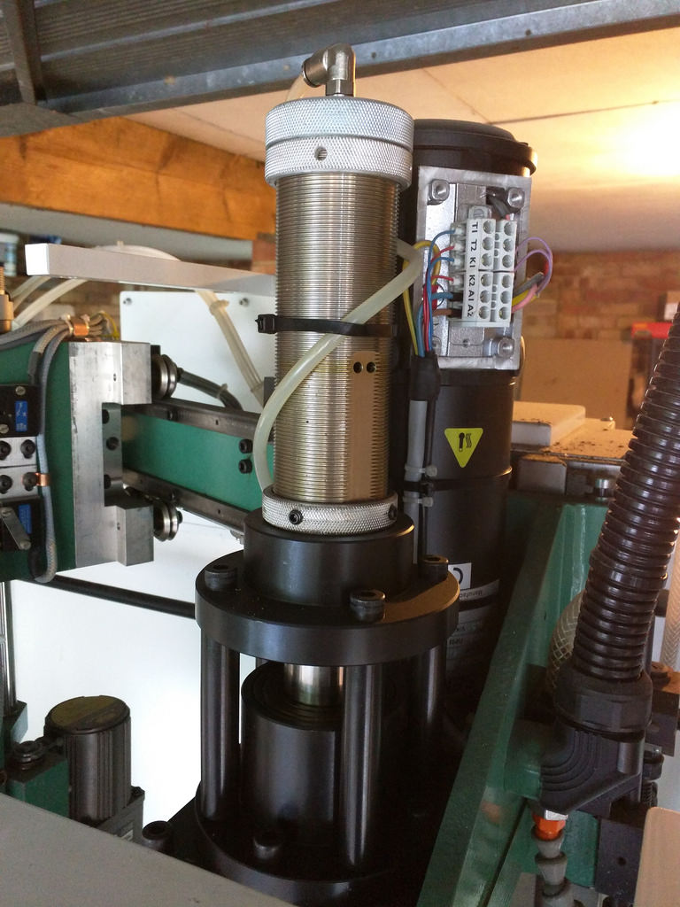

    I am trying to get the missing solenoids replaced but am stuck with 1 open question.
    There are 4 x small pipes going up to the ATC for left / right / up / down and one single 6mm OD pipe for what I believe to be the drawbar.
    When you look at the spindle however, there is a single pipe, I presume this is the same 6mm pipe to activate the drawbar?

    the 6mm pipe is for the drawbar
    Perfect, thanks.
    Getting pricing from http://www.jjairsystems.co.uk/ for the manifold, 5 solenoids (2 x ATC left / right), 2 x ATC down / up and drawbar).
  10. #120
    i2i's Avatar
    you wont need 5, just three. The in/out can be done with one valve, same as the up/down.
