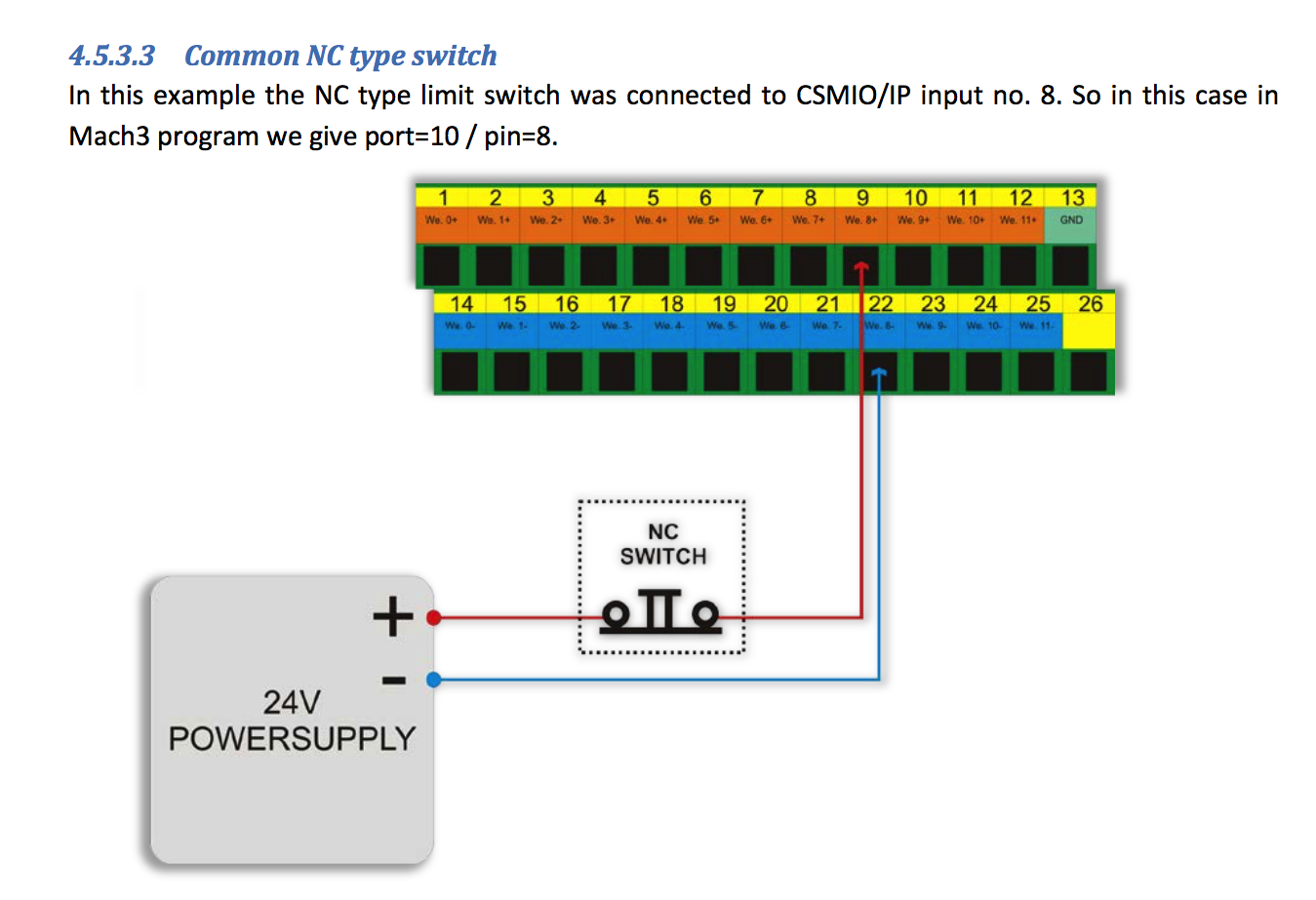

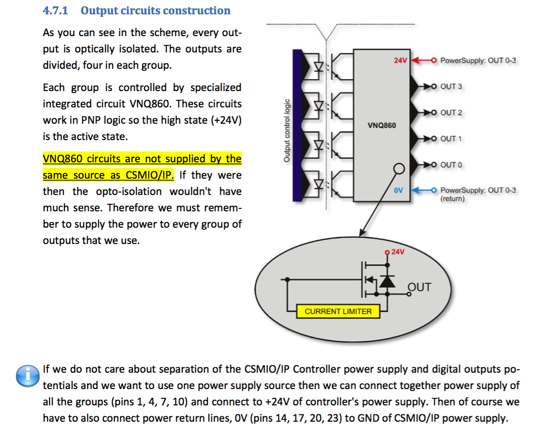

    Chaz's Avatar
    On the topic of isolation, when providing 24V for the purpose of something like a limit switch, should this come from the same 24V that powers the CS Labs unit or one of the outputs of the device itself to try provide some level of isolation?
Name:	Screen Shot 2015-06-24 at 07.48.53.png
ID:	15617   Click image for larger version.
Name:	Screen Shot 2015-06-24 at 07.49.31.png
