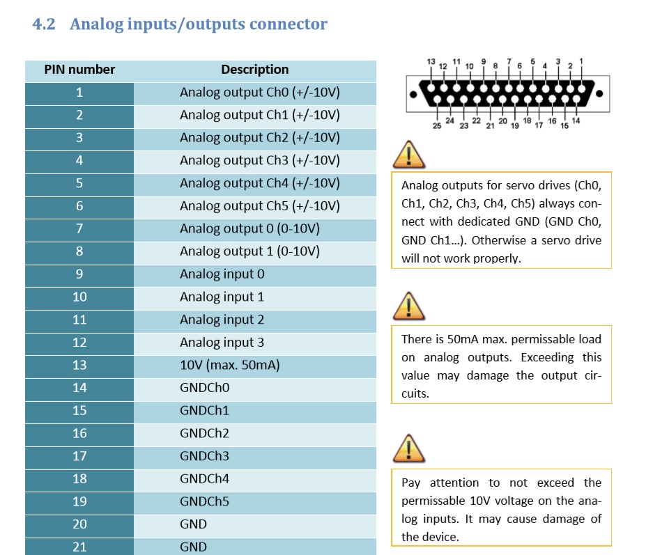

    Hi, so update time. Mostly there now, busy wiring in the DC Drive input isolator. I just want to check, some of the wiring a bit uncertain about.
    This is the board I am using, as recommended by i2i.
    http://diycnc.co.uk/spindleV5x.pdf
    On the board, I need to provide 24V DC, straight forward, I take from my 24V PSU rails.
    I then need to provide the 0-10V output to the old DC drive, check, 2 wires, sorted.
    I then need to provide GND, STEP, DIR and Run / Enable.
    From my CS Labs unit IP-A, I get an Analog Output.
    So, looking at the image below, I take from pin 7 (Analog Out 0) and pin 20 (Gnd) - do these go to the GND and STEP inputs on the board?
    What do I use for DIR And Run / Enable then? Are these from my CS Labs unit (24V switched outputs)?

    Gnd. Gnd
    Step. This is a 5v logic level pulse and is normally a configured output from the parallel port that gives 2000 pulses for full output, which will be 10v dc.
    Dir. This is a 5v logic level relay.
    Run. This is a 5v logic level relay.
    The board is basically a DC isolated frequency to voltage converter with two added relays

    I am not sure what you are going to do with this board, the CSMIO/IP-A does not have any step and direction output, the controller has a 0-10V output that goes to the spindle speed control. If you need isolation because the current spindle has no isolation, then you are better to just throw the spindle away and stick an inverter and ac motor in the system.

  7. #157
    Chaz's Avatar
    Lives in Ickenham, West London, United Kingdom. Last Activity: 1 Week Ago Has a total post count of 1,657. Received thanks 115 times, giving thanks to others 71 times.
    Chas I don't see an image!!
    Sorry, I copied / pasted the post and was surprised as I could see it. Clearly no one else can ;p
    See below.

    Quote Originally Posted by dodgygeeza View Post
    Ye, its just more money though that I dont need to spend.
    Ill rather get this working, if someone can help with an isolation option / circuit and then later look to put in a higher speed spindle which will be useful for cutting the items I want to cut.
    Chaz send an email to Roy and ask him if the dc-dc converter is 1:1. If so you can probably run the ipa 0-10 through it instead of the generated voltage from the diy cnc board. ( please check this with Roy first )

    Thanks - just done.
    Will wire up to be manually set for speed until I get some options.
    Could I use the 5V from the Encoder output terminals on the CS Labs unit to allow me to enable the board? I dont have any other 5V supplied that I can use.
