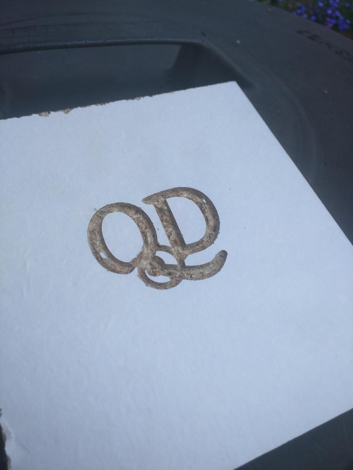

  6. #166
    Chaz's Avatar
    And we have life, although the motor output is being set manually at the moment and still need to sort my machine runs X Y positive when controller resets.
