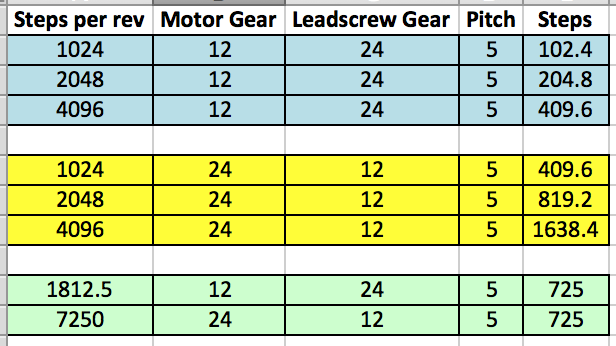

  6. #186
    Chaz's Avatar
    So, not a trick question .... but would like some confirmation of what my X and Y steps should be. I have it very close but Id like to know how the number is calculated. I know the formula, but on the current info I have, the 725 value does not look correct.
    The issue is that I dont know the config of the drives. I do not have access to them and therefore there could be a host of different 'steps per rev' measurement. could be a number of values.
    So If I take some of these, I cannot match the value that I am currently using which is 725. This seems very accurate, I am getting measurements within 1% but I need to do more testing. I may have a bit of backlash which *might* account for some inaccuracy, certainly on my Y.
    Please see the table below. I take a number of options and nothing matches 725. I then swap the gear ratio around and the closest I get is 819.2.
    The third table (in green) I simply reverse engineer from 725 and get some random steps / rev, could either of these be correct?

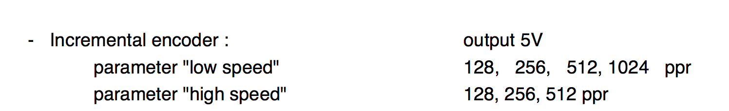

    The claimed maximum output from the driver manual is 1024, but am aware that this could be multiplied by 2 or 4?
    Thoughts?

  7. #187
    i2i's Avatar
    for a stepper fitted machine, that has 400 steps per rev, and the gear reduction is 2.5:1, with the 5mm pitch you get 200 steps per unit in metric. For a 2:1 gear reduction it should be 160 steps per unit. All you have to do now is equate that to the steps per rev your motor has.
    steps per rev / ( ballscrew pitch/gear reduction ) = steps per unit
    If you have a bit of backlash check the angular contact bearings at the pulley end of each ballscrew, they may need adjusting.
    Ps. don't forget to fold the tab washer flat to adjust the nut.
  8. #188
    Chaz's Avatar
    Thanks, so based on my pulleys being 12 / 24 (motor end / ballscrew end), 5mm screws, using 725 steps for damn near 100% accuracy, what do you believe the steps per rev is on the current IRT 1306 drives via the simulated encoder outputs?
