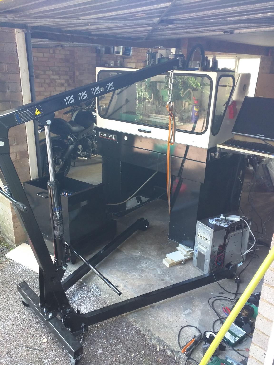

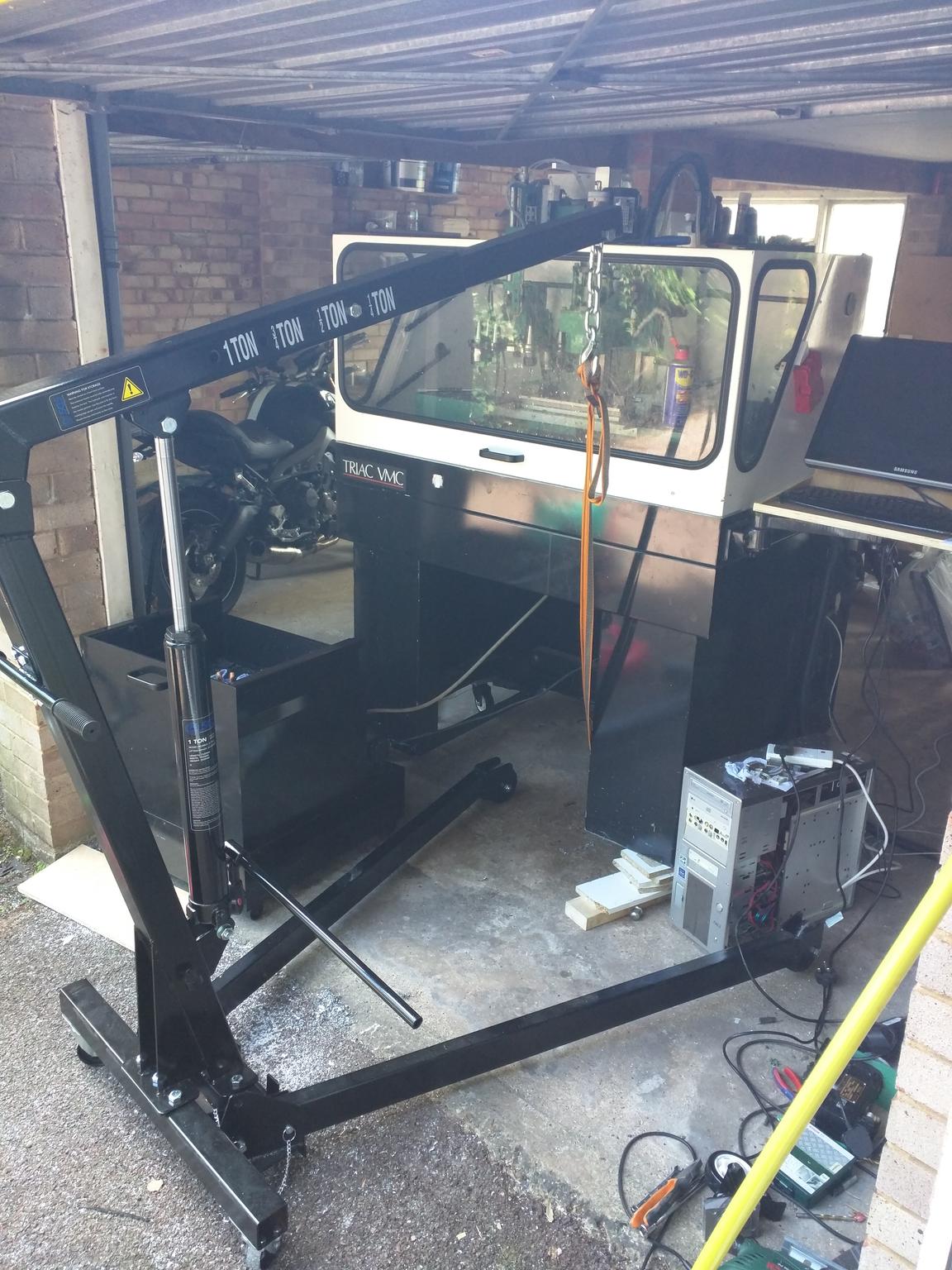

    Machine is running but I need to do more tweaking. Need to recheck the PID control but generally fairly happy. Taken most of the backlash out both mechanically and with Mach 3.

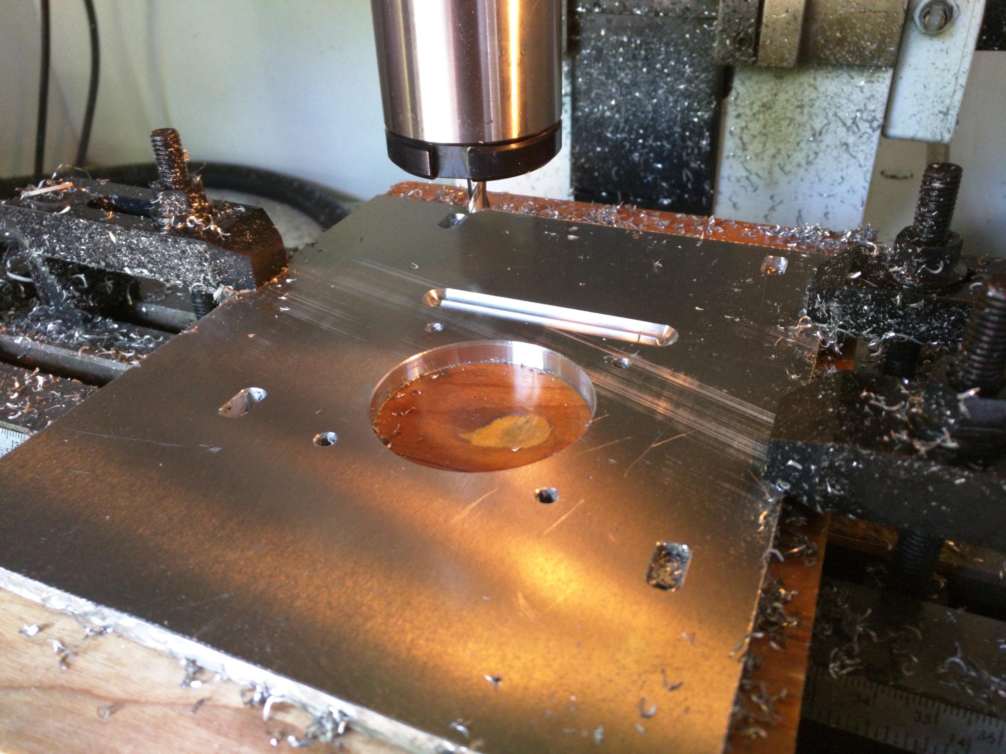

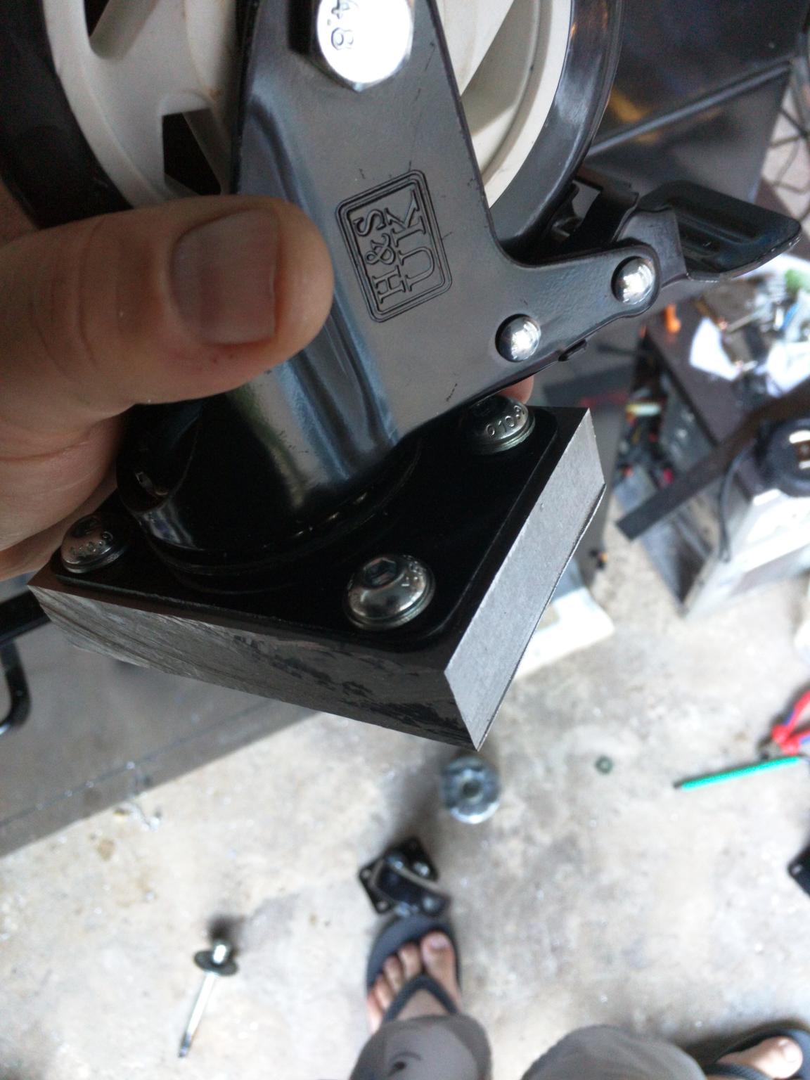

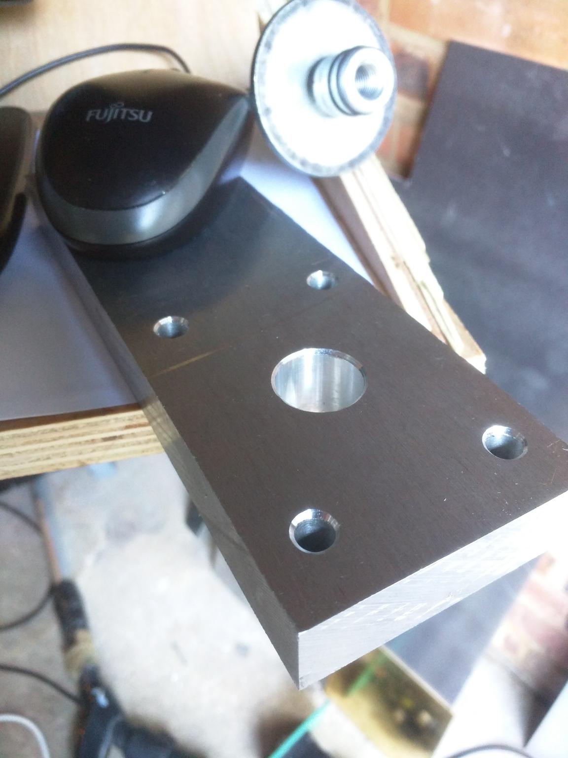

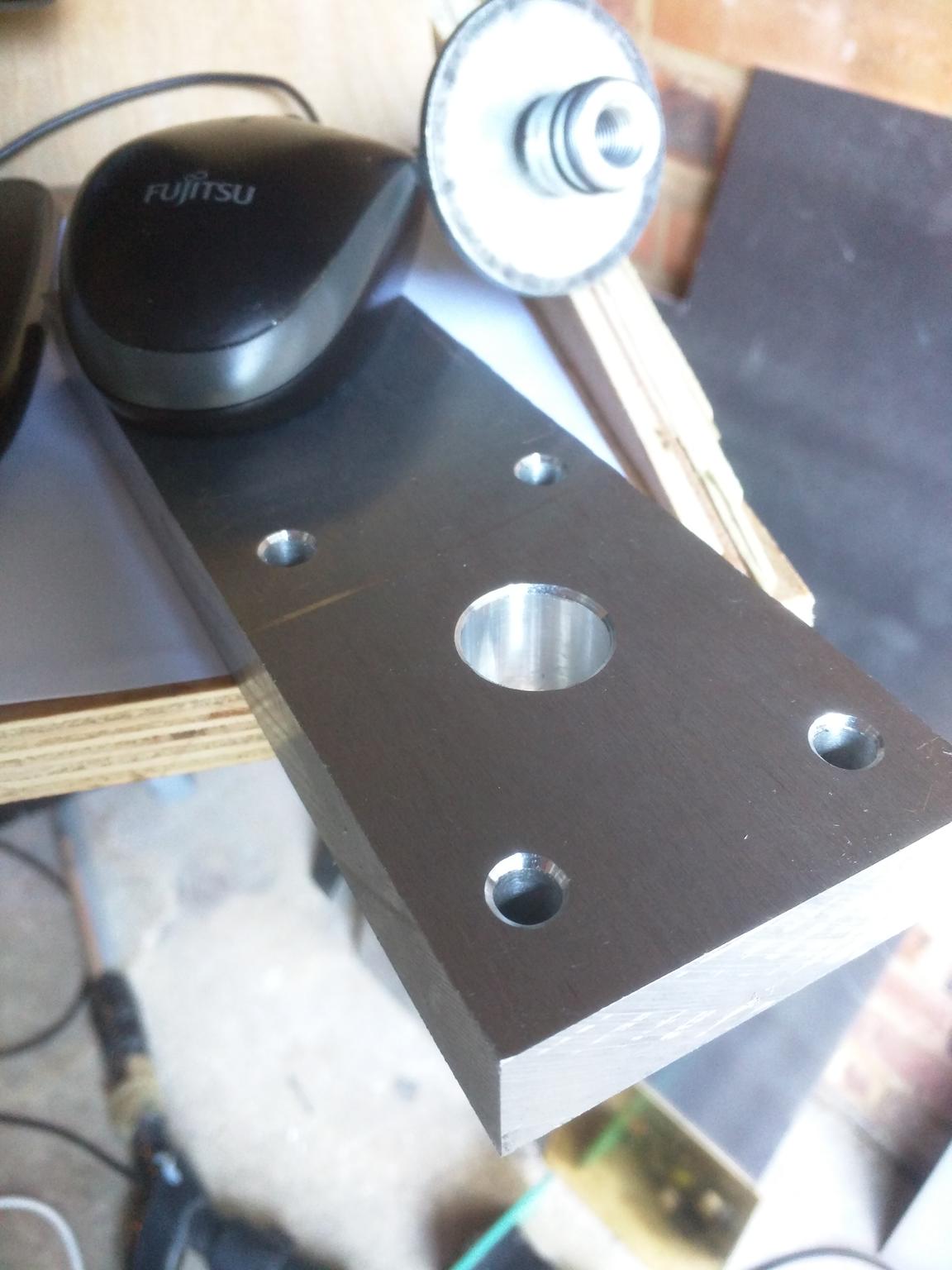

    Needed to move the mill but no method available. The engine hoist I bought isnt wide enough. Got an idea to buy some heavy duty castor wheels. Tried to fit them but the metal I wanted to put them on was too flimsy. Came up with a good plan, had some 20mm Alu plate for something else but milled myself 4 plates to basically mate the wheels to the load bearing beams, using the original shafts.
    Some pics below, the CNC has now been moved to the location I wanted it in the garage. Last pic is of a new X plate but I ended up having a problem with it, so it wont be used.
