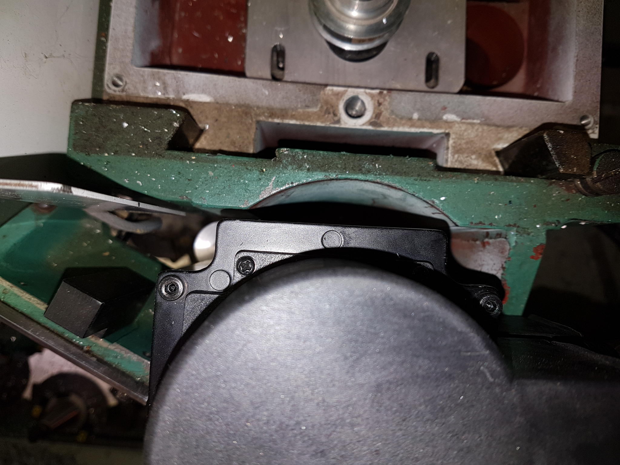

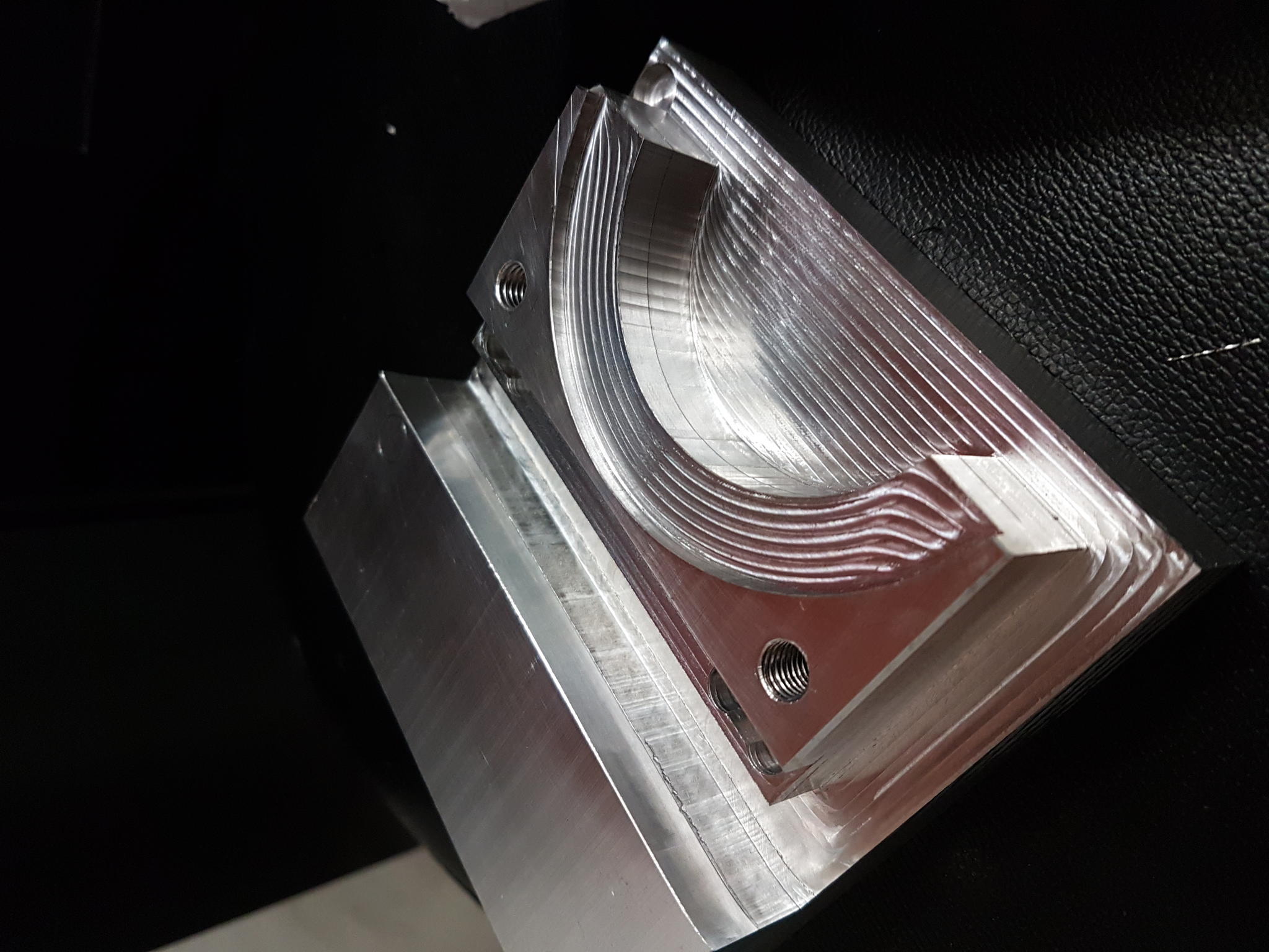

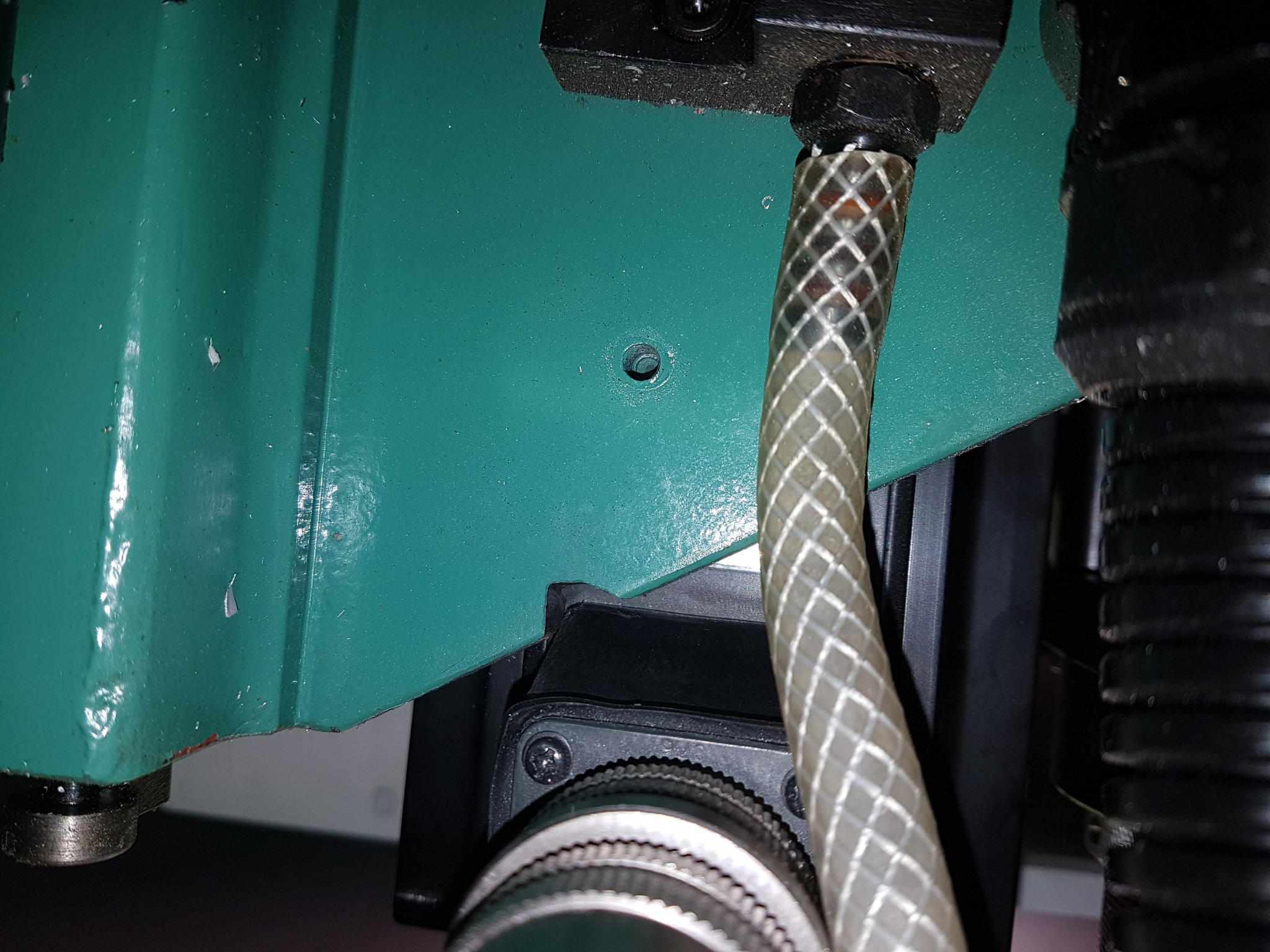

    Did you get any pics of how the servo fitted?

    No, but will sort. I do have some older pics, lemme see if I can find them.

    Chaz's Avatar
    I've just got to say, that typo made me smile :-)

    Difficult to show with existing pics. Ill take a vid on the weekend.
    Tight squeeze, had to remove some material for it to fit and a pic of the bracket used.

    Lives in East Lothian, United Kingdom. Last Activity: 17 Hours Ago Forum Superstar, has done so much to help others, they deserve a medal. Has a total post count of 2,990. Received thanks 374 times, giving thanks to others 9 times.
    That's certainly a tight fit.
    Any idea what size flange is on the motor?
    I think a 100mm flange motor would squeeze in, however I couldn't find any with the power I was aiming for, so opted for a 110mm motor, and spacing it up.

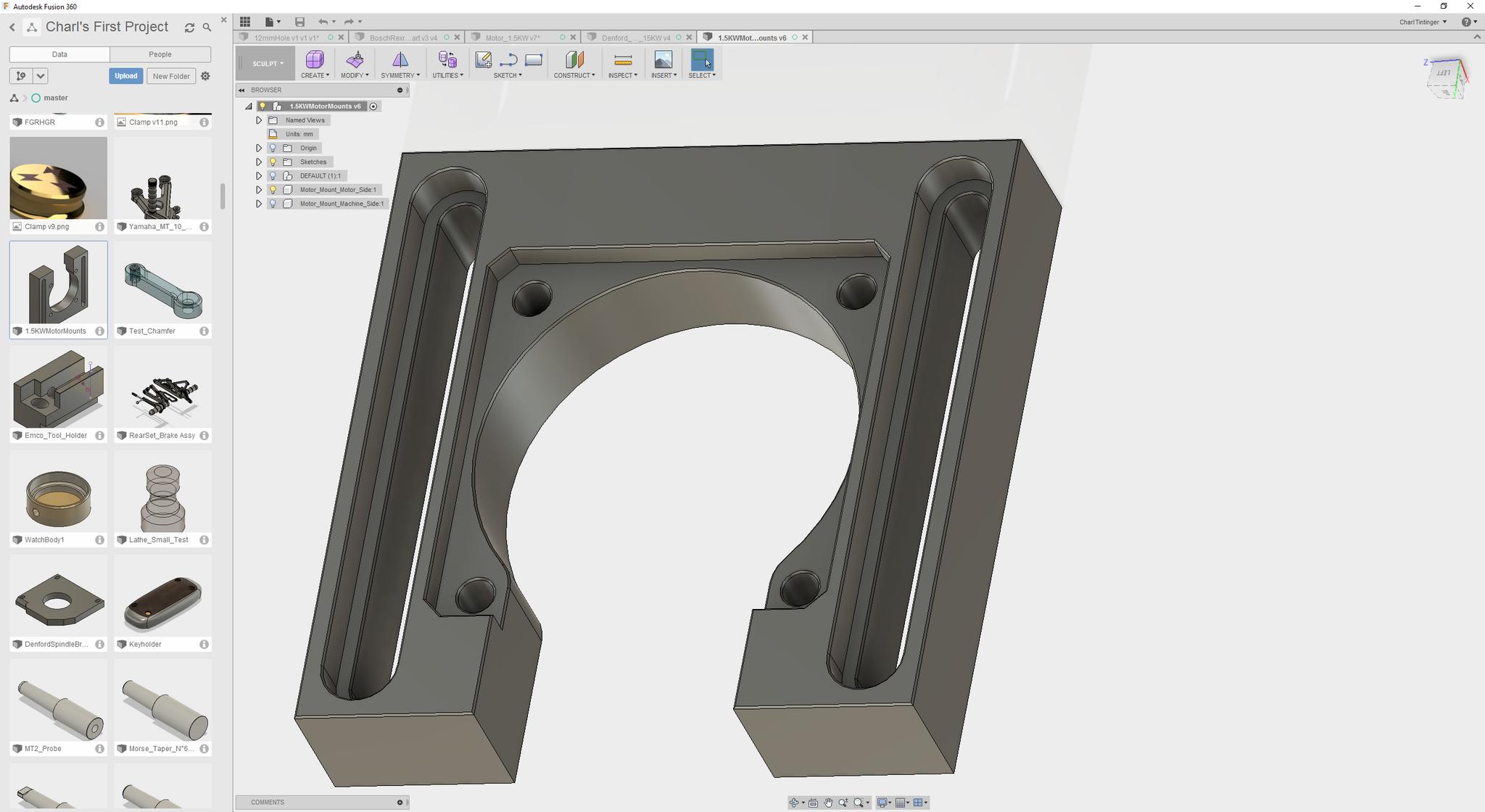

    Chaz's Avatar
    Ill share the sizes tonight. Ive got the original flange drawn up as well as the info on the Panasonic 1.5 KW servo.
  7. #237
    Chaz's Avatar
    The plate that goes across for the DC motor is 115mm x 110mm (Depth).
    The motor mount bolts are 81mm across from C to C. The recess flange is 100mm.
    This is the motor mount for my Thor machine Y Axis (same motor as used on my Denford for spindle here).
