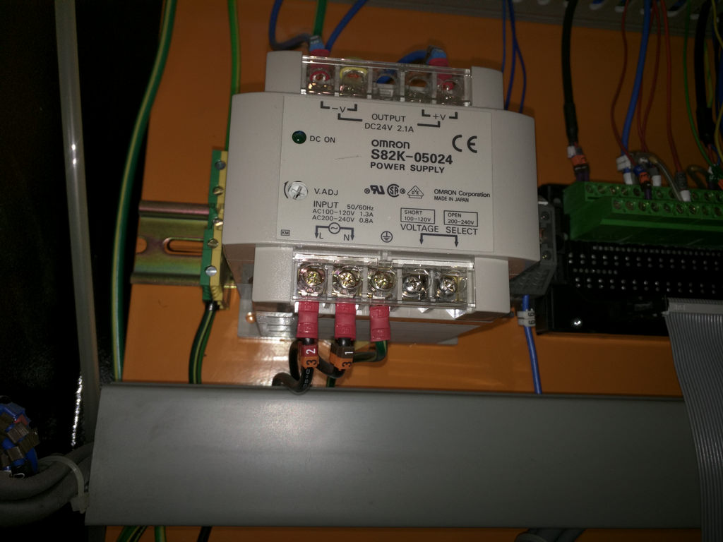

    Does this look like I can feed with 220V instead of 3 Phase to get 110V?
    I suspect so but ideal to get some confirmation - saves me needing to get a 220 / 110V transformer.
