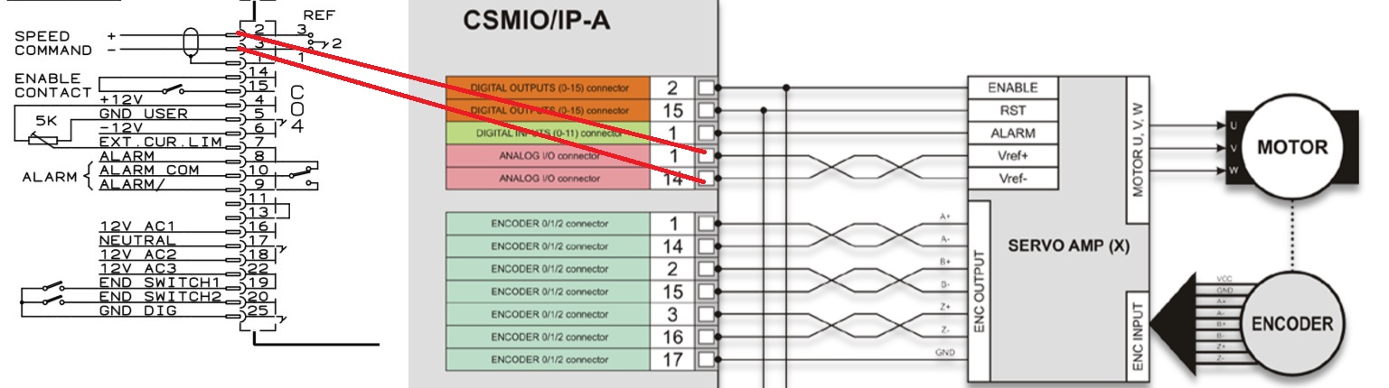

    Chaz's Avatar
    Can I double check something, for the 0-10V Analog input, this shows using 1 and 14 for the first axis. On the pic below, the left hand side is the wiring of the drivers.
    Is VRef- 0Volt or something else?
    I assume VRef+ is the 'up to 10V'?
    Are my red lines below correct to show how they should join?

  8. #68
    Ok well kind of right but your needing ANALOG +/-10V OUTPUTS for the Channel(axis) your using.! . . . It's not 0-10V ANALOG INPUTS they are very different things.!!
    I realise you probably know this but it's these little details and wrong INFO back to us here that can get confusing and you in BIG trouble if we do and your letting out Magic smoke.!
    Vref - = Negative Voltage ie: -5v = right direction at half Motor rpm
    Vref + = Positive Voltage ie: +5v = Left direction at half Motor Rpm
    Manual will show you which pins are for Negatve and Positive for Each Channel(axis). Careful you don't Mixup the GND because the Channel GND's are different to Analog input GND's on same connector.!
  9. #69
    Chaz's Avatar
    OK, have some success. Long story ...... dont trust things till you have opened the connector and verified each pin.
  10. #70
    Argh the old pin shuffle gotcha trick.!! . . . Got me too many times. My prefered way of converting is to rip the guts out and start again. It's often quicker than chasing dodgy wiring and connectors.!
