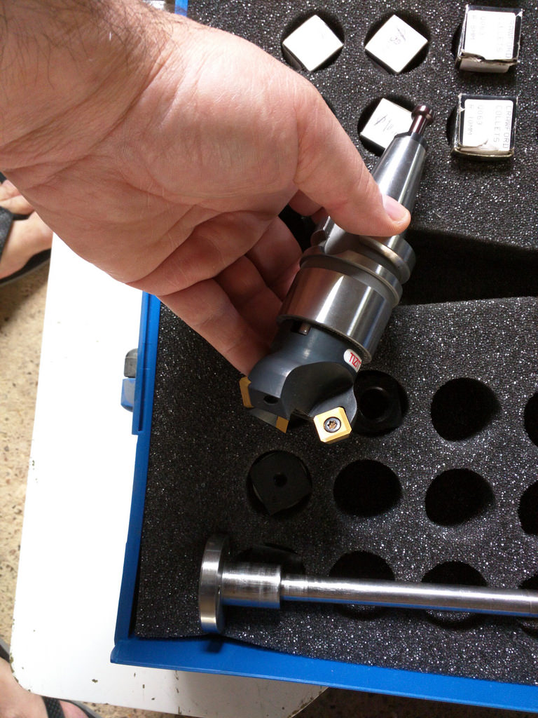

    So very pleased to start this thread. After my previous thread of 'what decent milling' machine, I found a school owned Triac VMC for sale. After a massive struggle to transport the unit and buying it unseen, it was delivered this morning. The mill was sold with a few extra tools but with a fault that the OS does not boot up. On the basis that I will likely retrofit some / all of the electronics, I considered this in the purchase decision and costing.
    Initial thoughts are wow, its massive. Its also fairly heavy, as we had discovered when manually unloading it. The lads had loaded it up the previous day and clearly hadnt learnt about getting an engine hoist or similar to help.
    I will upload pics in a bit, but the mill looks fairly clean, little use. I could not lift the front door to see much more as its interlocked and needs power to unlock.
    Not a lot of unhappyness, apart from when they left, I tried to close the garage door and could not. Fortunately a bit of an effort and the garage door was closed. There is a bit of damage on the bottom as the machine has been man handled to move it but nothing serious.
    The machine has come with more tools than expected and also a semi decent looking vice. I suspect if I add up the tools and few extras, some value already.

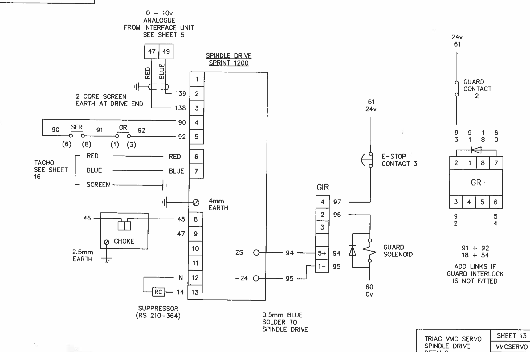

    The Spindle looks to be DC, running from a 0-10V Analog signal.

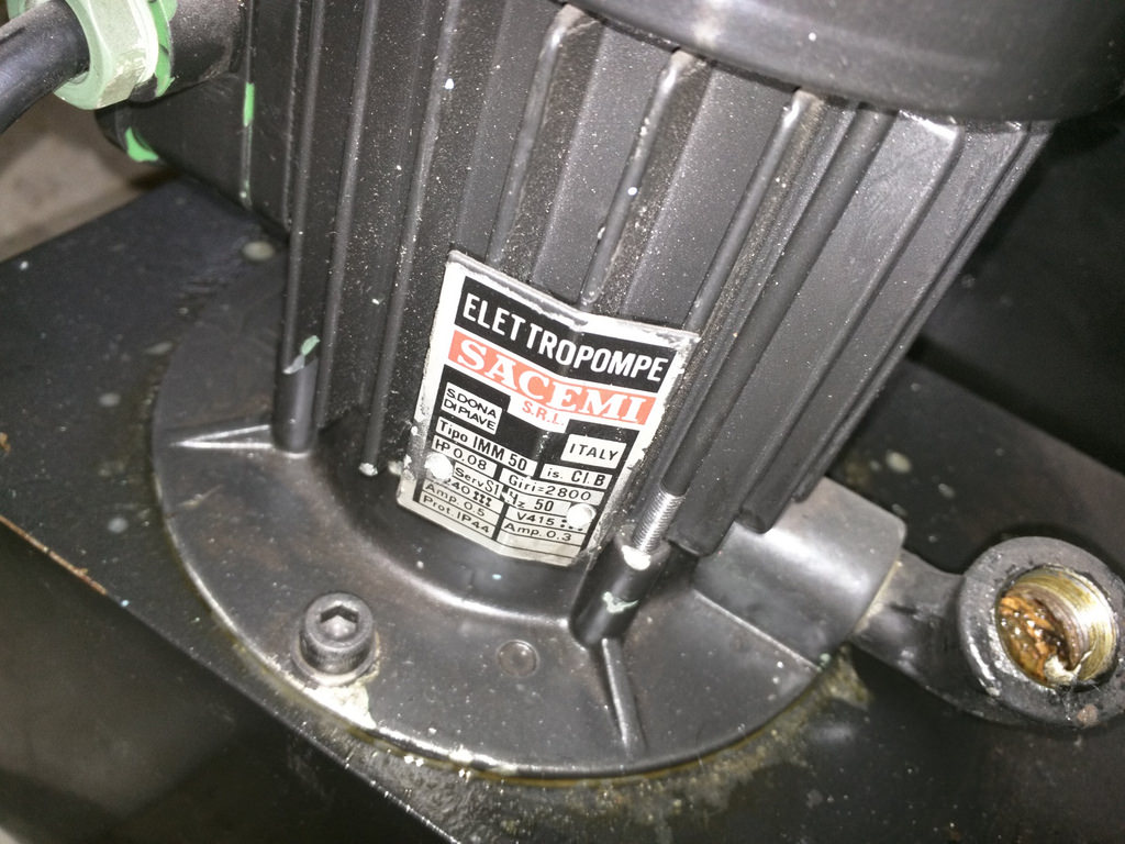

    The coolant pump seems to be the only 3 phase item .... I need to see how I can sort running on an inverter or moving the power to single phase.

    OK, so first pics. There is something missing in the top left of the cabinet ...... and then on the top right of the ATC. Any idea what this could be? The wiring diagram doesn't seem to show what this is (shows as empty in the commissioning data). Will have to trace the wires to see where it goes. The rest look like pneumatic tubes or similar.

    Spindle Controller is http://www.sprint-electric.com/techn...0Man-iss-h.pdf
    Sprint 1200.
    Any thoughts on the quality of this? Unless its faulty, will aim to reuse this.

    You could probably replace the transformer with a single phase one provided the overall rating is sensible. Or replace the whole PSU.
    If it is a DC motor with the usual thyristor controller then that will probably run happily from single phase with some careful re-wiring. Actually checking the manual you referenced above it has a single phase mains connection anyway!
    The coolant pump is more of a problem but its power is probably low and you can run 3 phase motors from single phase using some capacitor trickery - or use a cheap inverter - or replace the motor - or dispense with pumped coolant!

    This is the coolant pump. Id like to have this option if I can. Small power, so must be an option to sort this. Id like to upload the schematic (in pdf somewhere) and then link it for reference to anyone interested.
