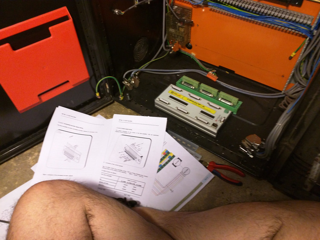

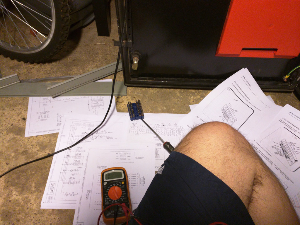

    OK, so some progress.
    Completed:-
    Converted most of the power system to single phase. Need to still sort out the coolant pump however.
    Removed the old PC to make space for the CS Labs controller.
    Looked at a lot of the wiring, for a long time.
    Worked out that from the 3 Axis connectors that used to go to the old PC, I can basically input and output to that 15 Way D sub connector to get encoder signals out and speed reference in as well as satisfying some of the logic requirements.
    Worked out where the Spindle Drive 0-10V can be connected to on the standard block. Some of the logic that enables the drive I am not sure about yet.
    Fairly happy with the progress although so much to look at and find on other sheets / cross reference, takes ages.
    All going to plan, I should be able to move all drives and start the spindle tomorrow unless there is a unit faulty or something goes wrong (hope not).
    Will use a laptop at first to setup the CS Labs unit and get going until I can build a PC into the cabinet. Not sure about space as the CSLabs unit takes a fair whack of space, might make another plan.
    Chaz's Avatar
    Fun fun fun ...

    Lives in East Lothian, United Kingdom. Last Activity: 5 Days Ago Forum Superstar, has done so much to help others, they deserve a medal. Has a total post count of 2,994. Received thanks 376 times, giving thanks to others 9 times.
    Looks like you're making reasonable progress.
    One thing I meant to mention in my last post, is are you sure the coolant pump will run on single phase? Just because it's marked to work on 240V, it will most likely be for 3 phase 240V.
    AC induction motors that run from single phase require a start or run capacitor, whereas 3 phase don't, as well as having different internal coil wiring, so it's highly unlikely the same motor will run from both 3 phase and single phase.
    Oh, not sure actually. Will leave it for now, will try it later and see. Else a small VFD might be required.
    i2i's Avatar
    For the coolant pump you will need to reset the connections in the motor input to delta and run it from a single phase 240v to 3 phase 220v inverter, as it will be set to star to run of 3 phase 380 - 415v atm.
    The spindle drive has a connector block 1-7, 1 is the 10v supply you can leave this alone, 2 (min) is common for the 0-10v input, 3 (i/p) is the 0-10v input to control the speed. So pins 2 and 3 are the 0-10v input for the sprint board.
    PS. these connections have a high voltage present on them so do not touch them, or use a grounded 0-10v signal as this will damage the sprint board. You must use a dc isolated 0-10v signal to run this drive.
    Connections 5 and 7 are the run command and need to be connected together to run the drive, this is done by energising the SGR (spindle go relay). All other connections can be left alone.

    Thanks. How do I do this isolation?
    The CS Labs mentions this, is this the same thing?
    "Another important assumption was simplicity of installation. CSMIO/IP-A does not require any external electronics for proper operation. Inputs/outputs signals are inside optically isolated, filtered, protected against short circuit, overheating etc. Of course, all I/O signals are adjusted to industry standard 24V. The device is enclosed in a compact cover, mounted on a DIN-rail, what makes that mechanical and electronic installation in a control cabinet takes less time and is even simpler. "
    Chaz's Avatar
    Are the connections not 4 and 5 for enable? I can see relay SFR and GR there needed to enable. Connection 7 on mine looks like one of the tacho connections.
