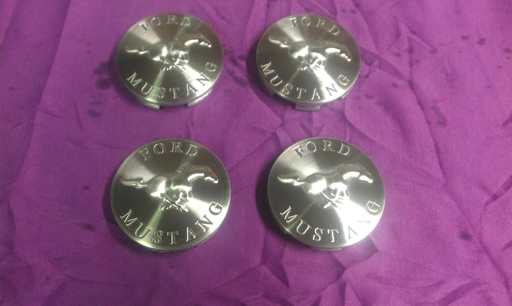

    Nice project.!! . . . . got suckerd into a emergency project other night which you may like being a Car Man.!! . . .Somebody nicked my mates wheeel Centres and he was off to a show at weekend.!

    Thanks Dean,
    Those centres are lovely - giving me ideas now as my jag centres are a bit jaded.
