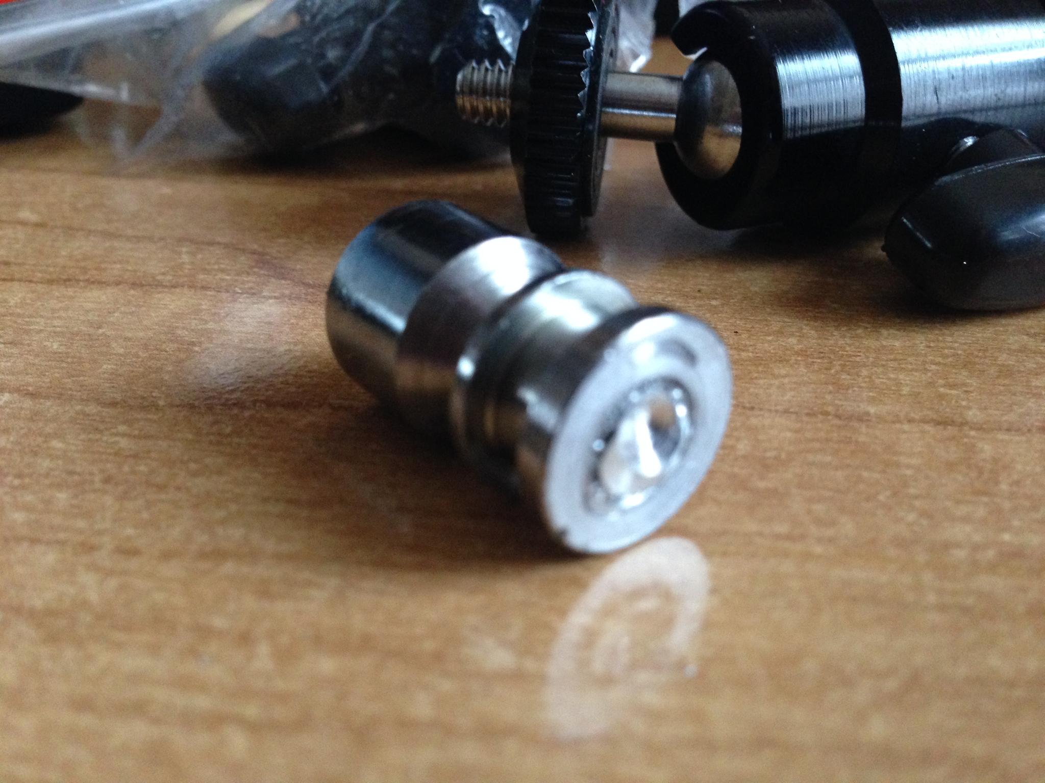

    I've got three bits that I need to make compatible with a screw mounting. My original plan was to drill and tap, but the little buggers are perfectly round and defeating my ability to hold them straight. Plus I think I've just killed the plastic gears in the mill.
    Is there somebody in (or near) Derby who might be able to drill & tap these... tonight?
    Like I said, a bit of a long shot :(

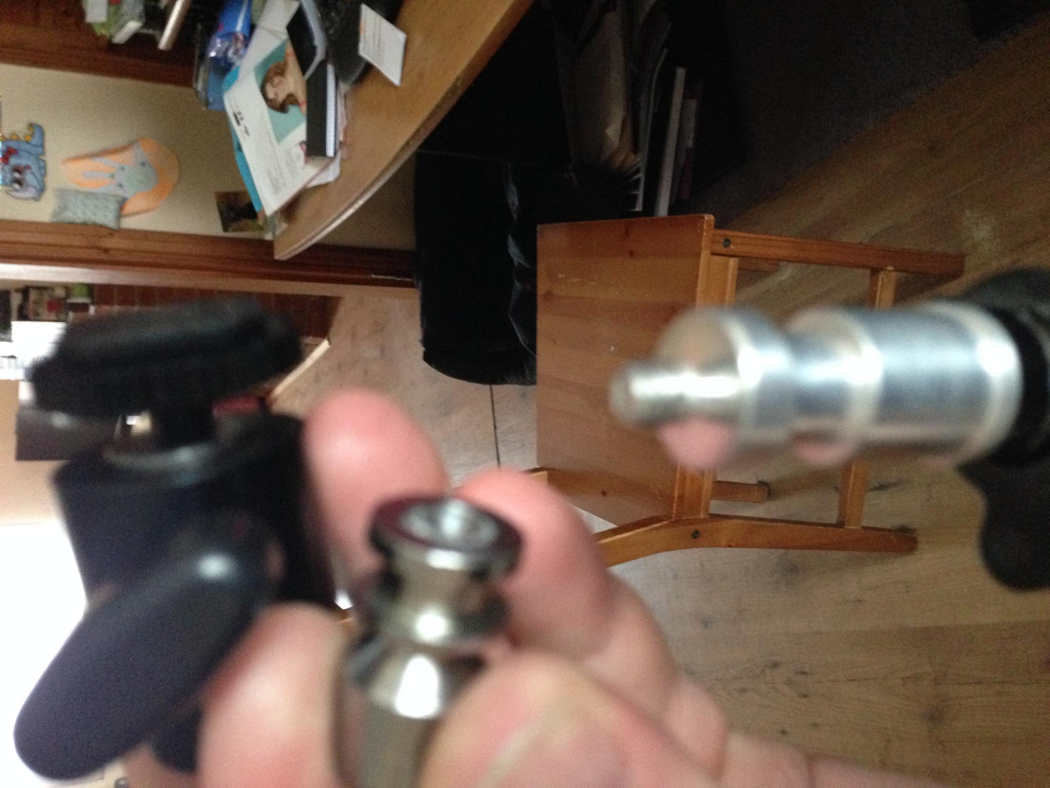

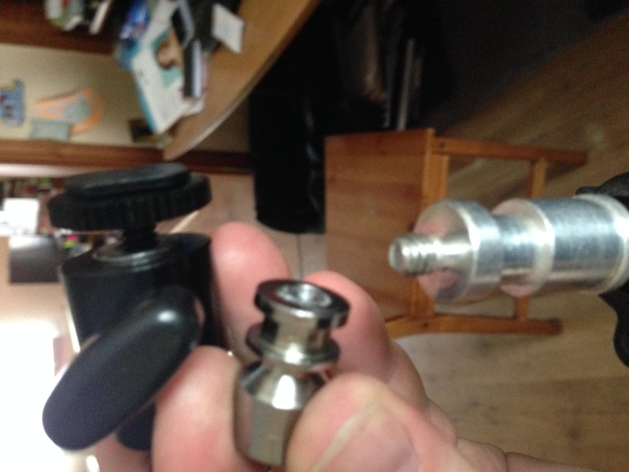

    The bit comes from a flexible ball-joint for a lighting stand (the black thing on the left in the second photo). Inside is a the round bit that I need to drill & tap (the first photo, also in the middle of the second photo). It needs to fit the thread on the stand (the light silver bit on the right of the second photo).

    Chuck the part facing down in the mill and put the centre drill facing up in the vice?
    You can also do some small basic turning in a mill with a tool held in a vice ;-)
    - Nick
    Now that's worth a punt. I'm in the process of buying a few days but might well end up trying that!
