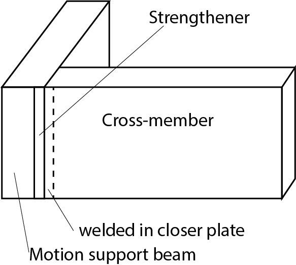

    Steel came Friday, nice and straight and after a few stress tests (me standing in the middle of a 7m long beam) I realised just how rigid this stuff is
    Construction question:
    I was thinking of welding on some 100x50x10mm pads under each corner of the motion frame and similar to the top of each leg, then bolting the two parts (welded motion frame/bed and welded leg assembly) together, just to give the opportunity to shim out any variation in leg length etc. Good idea, bad or not worth it???
    Next, the bed/motion frame - should I attempt to weld it up as one piece, or weld closing plates flush into the ends of the cross-members, drill/tap and then bolt together?? If yes then how to weld the closer plates in - only way i can think is to heavily bevel the plates then insert and fill bevel with weld tying into the tube sides??? Plates would be 46x76x10mm.
