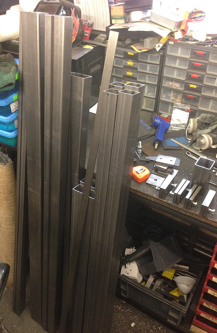

    Got the metal cut today...
    Ends squared up and deburred, also cut,drilled and tapped the mount plates for the motion frame and the insert plates for the cross-beams. All ready for a welding session now.
    I'm fitting castors and screw-down feet so I can move it about and level it up when assembled.
