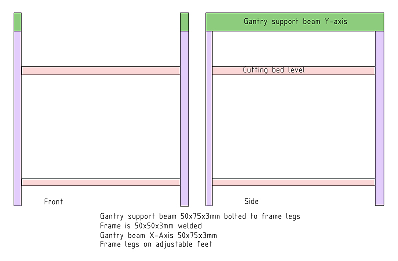

    The gantry is looking like 50x75x3mm steel, with a strengthening strip inside where the rail and rack screws on.
    Aluminium was looked at, and is lighter, but stiffness suffers as a result and I want it rigid this time ;)
    Frame bracing???
    First frame idea, overall size is around 1500mm x 1500mm x 1000mm to bed level.
    Should i be looking at bracing or gussets anywhere???

    View from front looking at current gantry design.
    This is for the open-bed style table with the longer gantry arms. The linear guides can be easily covered from the top.
    The gantry beam will pass through the side support plates and be welded up and gusseted inside with some nicely cut parts, the outer face of the vertical supports can be strengthened with a couple of ribs to resist side-sway.
    Mounting the support rails is harder on the open bed style though, I was going to bolt them on but this style really wants a box frame at bed level.

    Every action has an equal and opposite reaction. If you apply 300N accelerating force to the cutting head, the gantry will push sideways with 300N.
    Yes I can remember that from school ;)
    But those 300N can be countered by applying gusset plates and ribs where needed, most tend to throw a slab of alu at it but that might not be totally needed i think.
