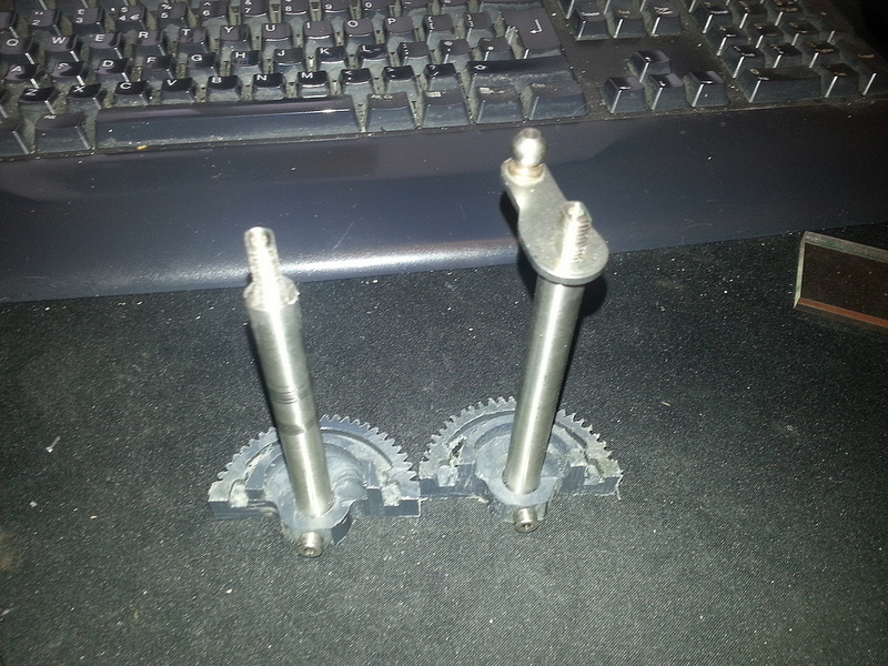

    The first is cutting of 2 gears, in brass or plastic. I have previously milled these from the 'top down' but had issues getting 100% centre when the one gear was flipped over. I believe now the better way to do that is to make 2 parts and join them together. A lathe is probably better to make the 'blank' and then use something to cut the gear slot. I dont know if these gears are custom or not. I have measured them and cannot find a module number they comply too. Some pics should be attached.

    I'm also sure that for these gears, a lathe will be needed, I dont want to try and find a compromise machine but certainly something that can 'turn' a material and mill will be ideal. I could do blanks on a mill and then look at options for cutting the gear.
