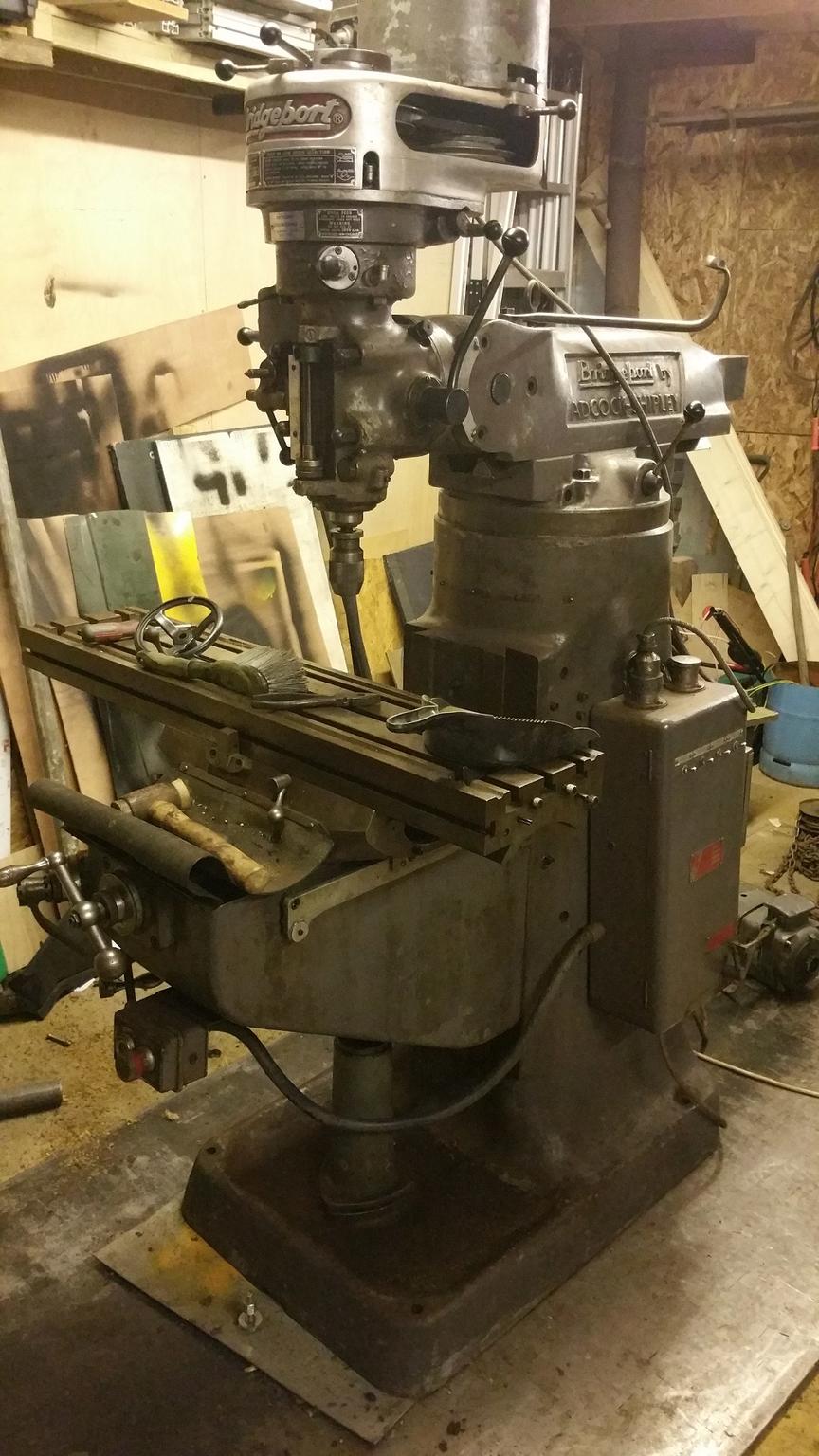

    new toy!. another freebie.. albeit moving it involved beer tokens for literally all the blokes I know.
    but its at home now... I also have the "shaper" attachment for the back.
    Id like to convert it to CNC ??? thoughts? which I guess will involve ballscrew conversion, maybe servos? If anybody can advise me of any threads showing cnc conversion Id be appreciative.
    Likewise if anybody can offer any advise, on how Im going to get it working... (its three phase).. although I hear the "pancake motor" can be run off a vfd...

    I'd advise 'getting to know it' as a manual machine first. Assuming it's in a working mode - X screw looks like it might be missing? That way when you convert it to CNC you'll have a much better idea of what settings (feedrates etc) to use and will likely break less as a result.
    The tricky one is converting the knee (Z) to CNC. I spy a rotating nut...
    Find the nameplate on the motor and see what the ratings are - i.e. voltage and power. Or just post a picture of the nameplate here.

    X leadscrew is present. just not fitted. I removed it for transportation
    Don't have a thread but can help. I converted my KRV 2000 to CNC not to long ago. I reused as much of the leadscrew mounting bits as I could and it went quickly.
    You have an older bridgeport model that does not have central oiling and that is one thing I would consider essential for the health of the ballscrews at least.
    My first suggestion is think of a budget of at least £1500-2000 for the conversion if you want a professional quality machine.
    The donut motors should run fine on the inverter (VFD) if you get one that is rated to the HP of the motor.

    I think I have read that some people motor the quill and leave the knee. I can see that this will become an interesting thread.
