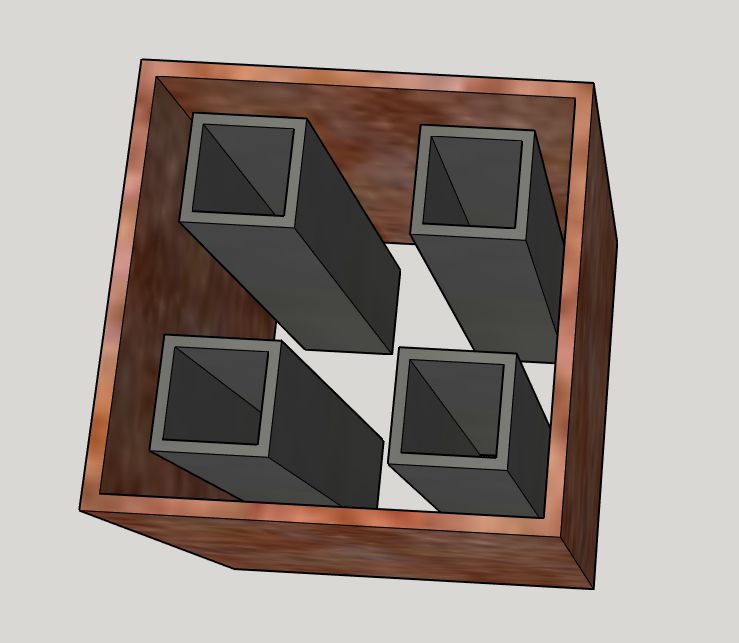

    Because I need some steel anyway before I start my cnc build, and because I know that I will end up using epoxy levelling for my rail mountings I think some testing is in order.
    I will buy a bit of 80mm square steel, some pond liner, adhesive, reinforcement etc, and do some comparative tests. Deflection is easy, vibration can be done on a smartphone with a seismometer app, weight, easy, cost easy.
    This is a beam design I have being considering. In terms of machining and CLD, it was first done in the 1960's but still crops up in the 2000's as the optimal design.
    Bare metal beam VS sand filled beam VS reinforced CLD/EG beam. I'll post the results and go from there.
    Any other tests I can do with peasant level equipment and any advice in setting up a fair test?

    Quote Originally Posted by D.C. View Post
    Boyan - You are right about the channel section strength but in Britain steel costs a lot than in Spain. There is also the problem that when you hit a piece of steel with a hammer it rings like a bell. That sound is massive shockwaves travelling through the material and forcing air out of the way as it flexes. The 'perfect' cnc machine would be completely silent, there would be zero vibrations that you could introduce into it that would result in a measurable distortion.
    You have got it wrong here. If it was a sheet or just box section profile, yes, its like you say. But not in that case. As it happens that i make various musical instruments and trying to make some from steel, all my designs of machines are made so that sound is canceled/ no vibration.
    I am telling you here not abstract theory. I have already mounted that UPN 140 profiles and definitely there is no vibration. As the C form is doing just that-cancelling vibrations. There is no ringing whatsoever.
    I am sure in UK also the UPN 140 is the cheapest way to go compared to all other variants. Just check a supplier, not local welder. Cause for example if i go to a welder he would sell it to me for 2-3eur kg instead of 1euro kg . Just cause he cut it. hense the Rage saw you see on the pictures of my build. It payed on the first machine i made. Just from ordering directly the 6m material. The funny thing is that the supplier transport of a whole truck of steel costs only 10 euro.
    You could fill that C at the back with cement and here you have a winner. Dont over complicate things. Its right here in front of me, tested, super rigid, cheap and does not ring. What more?

    There are a few concepts and definitions in this thread that in my mind make the discussion a bit clouded, as it often does when it comes up.
    Hope I can point all of it out, here it goes.
    First and foremost, a cnc machine needs to be stiff (rigid). Everything else comes second.
    It can be good if things are strong but it is very hard to build a machine that is stiff but not strong enough.
    Then people often say it needs "dampening" and/or "weight" and then go on using either in the wrong way, in real life and in conversations.
    If you add bitumen within the construction you will add "dampening" to the structure. It will make any vibrations die out quicker.
    But there is a big risk if you add bitumen or similar within the construction.
    Chances are you will reduce stiffness.
    I am unsure if adding bitumen to a cnc construction is totally useless but I am sure it is extremely hard to do it so that it does dampen vibration without compromising stiffness.
    If you add sand to a gantry you will also add dampening but as described above would be missing a great opportunity.
    Pouring loose sand in a construction will indeed reduce vibration, in that it helps vibrations to die out.
    However, if you add sand with epoxy mixed in, it will become part of the structure, adding stiffness and at the same time adding dynamic stability to the construction, making the amplitude (size) of the vibrations smaller, giving a better finish to the product.
