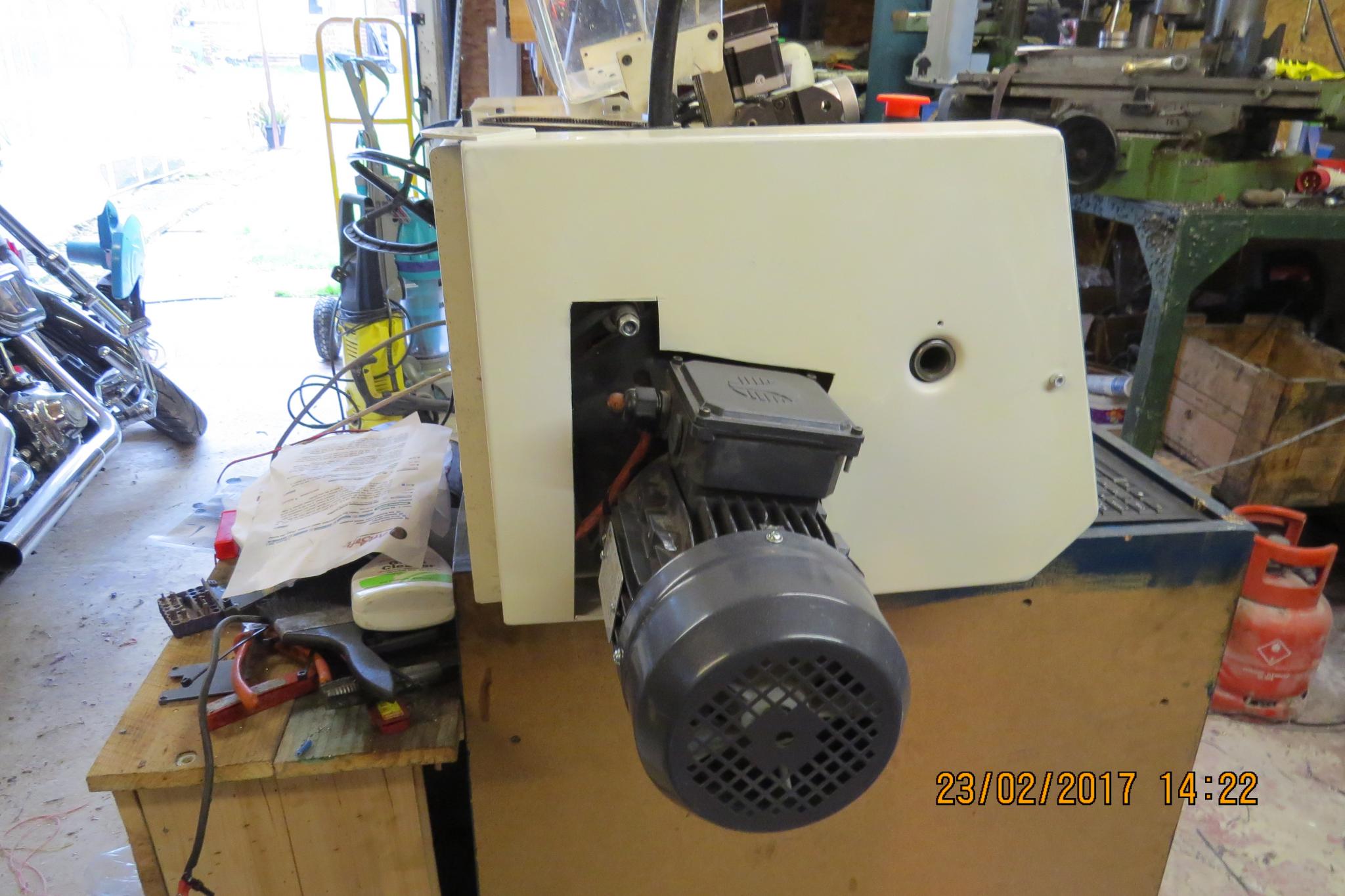

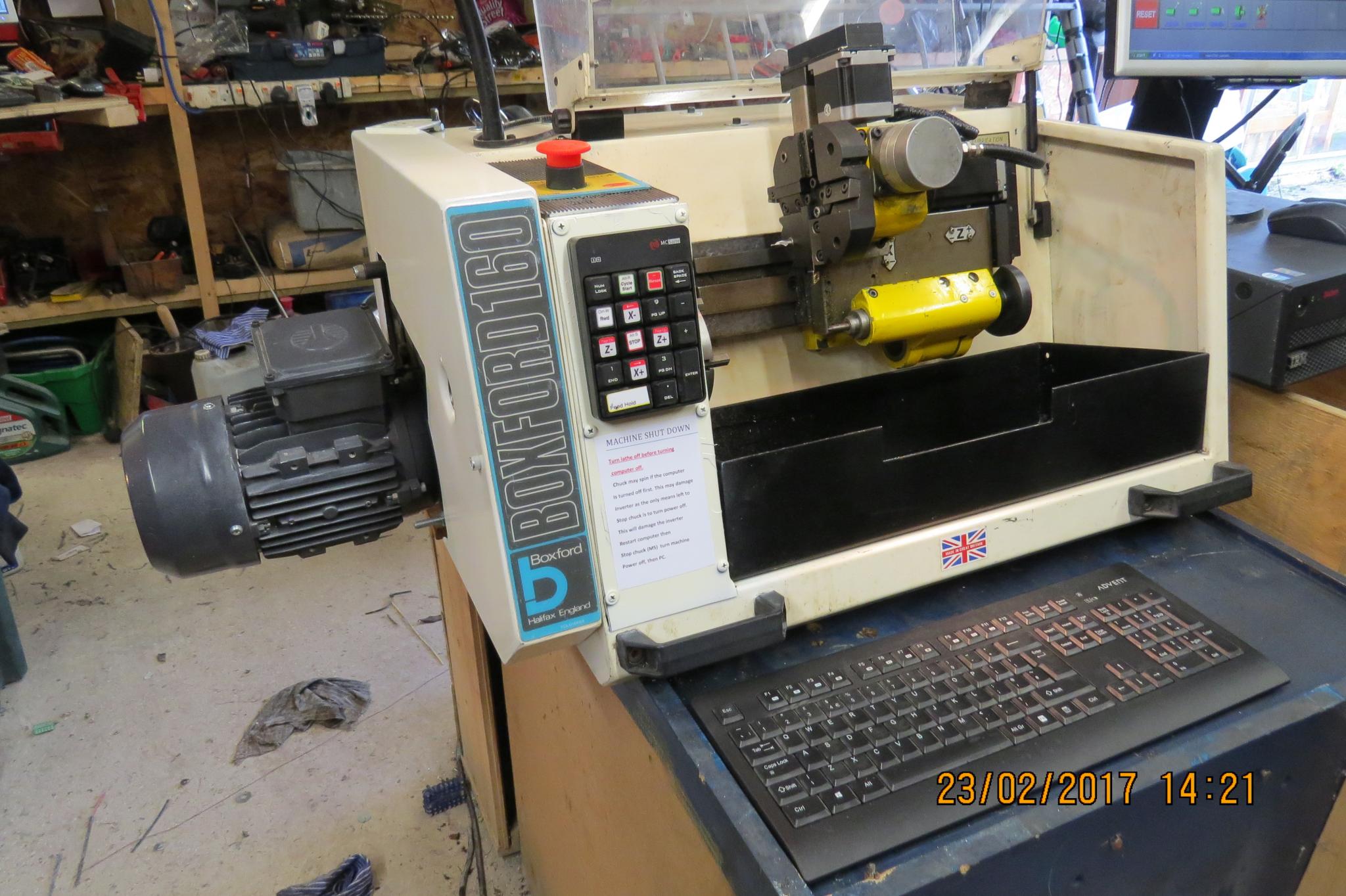

    I am currently bringing to life my boxford lathe and going to put in a Yaskawa J1000 VFD now I am looking for a dual voltage motor but don't want to spend much... I am from Yorkshire by the way so not too expensive
    That was a long time ago . I replaced the motor with a flange mounted 3 phase 1.5 kw motor mounted on the rear of the cabinet. I then fitted the VFD inside the cabinet. The motor drove only one pulley and had enough power to do all speeds necessary. I have since done 4 like this and all sold no problem .Works much better than Boxford's effort.
    Did you manufacture the mounting yourself?
  9. #8
    I modified the motor mount from the machine . I fitted spacers to fit the motor and fit the pully to the motor shaft . The spacers push the motor out so the pully lines up. the motor pully guard is cut to cover the new motor that is now on the outside of the machine . Sounds a bodge but it looks and works quite well . I use TEC 2.2 KW 3 Phase 2 pole Motor 230/400V 50HZ Foot Mount 3 phase B14 mount. got the motor slightly wrong in last post.
