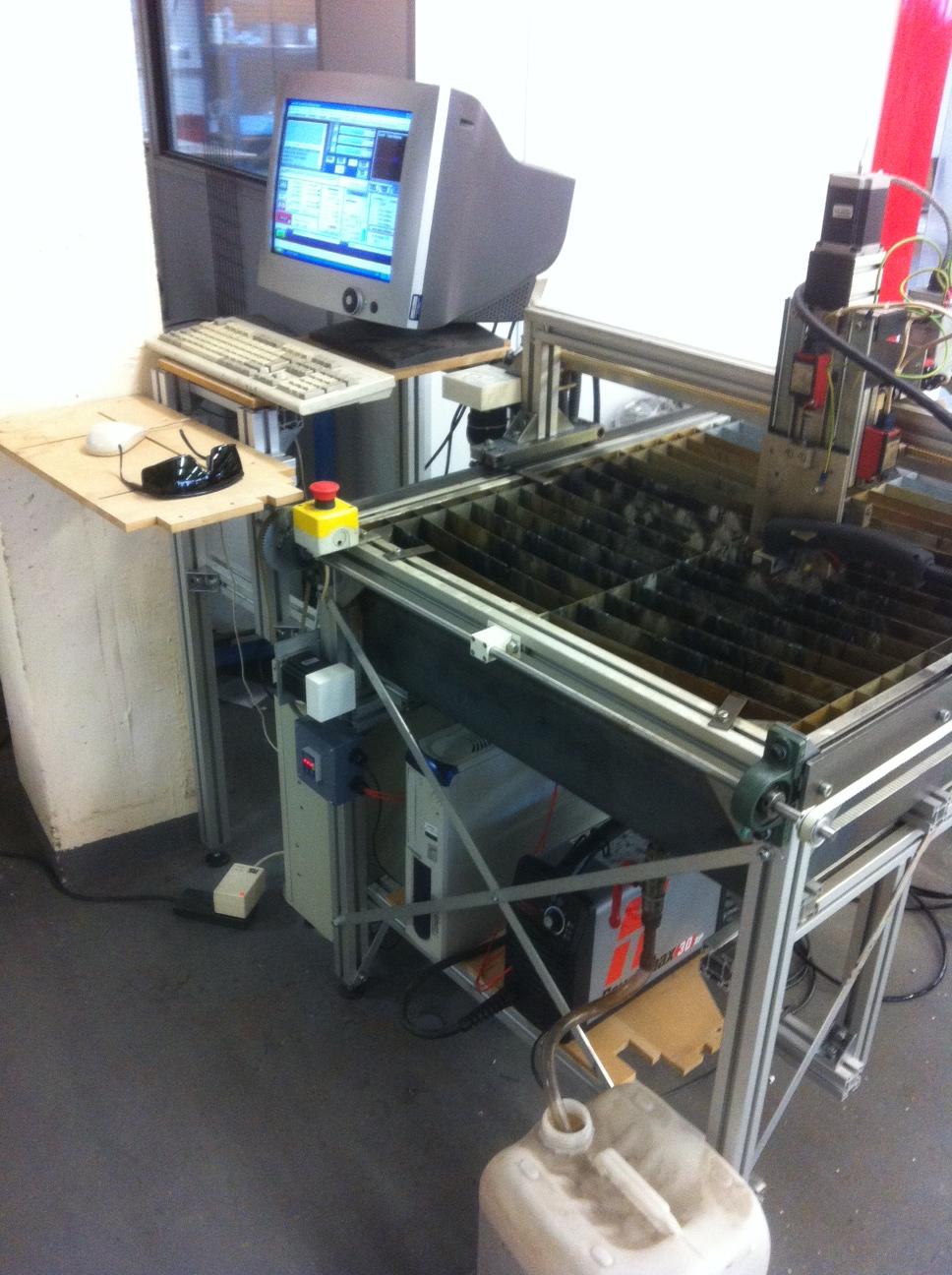

    Have you any pictures of your own machines?
    Gav,
    This is my first build - it was an educational exercise that got pressed into mini-production It worked really well on my Powermax 30XP but that was a hand system and difficult to use on CNC, I then upgraded to a PM45 and now the table cannot go fast enough !
    I am now building a new, bigger table to match the PM45.

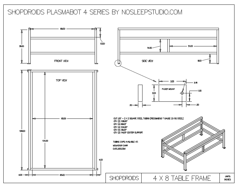

    silyavski I was thinking of something like the image at the end of your quote build my table first use it if I need to then progress to cnc it asap. I'm new to this whole scene but I willing to try anything as long as I'm learning from it and it has something to do with my industry.
    I'm thinking of a bench approx 12'6 x 6'6 so I can sit a 12x6 sheet onto it with finger or hook room. Might even place it in a room 20x8 ish with a little overhead gantry to keep it all tidy away.
    The table will probably be 75x75x5 square tube and 50x50x5 square tube with a water tray similar to this.
    And the left/right sides will probably be the 140x140x6mm at least. What will I make the gantry out of?

    Quote Originally Posted by F1transportationserv View Post
    Hang on a mo', stop drawing and start thinking...
    You have to support the slats that support the work piece and you have to support them through the water bed. I don't see slat support. A water table 5' x 8' is 40 square feet so every inch depth weighs slightly over 200 lbs. You have to support that to, add some triangles perhaps.
    When you weld this thing up it is going to bend. Suggest you do not weld the gantry supports because you will only end up trying to correct the misalignment with a THC. Best if you correct misalignment with screw adjustment or, let the gantry assembly rest on the table so it conforms.
    More if you want it...
