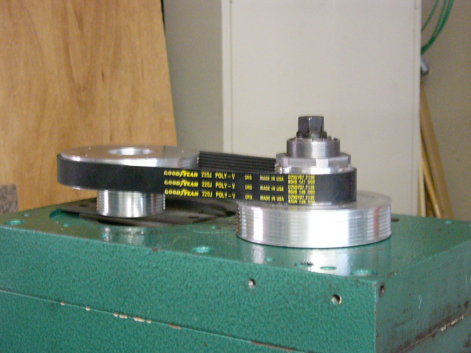

    I have a RF-45 clone and I want to convert it to belt drive. I have been on the lookout for these multi ribbed belts and pulleys (Poly-v, micro-v, serpentine), but I can't really find an online dealer here in europe.
    Can anyone guide me to a place where I can buy this?
    PS: Any experience with ordinary V-belt or timing belt, if nothing else is available?

    Yes, that is the right belt, but I'm unable to find any matching pulleys.
    Brian
    These are used in washing machines if that helps. Machining 4 custom pulleys seems a reasonable solution.
