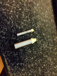

    Hi Matt, below are just two examples of the same problem you have. I even tried to go with 6mm with a 1/2" shank and that broke just as easy and trust me these on the photo were not the only two I broke:-) I even managed to break a quite expensive WP 1/4" x 1/2 shank cutter, it lasted a longer but not much. Unless I ran these 6mm straight flute cutters with air blast, at low feed and shallow depth of cut they broke long before they get remotely blunt. They break while slotting straight or curved sections and never broke during a plunge or ramp-in. If I want to break a brand new one within 10 seconds I just cut some of those dark brown HD fibre board at the feed/speed/DOC you mentioned above. Gmmf, they die so gracefully, no real nasty sounds, nothing gets flung across the workshop, the spindle just leaves half the cutter behind in the slot... :-)
