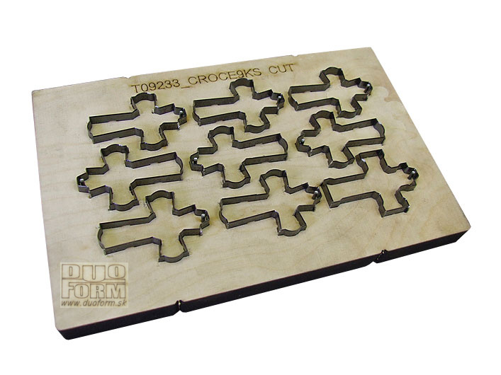

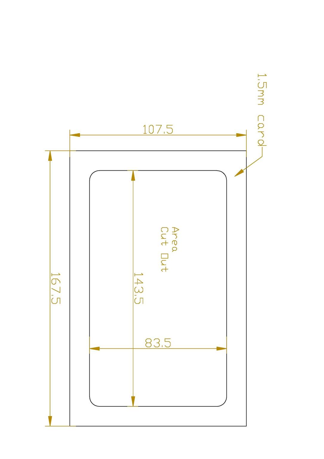

    I'm wondering if someone has advice to lend about how to make a 'die' for cutting 1.4mm 'mountboard'? I need to produce the part below. Mountboard is a paper-pulp board usually for mounting pictures for display. I imagine it can be cut in much the same way as cardboard which is with a 'press' and a cutting die. Can one buy sharp edged metal strip to be formed into the desired die?

    Thats a standard cutting form within the print industry
    if you are just wanting the one making I would find a cutting form maker and let them make it
    I have customers who make their own simple ones with a fret saw and hand bending the cutting blade into the cut
    if you want a bit of blade to try to make your own let me know..
    How are you going to use the form once you have it?
    Ian
    I was thinking of making one myself. I imagine a couple of thick plywood boards, one holding the cutting blade and then pressing them together with the material between. A screw in each corner would allow me to get the required pressure. That's my idea anyway.
    I can cut the board with a slot for blade on my mill, but the thinnest bit I have is 3mm. How thick is standard cutting blade?
    If my plan sounds sensible I'd love to get some cutting blade from you!
    How does one normally form and fix the blade into the press board? Just bend by hand with pliers and fix with epoxy?
    Thanks,
    Simon

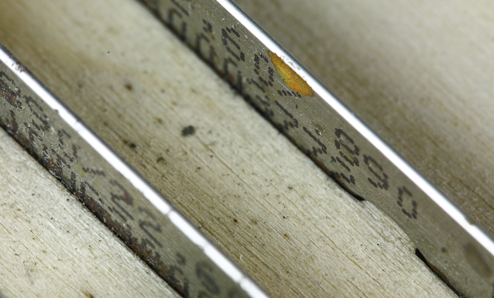

    The cutting rule is about .5mm thick
    creasing rule is thicker
    the rule is just pressed into place
    dont underestimate the pressure you will need to cut even one sheet of paper with a form like this
    presses to do such a thing are very heavy and exert mega pressure
    and are precision things
    one way of doing it is to place the form on a base board then place the board that you want to cut on top and then run a roller over the board
    forms are made to 0.918" high
    the roller needs to run at that height over the form
    you place bits of foam rubber next to the blade to push the cut edges away from the blade
    I think your idea of 2 boards with screws is possible for such a simple form but very slow...how many cuts do you want to make?

    I need to cut about 100 pieces. I was thinking of putting 4 shapes on one press. Perhaps that is too ambitious if you say it needs loads of pressure. Still I can experiment. The roller is a good idea.
    How do you usually cut the form with a slot only 0.5mm thick? Do you use a mill? When yo say the blade is pressed into place I guess you mean into a grove pre-cut to shape.
    I was thinking of something like this press, which I use for veneering A4 size panels.
    Commercially they are done with a laser but one off simple ones with a large fret saw
    you will never get enough pressure with that press to cut 4 at once in the middle
    you may do 1 if the bolts are close to the cutter
    Quote Originally Posted by IanParkin View Post
    It's starting to sound like I will get the job done faster by just sticking the sheet on my mill. Thanks for all your information!

    I got these from a customer today
    a piece of cutting rule
    and a card shaped form
    if you want them let me know and i'll put them in the post for you to experiment with
