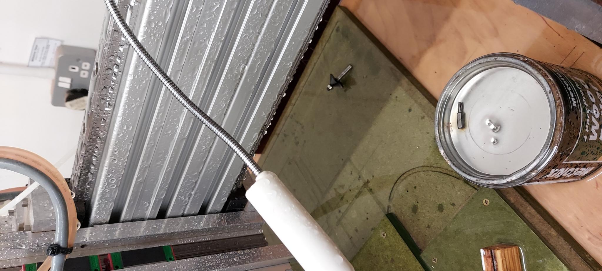

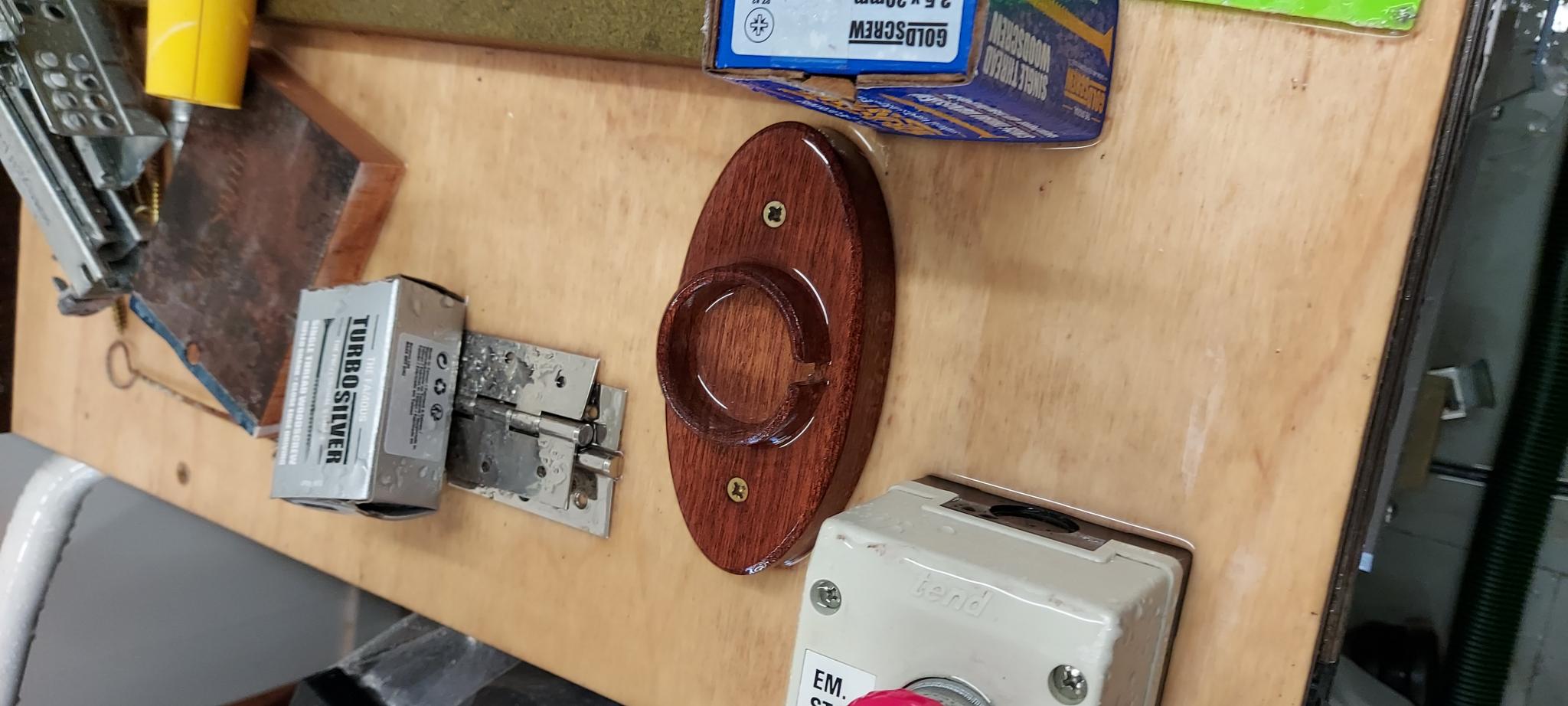

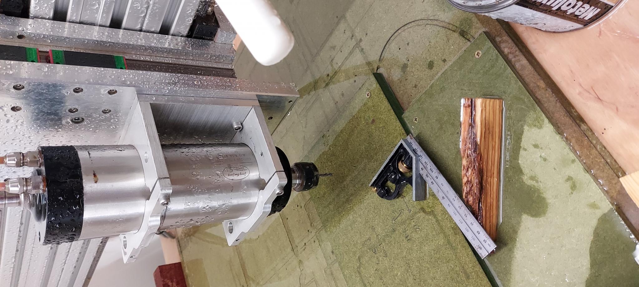

    However I discovered yesterday that i have had a burst pipe in my workshop upstairs which has of course made its way through to the downstairs...
    Hence this !

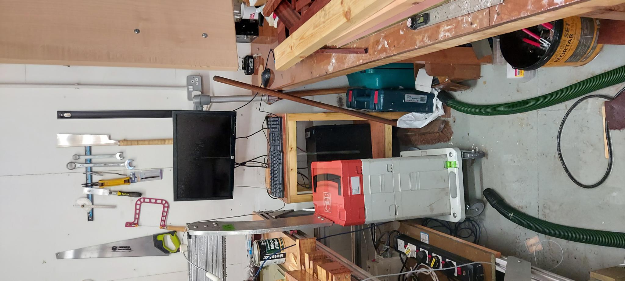

    Excuse the general disatrous shape of the workshop I had just abandonned ship and then started moving stuff when I discovered the flood.

    It could have been leaking for a few days, the guy in the next unit called to tell me because it was going into his side otherwise I wouldn`t have noticed till today.
    So, of course, there is going to need to be a bit of a rebuild situation to say the least.
    The top is bending like a banana, I have no idea if any of the electronics or the PC will work though some bits have escaped full monsoon (drying the PC out in front of the fire right now).

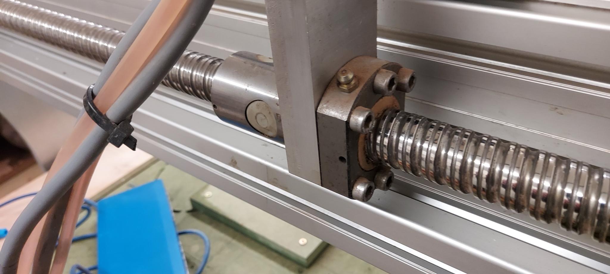

    Firstly, I have two noisy bearings and so will replace the bk/bf blocks, the ballscrews are 25mm but turned down to 15mm at the fixed end and 15mm ( threaded part ) then 12m by the coupler. So it looks like I need BK15 and BF15 blocks, is this correct ?

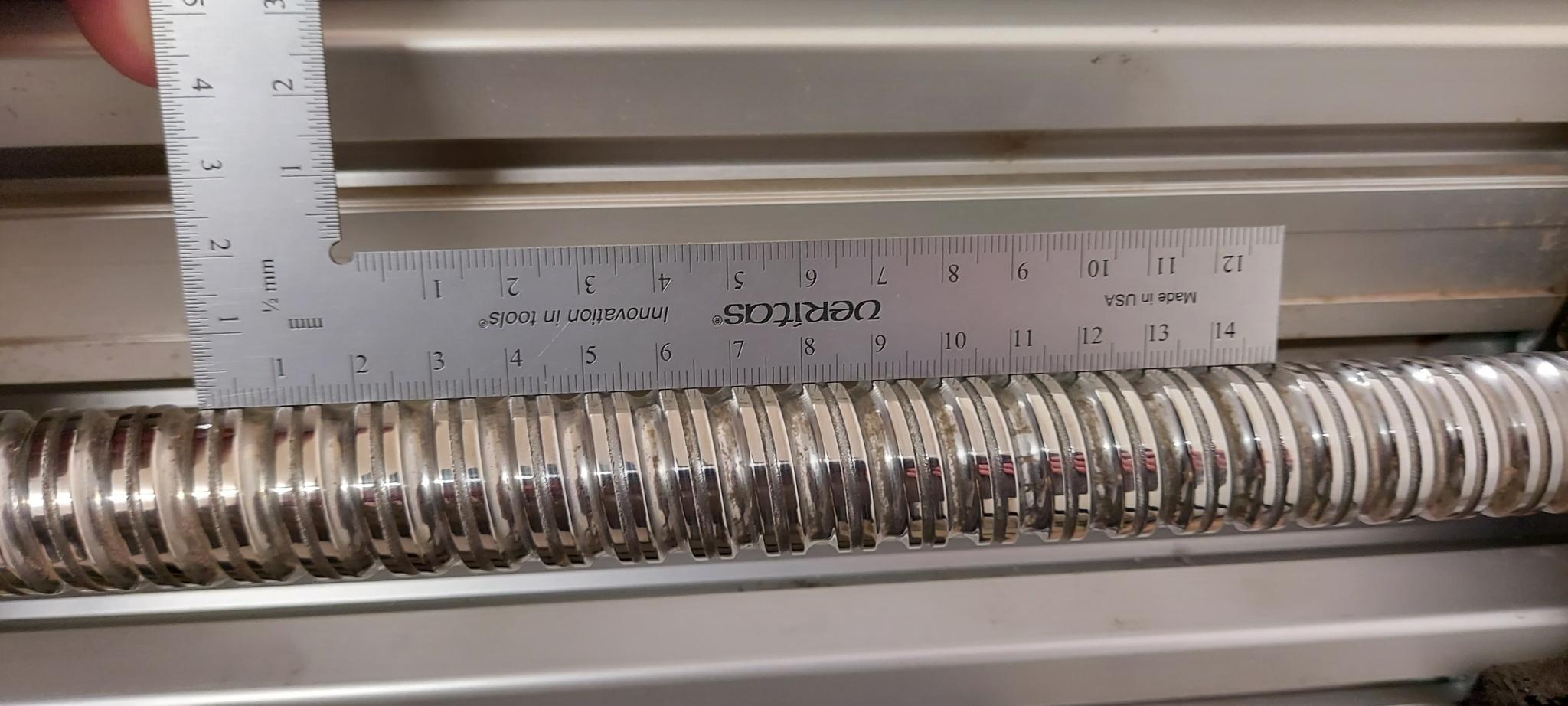

    While I was looking at it I thought maybe replace the ballnut as I have to take it apart quite a bit anyway but I can see no markings at all on the part and I wonder how to make sure to get the right ones regarding pitch etc.
    This is it

    I put a ruler on it but not sure exactly where to measure to and from.
    Yes that's correct, 15mm is the ID of the bearing and usually with M15 x 1 thread with coupler portion being 12mm OD.
    Any ideas ?
    First putting a ruler against alone won't always tell you the pitch because it could be a multistart thread. So for instance while the distance between threads is say 5mm which is what yours looks like, there could be 2 starts (threads) so this is double making it 10mm pitch. If you look at the end you'll see if there are two separate threads.
    Now if you didn't have any backlash then I wouldn't go trying to swap the nut for a different one because if it's a Chinese ballscrew, which it looks like it is, then you might struggle to find one that matches and end up with more backlash.
    If it's not worn then I would just strip it, clean and re-grease, if it's got a little backlash you could try fitting new balls or a couple of oversize balls to preload it a little.

    Good to know that I measured the ends of the ballscrews right at least.
    With the ballnuts, I don`t think I have actually been having any problems with backlash and I am pretty sure the clicky noise is coming from the BK blocks particularly on the Y axis. I am only butchering wood with it at the moment.
    So perhaps I will leave them alone, I was just thinking of doing it because I will be doing the ends anyway. I have a vison of loosing many tiny ballbearings over the floor if I try to dismantle them.
    In that case, then leave them alone and just grease the nut.
    However, if you do decide to remove the ball-nut don't just unwind it from the screw otherwise you will dump the balls all over the floor. The correct way is to make a tube or mandrel the same size as the screw base thread and wind the nut onto this. Then you can take this to a large tray and remove the mandrel letting the balls fall into the tray. Then you do the same in reverse, re-build the nut onto the mandrel and re-fit the nut onto the screw by winding it off the mandrel.
