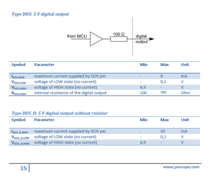

    24vdc 150W, but it seems its irrelevant for the outputs
    seems it was never meant to do that, look bellow at specs from pdf. I wonder why sb will do such nice board, but that could not power an input of a bloody relay

    I read that Boyan but it seem to indicate you can take out the 100R and then get 50mA what do you think. ..Clive
    i read somewhere that the relays need more than that, ~80-100mA so at the end i bought the extra boards.
    i wish sb simplified the stuff and said- " you need that board and that relay board or output board, cause otherwise you will not be able to do this and that " cause for me 50mA is like chinese.

    I think a lot of small relays will switch at about 15mA https://www.sparkfun.com/products/100 or even less
    Without a diagram of your particular situation, all we have to go on is this....
    Hi, how do i deal when a board / Pokeys57CNC does not output enough current on output 5v pins to switch a external relay / 8 channel relay board 5vdc /??
    If you get a multi-meter & see what the resistance is between the Pokeys57CNC 0V rail & the relay board's 0V rail ....if it's high resistance , then there's no common path (& therefore this is why your relay's aren't switching).... you will need to link the 0Vs on both boards together. Voltage is always 'with reference to another point' ...i.e. the 5V on your Pokeys57CNC is in reference to the Pokeys57CNC 0V, the 5V on your relay board is in reference to your relay board's 0V...the only way you can make the 5V on your Pokeys57CNC mean anything to your relay board is to commonize the 0V rails on both boards....join them together.
