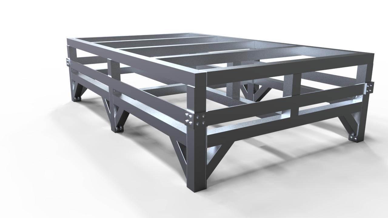

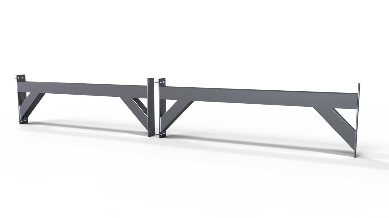

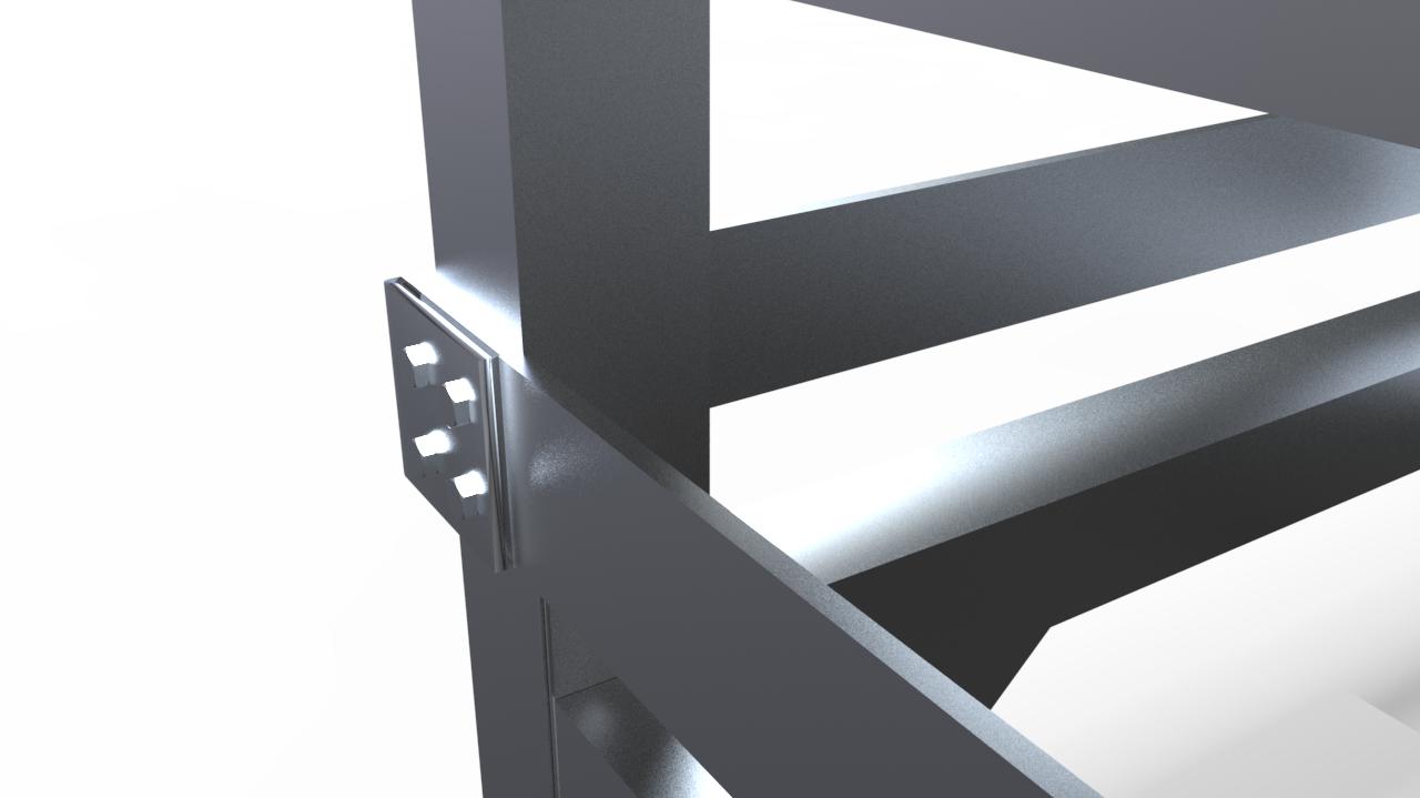

    think this maybe my final design on the frame, what do you think?
    cheers
    ash
Name:	bed frame 4.1.jpg
ID:	15928   Click image for larger version.
Name:	bed frame 4.2.jpg
ID:	15929   Click image for larger version.
Name:	bed frame 4.jpg
  10. #20
    I would suggest you don't need the flat bar as it's not likely to add anything, where you've got the angled sections on the "feet/legs" of the frame, move those up into the rectangular spaces or add some there, they will serve you much better.
