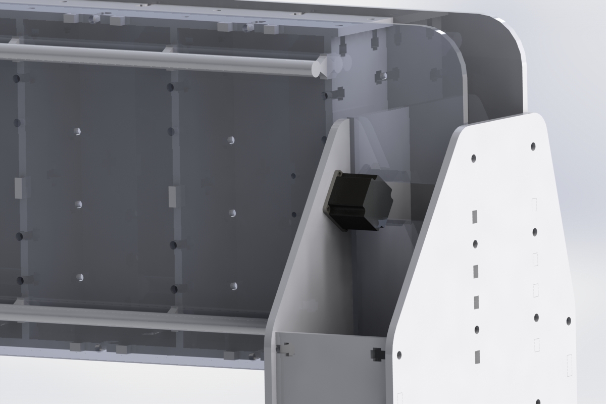

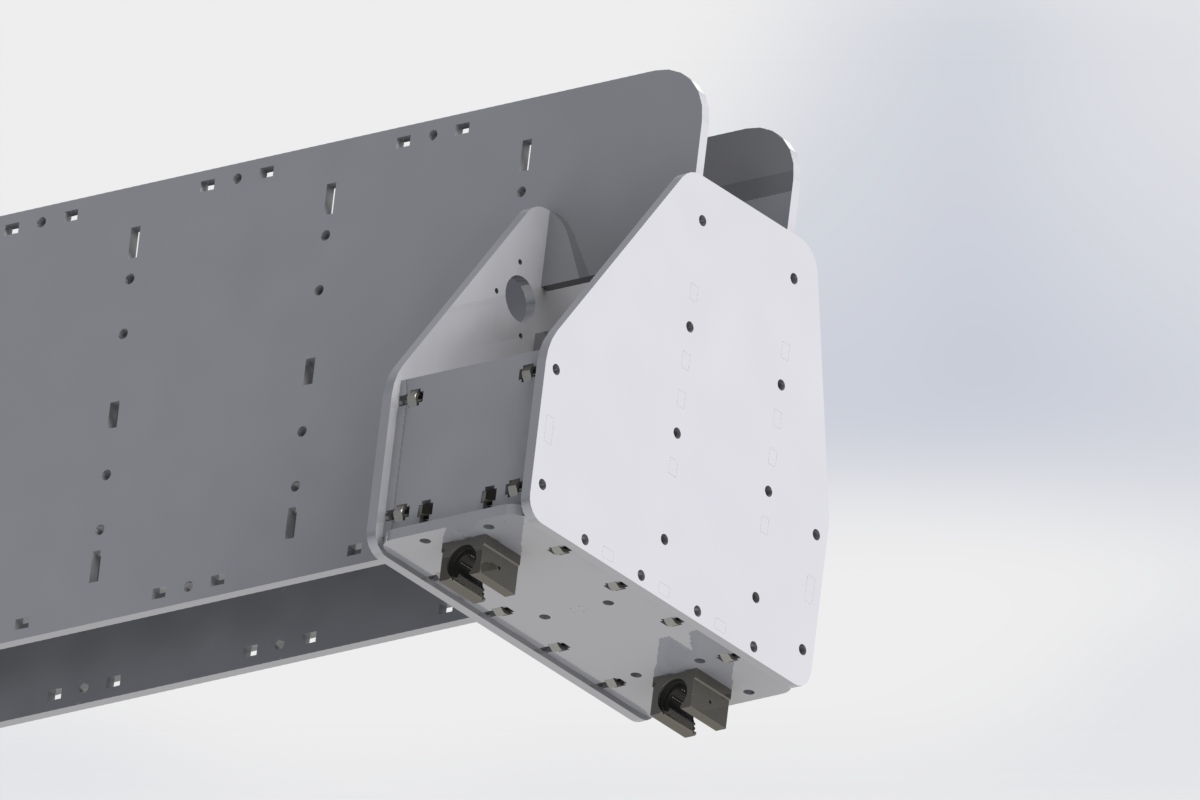

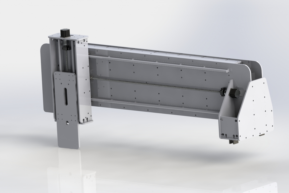

    Alright, moving forward with the assembled and complete gantry (Y axis, Z axis and gantry sides). I still need to mirror the right gantry side but that's a detail compared to the amount of hours I put into making the sides and assembling everything. Solidworks can be a pain sometimes, and the 2GB RAM of my good old HP laptop are starting to struggle a bit.
    Gantry weight is calculated to 39 kg without the second gantry side (@toomast: this is strange, but I've checked again that parts were set to the correct material, may be I can PM you the model and you can check if I have done something wrong ?). The Y axis is securely fastened to the gantry sides and contributes quite a lot to its rigidity.
    Assembled gantry with sides and Z.
    Gantry side with motor mounted on left side plate. Notice the extruded cut in the Y axis front plate to make room for the motor.
    Gantry side. Y axis is fixed at 14 points. Weirdly, I had rendered this with fasteners showing, but they did not appear on the render.
    General remarks:

  2. #32
    i don't want to discourage you but as i have some experience doing similar assemblies from laser cut parts:
    -going from square to round rails is a very bad idea at that point. Why waste effort and money then to make all that rigid structure. If you go with round rails then make a simpler square profile structure, no need to make that laser cut monster
    - BST automation at aliexpress , Fred is a very good seller, he could do all that stuff, machining screws, send 3m well packed ball screws, lower value, etc. tell him Boyan sends you, he gives me best prices compared to ebay and aliexpress, furthermore you could order all from him, including VFD ans spindle, he has more than he lists, just email him, no problem with errors or warranties
    -the way you fix your motor and ball screw, that moves the Z left right, take care to be able to adjust that
    -as i made some similar stuff i am telling you you will need at least 12 heavy duty clamps to be able to straighten all and solder. plus a big plastic hammer at least, i would say you will need a press. see what i did here for the Z #155 and imagine at your scale of things how difficult that will be in reality if plate is not straight after cutting

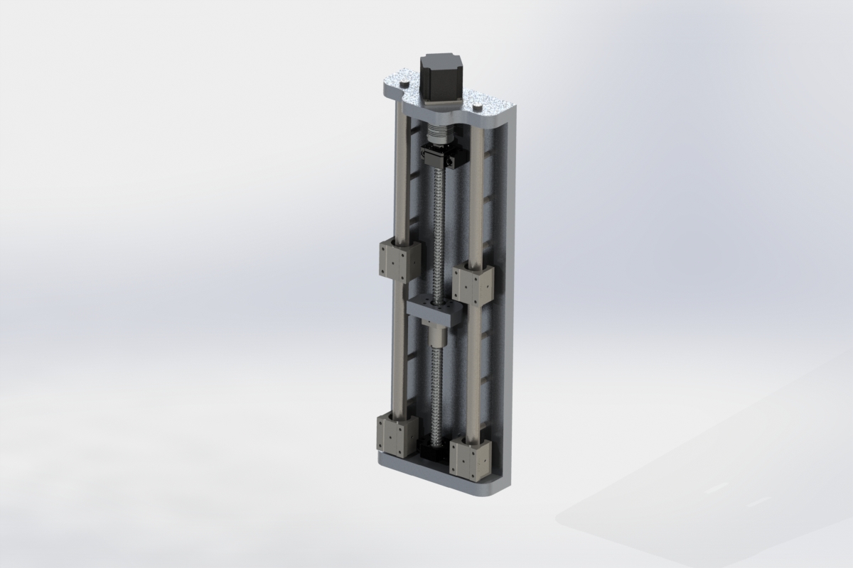

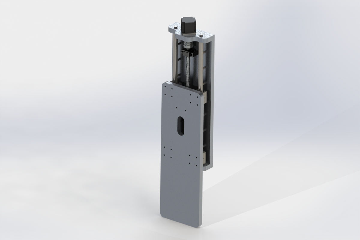

    Important updates:
    Following Boyan's advice, I am switching to a new Z / Y / gantry design, adapting my old one, removing nuts and bolts. I am also switching to ALUMINIUM instead of steel, as this thing is way too heavy. The new design lightens it but going to aluminium will be the solution. I'll be using 20mm sheets, unless you guys think 15mm is better to reduce weight. I'll be adding pockets at some places to lighten the whole thing.
    I called the cutting company. They said parts will be water jet cut (I have no choice on that, but no big deal, I've got good prices anyway) with .25mm accuracy.
    I keep the round rods, no changes on that. Instead of being supported by profiles, they will be supported by M8 bolts every 70mm plus at both ends.
    Here are the pictures of the Z axis, evaluated to 17kg, but that should decrease with pocketing.
    Complete Z.
    Z without front plate.
    Cheers.

  8. #38
    Quote Originally Posted by eurikain View Post
    Important updates:
    Following Boyan's advice, I am switching to a new Z / Y / gantry design....
    What are you doing right now is Not following my advice. Of course its your machine, i am just trying to help. Seems you a missing my biggest point. What i told you before:
    Keep the design with square rails! Save from all else. Dont compromise on that. Dont exchange that for a vacation
    Ok i understand - expensive, you want to change the design to round rails. Then read some similar build logs and design much lighter and simpler frame.
    Here is my advice:
    -make the Z strong. 20mm aluminum plate is Not strong enough if not braced. Ideal will be 12-15mm steel plate, braced and done like#8 here where i explain much better and simpler Z design with the same effort
    -make gantry from profiles cut on a Rage saw and soldered. gantry sides also. Look my second project in signature for the gantry sides / 100x100 profile/ Design all machine from one profile, say 80x80x4mm or 100x100x3mm , no fancy plates and crap where you waste money. Order 6m steel box profiles, cut all on Rage saw and solder.
    From here you will save the money for the square rails. Difference between square rails and other type of linear movement is like from Ferrari compared to Trabant
    -My direct advice is follow my first build and change gantry sides like i did them on my second. Thats the cheapest and strongest machine at the same time possible.
