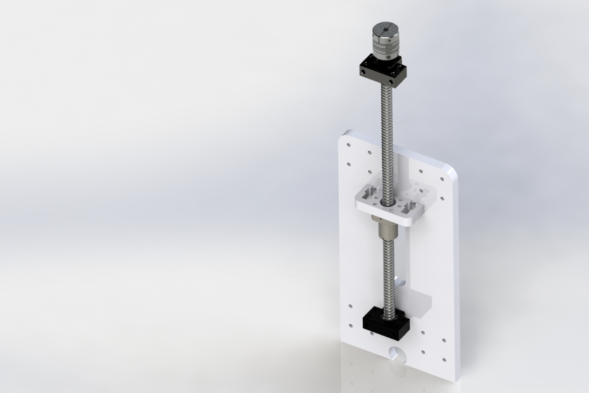

    Here are a few renders of the complete Z axis design (calculated weight is 9kg without spindle):
    Complete Z axis.

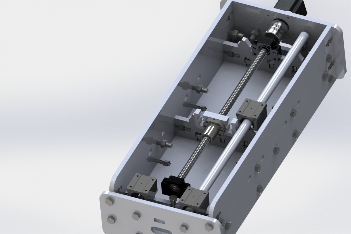

    Inside the frame.

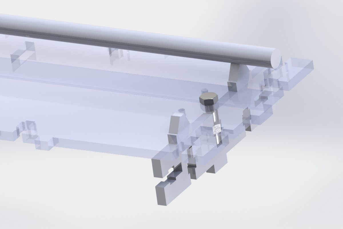

    This image shows the steel bolt and nut connection, plus the integrated linear shaft support. You can also see how the connections affect the part by cutting the shape of the bolt and nut, and adding joints on both sides of the bolt. I actually made smart components that achieve this. I have a few different versions and sizes for the connections:
    - simple: cuts the shape of the bolt and nut
    - single: cuts the shape of the bolt and nut + a "tooth" on one side (sizes are small, medium or large)
    - double: cuts the shape of the bolt and nut + a "tooth" on both sides (sizes are small, medium or large)
    All cuts have a play of .1mm. Bolts are M10 x 35mm with matching nut (standard, grade or pitch don't really matter as there aren't any tapped holes).
    Back of the Z moving plate with balll nut support. All made from 15mm steel sheet.
ID:	15905   Click image for larger version.
ID:	15906   Click image for larger version.
ID:	15907   Click image for larger version.

    It's certainly impressive I can see a lot of work has gone into this.
    I do worry about the straightness of the steel to get an accurate machine. May I ask why you have not gone with square profile rails? I look forward to watching this develop. ..Clive
    Hi Clive !
    Thanks ! Yes, you are right, probably more than 30 hours of modeling so far, because I went through several designs, and had never used SW before, so I had to learn everything from zero ! But now I've got most of it figured out :D Great program to work with, though sometimes a bit frustrating.
    I understand, I am not sure myself as it is an experiment. In the project I linked in my original post, they got a .1 play on joints, 0 play on holes (that's what I've got), and they cut the plates on a .001 accuracy machine, so plays were correct when cut. The machine that will cut my parts has more than .001mm so I'm not really worried about cut straightness. if all edges, joints, teeth and pockets are cut straight I wouldn't see how there could be any straightness error :/ Where would they come from ? Are you talking about the steel straightness itself ? May be I can ask them to surface the sheets from which they cut the parts on both sides ? Would that be a fix ?
    Price :) ! The goal was to make things cheapER. 12 SBR20UU blocks cost me $60. Stainless steel shifts will be less than $50 for all axis. Shaft supports are integrated to parts and don't add any cost to the machine but a few seconds of cutting.
    Thanks ! I am very excited to get the model ready and working so I can send the parts to the cutter :) !

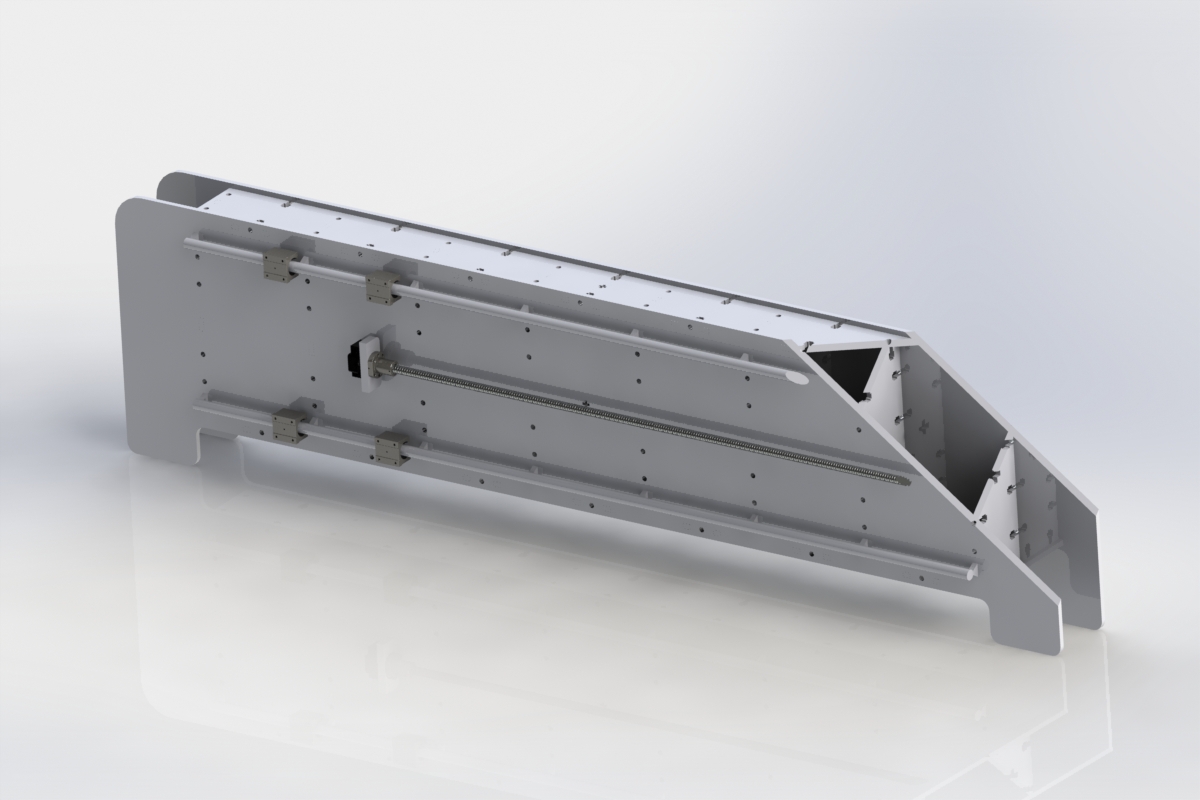

    Hey mates ! (hahahahaha for those of you who will get it)
    I spent yesterday modeling the Y axis. Today I will make the gantry sides to fix the Y axis, fix its motor, and connect Y and Z if I have the time.
    Here is a render of the Y axis with a section view (calculated weight is 28kg):

    Looking at your renders - in reality, your rails will be supported along their entire length, won't they? Not at intervals, like you've got them in the images..?
    Wal.
    Wal.
    Wal according to his first post he intends to weld them to the supports so not using conventional rails. ..Clive
