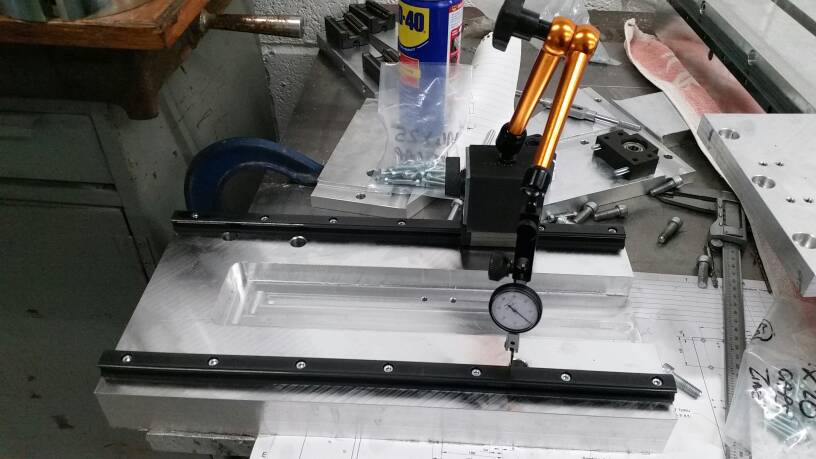

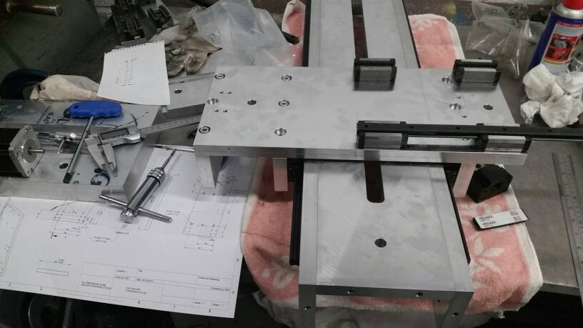

    I've got 15mm on my Y & Z and if I was doing it again I'd buy 20mm all round. The Z axis I've got round by using a 40mm thick plate and recessing it for the ballscrew and mounts so I could put the bearing carriages flat on the back plate...

    That pic explains the problem very well. ..Clive
