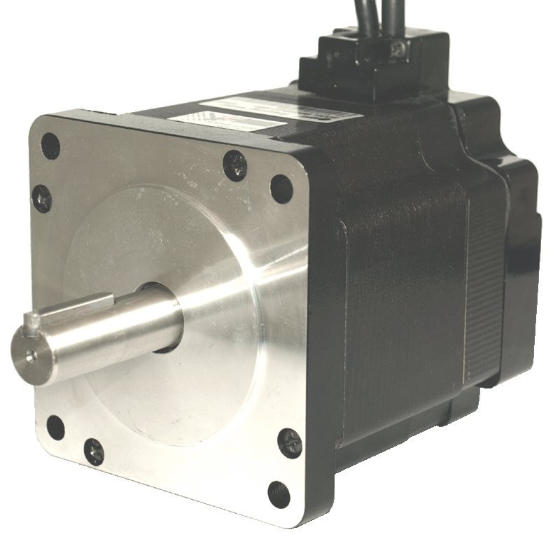

    been searching since yesturday to try and find an awnser for my question but cant seem to find one, im following a design ive seen regarding the z axis and i like how he has hidden his z axis motor rather then have it sticking up in the air but he uses pulleys with a 10mm pitch and im just trying to find out how to work out how wide you need the belt and pulleys, what ratio, how many teeth and the difference between 5mm pitch and 10mm pitch.
    also how would i go about fitting a pulley onto this nema 34 motor?
    cheers
    Ash

    Just use a HTD-5M pulley that accepts a taper locking bush, then there is no need to bore it out or add a keyway. Robins advise about having enough teeth meshing is a must.
    HTD 5M 15mm wide is the standard belt size most people on this and other forums use for nema 23 and 34 motors and servo motors.

    I would bore out the pulley and broach it for a key. Also drill and tap above the keyway for a grub screw. I would because ive just done it for 4 pulleys for nema 34s.
    The only problem I had was that I bought a spare nema 34 a while ago just in case I needed one. All bought from zap and all have the same part numbers. The only difference was that the new one has a smaller shaft diameter than the older ones. No prizes for guessing which shaft I measured before I made the broaching socket, drilled the pulleys and cut the keyways.
    Ah well at least a smaller hole can be bored out.

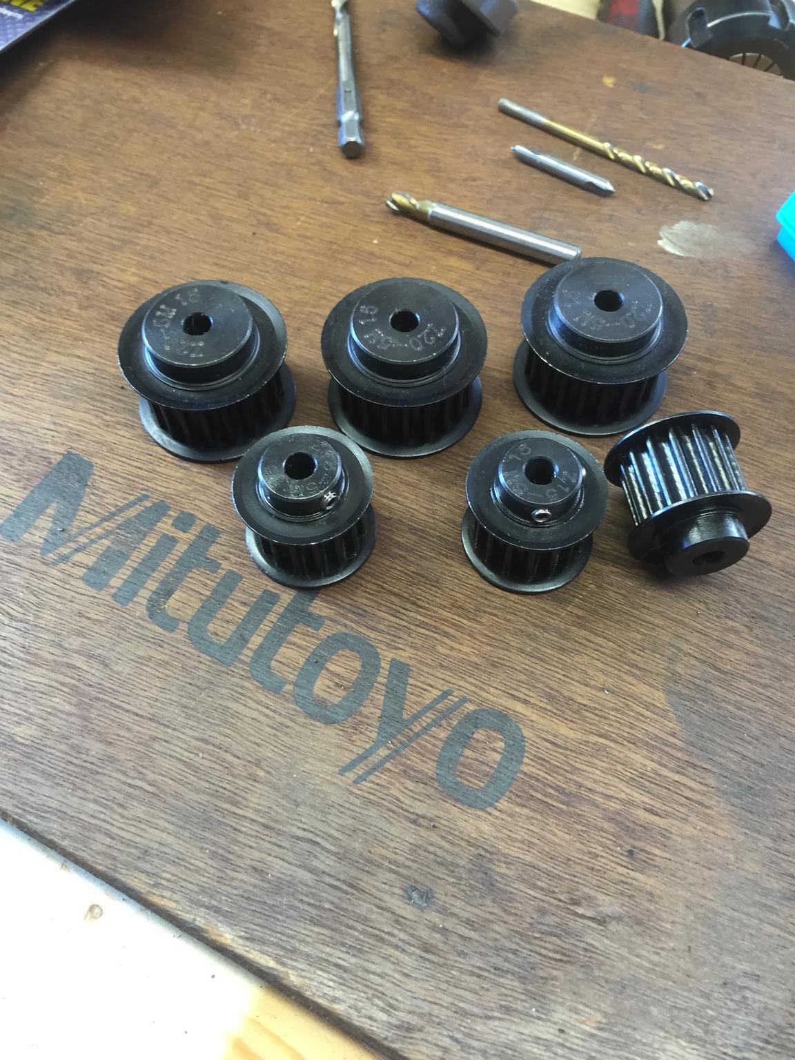

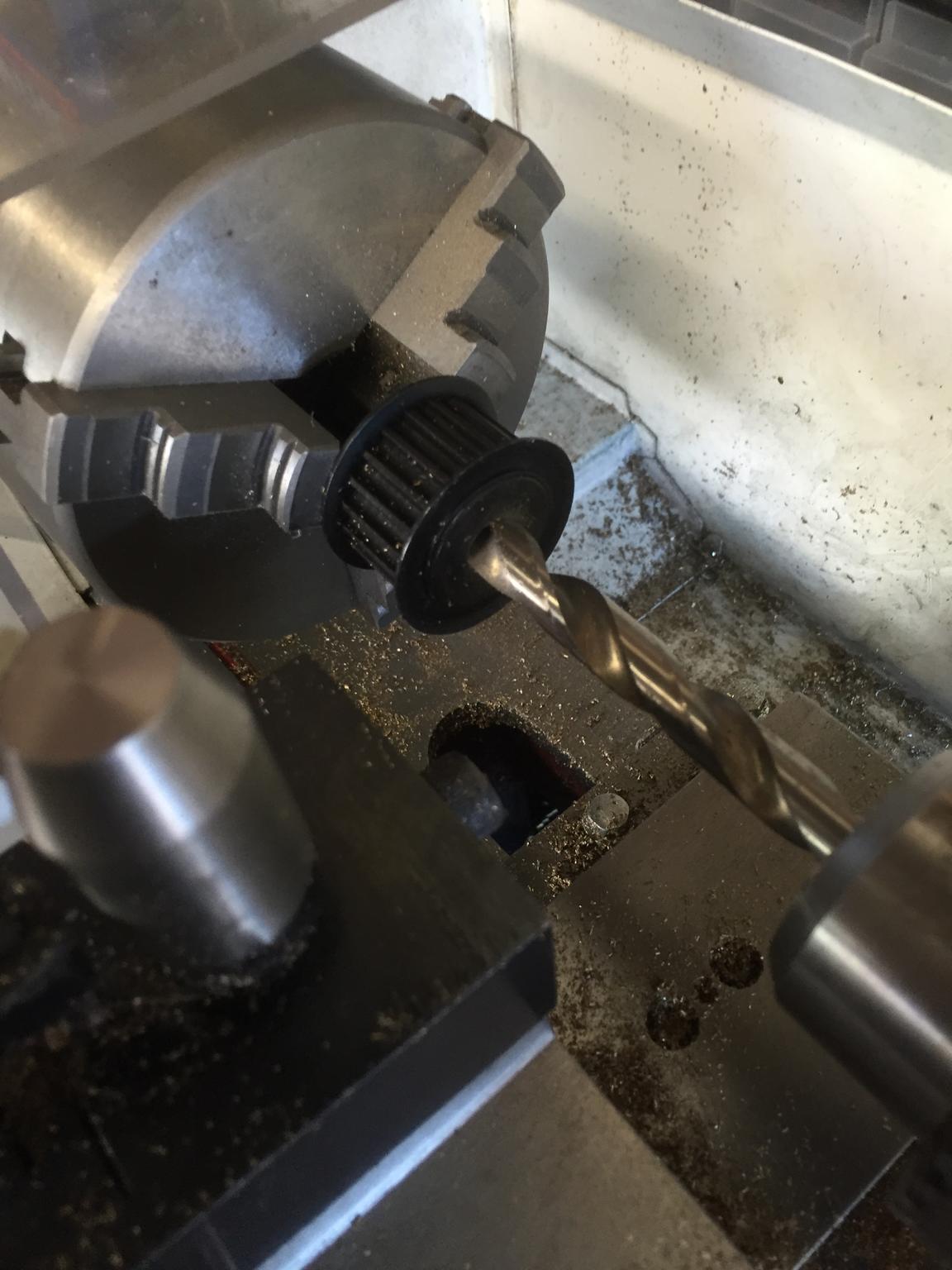

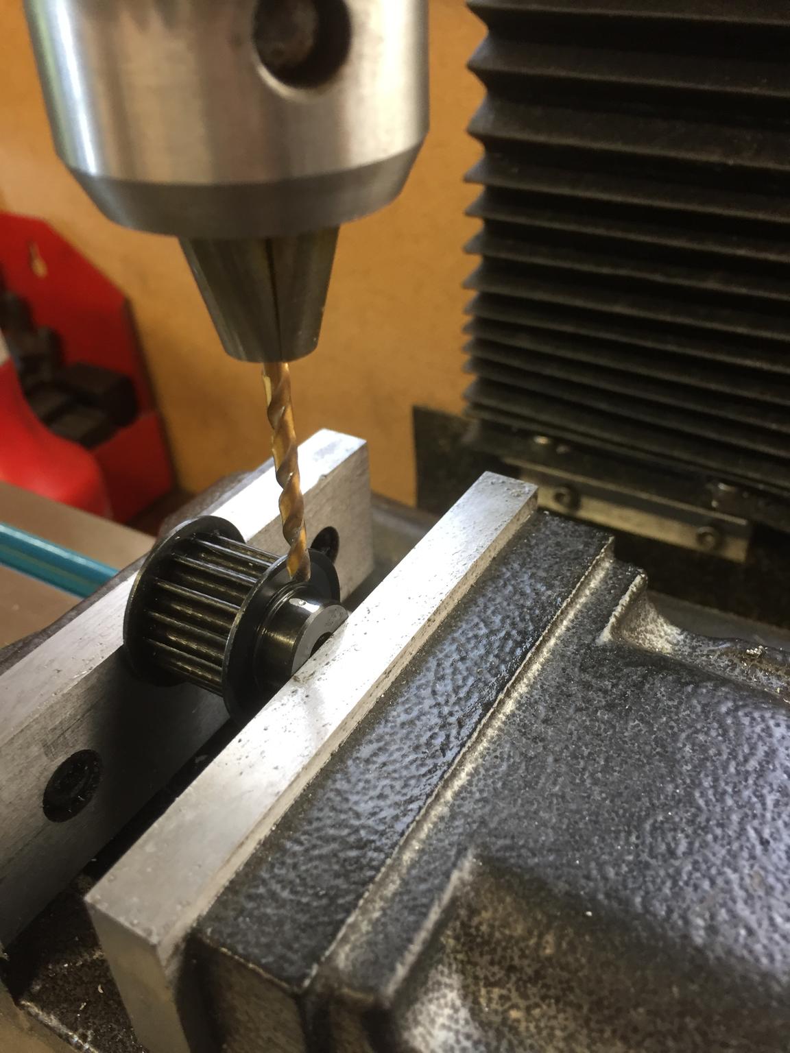

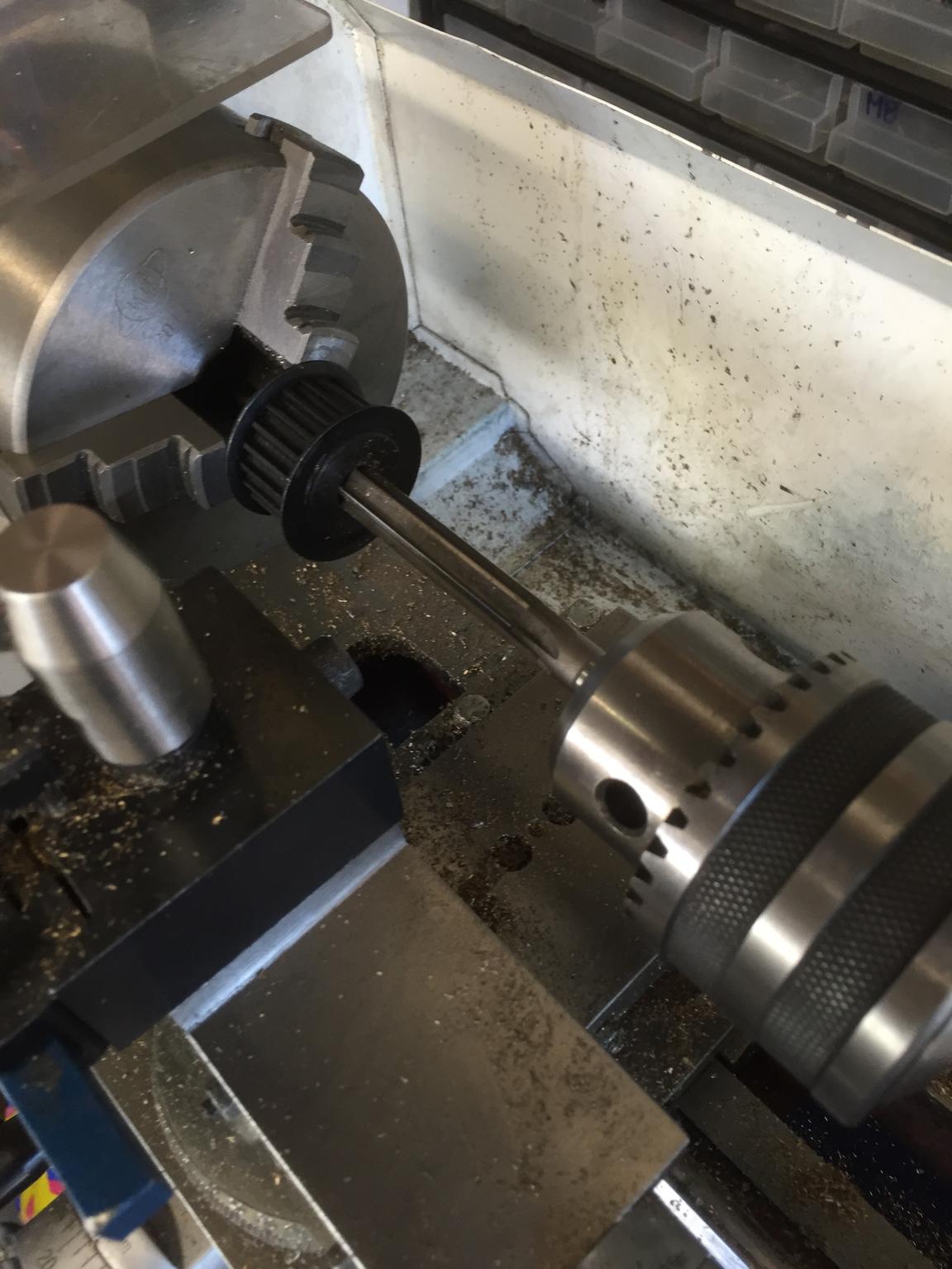

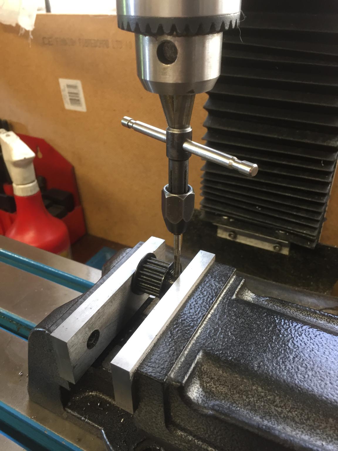

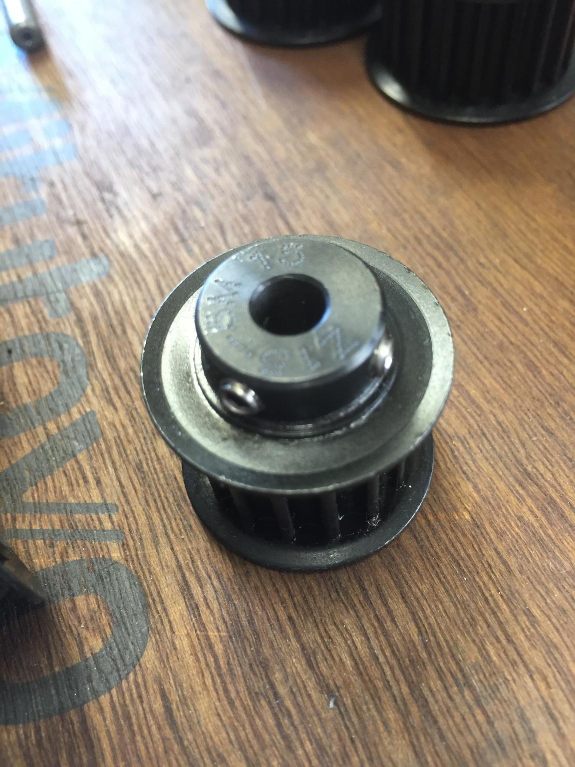

    Personally I use only HTD pulley - mostly 5M - 15mm wide. I used to try T5 and was not happy with backlash.
    As Boyan explained number or teeth matters, so my smallest pulley has 15 teeth. Ratio:
    15-20=0.75
    15-25=0.6
    15-30=0.5
    15-40=0.375
    15-50=0.3
    15-60=0.25
    I never use bigger pulley than 60t due to size.
    for bore start from 10mm I use broaching tool with key way 2mm wide. Biger bore wider key way. For 1/4" =6.35mm I drill and tap grab screw - start from 3mm for 15t - see photos
