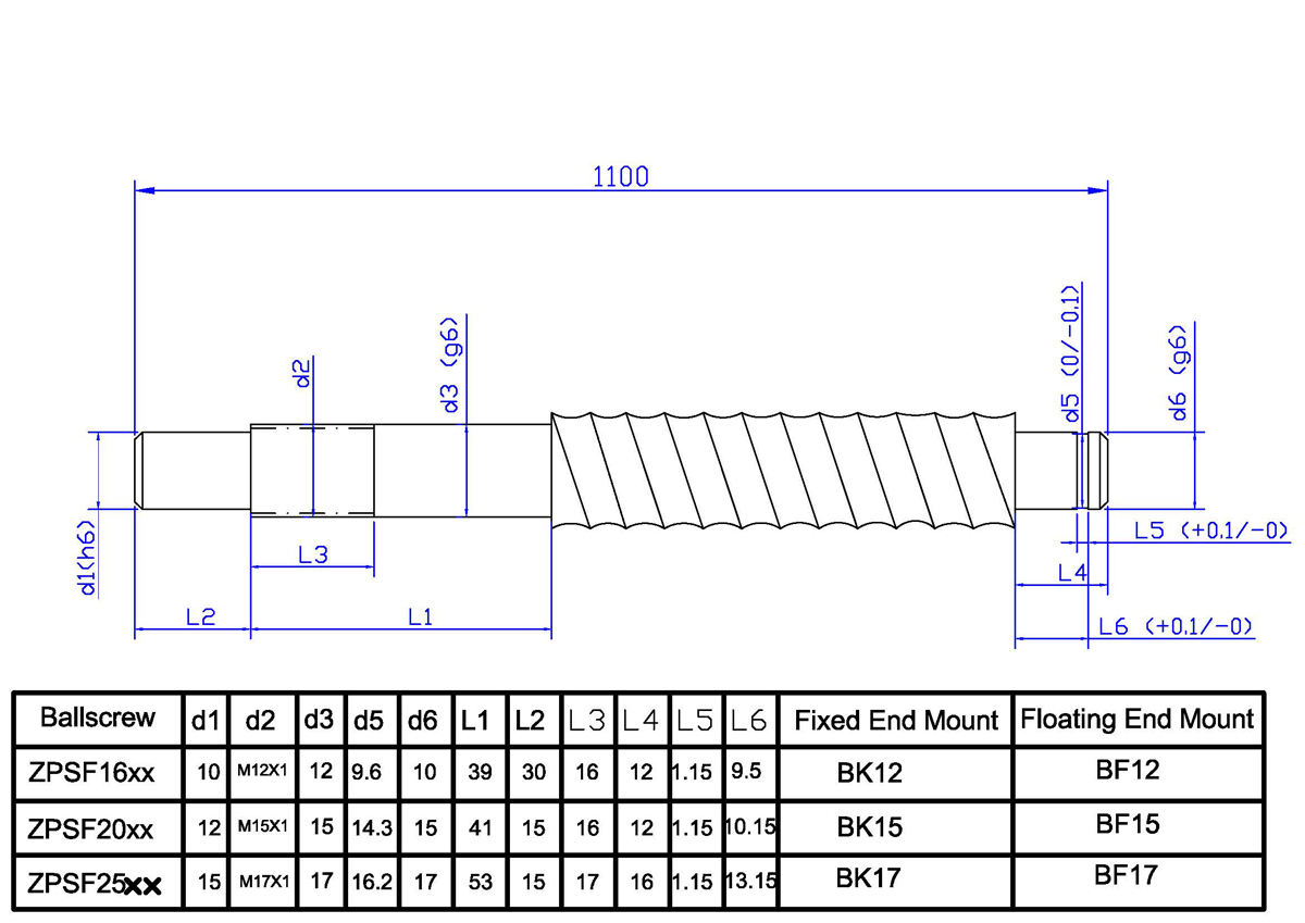

    Just came across this and thought it may be of use to people looking at machining their own ballscrews, it shows the 'standard' threads and bearing dia's. -

    anyone have something similar for 12mm ballscrews?
  8. #7
    No but I do have some 12mm ballsrews that I could measure for you...
    Not tonight though as after too many pints the tolerances get wider...
  9. #8
    Hi
    Marchant dice have some dimensions at http://www.worldofcnc.com/images/Machining.pdf
    although it appears that things have moved on the thread front in that the one I got from them had an m8 x 0.75 thread.
    A finer than the m8x1.0 on the list which meant more expense buying a tap and die which I had to buy as the other ball screws did not have the ends machined.
    Peter
  10. Here you go.
    http://www.slidesandballscrews.com/p...ages 63-64.pdf
    Quote Originally Posted by m100 View Post
  11. #10
    m100's Avatar
    Lives in Yorkshire, United Kingdom. Last Activity: 15-06-2023 Has been a member for 9-10 years. Has a total post count of 10.
    Thanks, much appreciated!
