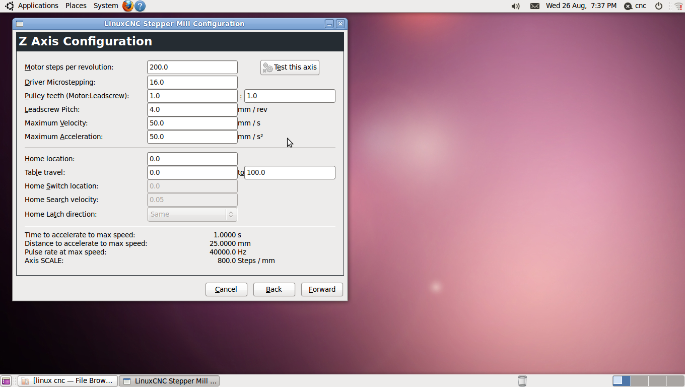

    I'm using linuxcnc. All seems to working well except the z axis. The x and y work fine which is why I'm confused as to why the z axis is not moving. All the steppers are wired up the same (parallel) and the lead screws the same on all 3 axes (4mm pitch trapezoidal). The only difference is the z is using a pulley and belt while the x and y are directly coupled.
    The x and y move fine in all directions when holding down the jog key, whereas the z just stalls. If I keep pressing the jog key the stepper moves tiny amounts at a time but it won't feed or jog at all.
    I'm kind of lost as to what I have done wrong as each axis has been setup exactly the same in both the Linux software and on the leadshine unit jumpers. Or am I missing something simple?

    Have you tried swapping the z over to the x or y just to test. Post the ini and hal file .. ..Clive

    Hi there thanks for the reply.
    I have just tried swapping the z stepper cables with the y and the z axis moved fine, the y then had the problem. So does this tell me that the wiring is fine but there must be something wrong with the mx3660 unit?

    Can you post the .ini and hal files and a picture of the settings on the drive like I suggested before.

    i cannot upload the .hal and .ini files, so I'm presuming you just mean copy and paste the content?
    the .hal file:

    the .ini file:

    MAX_LIMIT = 0.001
    HOME_OFFSET = 0.0
    One thing I have just noticed is that when im in the step config wizard and i click on the 'test this axis' button. my z axis moves fine?

    Clive you are my hero!
    It now works. I changed the z axis limits to be between -75 and 0. I was sure that I had tried it at that setting before but i must have got the numbers the wrong way round.
