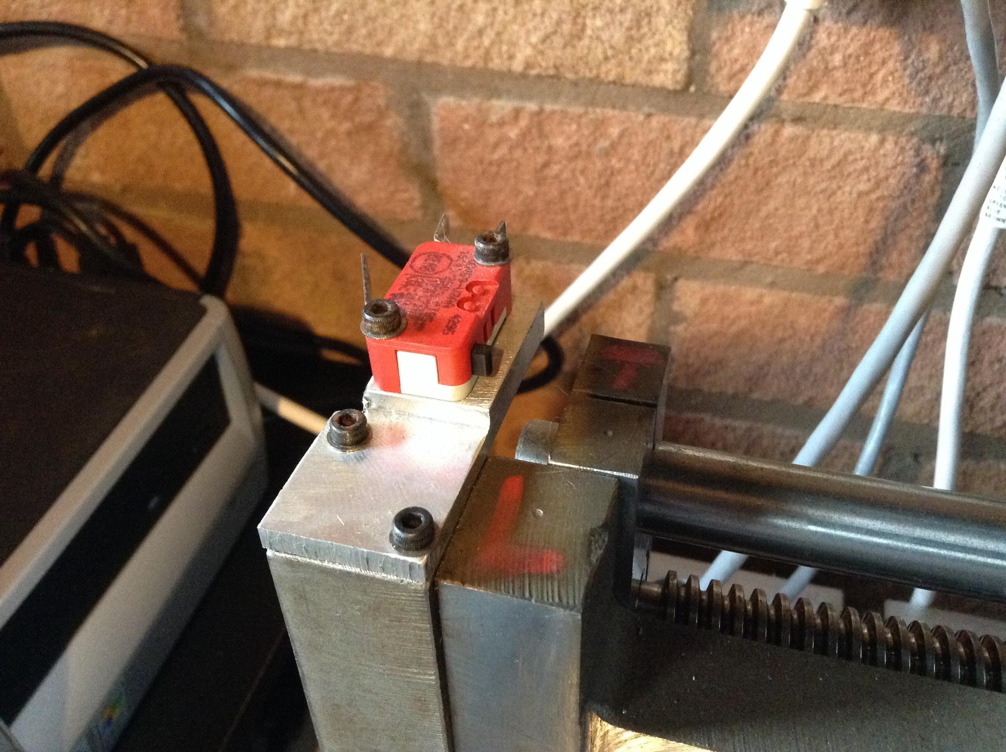

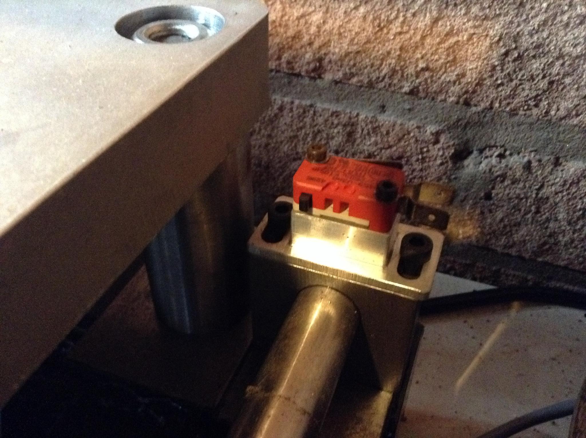

    My main issue was how to wire up 6 limit switches to only 4 inputs but after a bit more research I now realise there are multiple ways I can do it. Now I know that I can do multiple switches in a series I think I should be ok.
    I should be ok with the linux bit as the stepconf wizard is nice and easy when setting up the parallel port pin id's. However if I'm wiring X+, Y+ and Z- in series then what option would I choose for that input?
    The switches I'm using a only basic, in fact they probably aren't the best for my machine as they aren't lever type ones, just a small plunger. But they are all I could get my hands on for free!
    The images show the limits mounted in x and y, I haven't yet mounted the z as I need to make a suitable bracket first.

    My MD machine came with inductive home switches and they were mounted axial to the travel, so it was possible (and too damn easy !) to jog onto them and crush the sensor coil. So my first mod was to move 'em round 90degrees and make them bypass sensing (if that makes sense).
    I notice you say 6 limit switches. It is not usual to have a Z--, so why 6 ?

    Ok I would not use a limit switch on Z- just the home switch z+ at the top because there generally is no defined position because of tool length etc.
    Also be aware that if you do it in stepconfig and then edit the .ini file the file will be overwritten the next time you use stepconfig. hope this helps.

    Ah right I understand about the Z- limit switch, of course that's not really needed then. And mounting the limit switches at 90° is a good idea too, think i may try that.
    I think i know what i'm doing now, thanks very much for your help.
