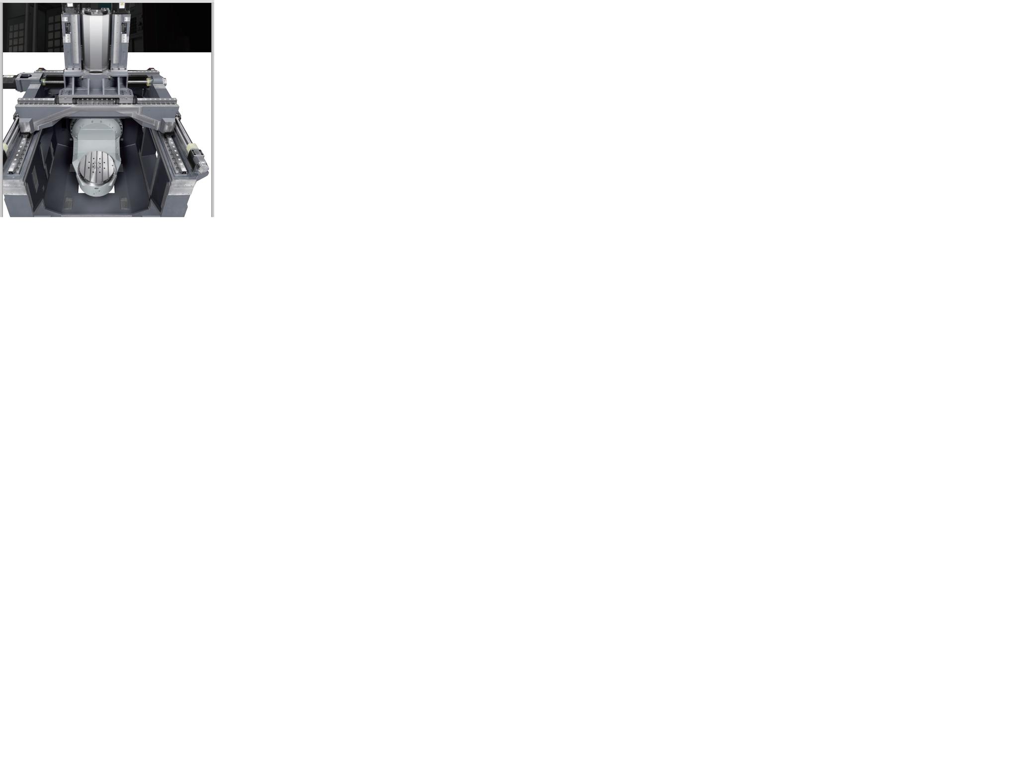

    I know this is a commercial machine but there are some nice ideas here for a 3 axis machine:
    http://uk.dmgmori.com/blob/172034/d7...0-pdf-data.pdf
    This for example on page 7:
    Although some of the ideas are already found in machines built by members:
    Raised X rails - as seen many machines on this site
    Linear rails onto ground surfaces - with small side locator pins (as fvfdrums rails)
    Driven through centre of gravity, twin ballscrew, even on Z axis (as Sylavski)
    Box in box Z axis and double rail Y axis (as Jonathan's machine)
    Got me thinking about a new machine . . .
