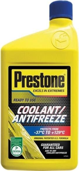

    Do you mean antifreeze when you say radiator fluid.I got a bottle of this stuff in the picture. would this stuff be ok.Click image for larger version.

    something like this would be better i suppose

    This is fine. I use cheap halfords type stuff. Change it every 6 months but should be good for a year or longer depending on use. Make sure you have a large quantity of water if you are running for a long time.
