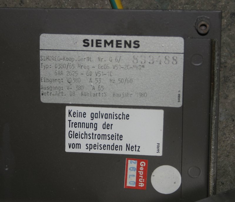

    Unfortunately, I can't open the pdf. Eventually I have a big DC-Motor for you, but before I can see, what machine you use, I don't know if its to big. the little Motor have some 22kw and the electronic part is also here. But I have no clue, how you must it wire, to the other machine parts.

    I have the electronic part from Siemens.Click image for larger version.

    But how is the harness from this part, it has feeled 1000s of cables go to and from.

    How big and heavy is the electronic part from your motor? As you can see in the pdf, the electronics from the '60s fit in a big cabinet attached to the lathe
    The different offers in the net say from 15 to 19kg, also not to heavy to ship it with DHL or other parcel services.
