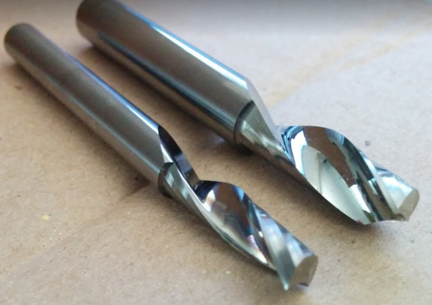

    The single flute VHM cutters also came in and they look really mean:
    6 and 8mm
    Around Friday / Saturday I'm able to start experimenting.

    I like the 2F VHM cutters more than the single flute. The 2F allows me to go higher rpm and feed-rate (at least in Gwizard).
