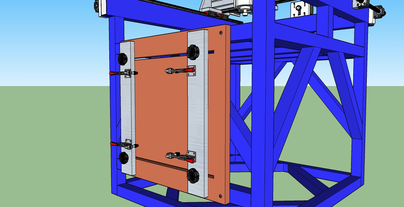

    Yes, and thanks for great input JAZZ, it is just me, whenever I am working with something I always start thinking if it can somehow be improved - even if it is great to begin with.
    Actually, I think it will be very rare that I need to clamp very thick material, and if so I could clamp it to the frame with normal wooden clamps, or even make some kind of spreader bar as you suggest. So I will use the toggle clamps - and they are cheap too.
Name:	dove tail jig.jpg
