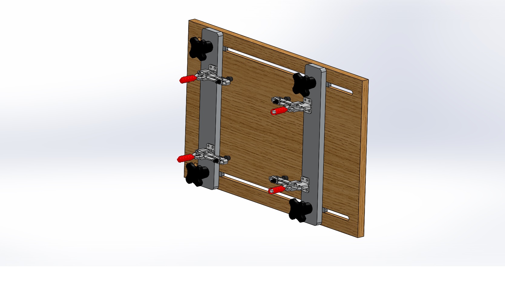

    Something like this works well for holding boards on end.
    Slots with Pockets on backside.

    Thanks JAZZ. This is actually a brilliant design. It is simple to make, it can be removed from the machine when you are not using it and the width it can accomodate is adjustable.
    The only thing that may not be optimum is the thickness of the material you can clamp. I remember using this type of clamps (although much smaller) and the reach is not so big. I tried to find the reach for similar types. I only found this specification for a single one and it was 3". I am not sure if that means it will go from 0 to 3" or if it is just the maximum. Maybe you can use this type of lever clamp instead (although they are quite expensive):

    There are many ways to do this and many types of clamps to help but the simple and easy way's are often the most affective. In this case it would be a simple spreader bar which is bowed so when clamping wide boards pressure is applied in the centre.
    I was only really offering simple example of how to do it but not really being specific regards clamping etc.

    Yes, and thanks for great input JAZZ, it is just me, whenever I am working with something I always start thinking if it can somehow be improved - even if it is great to begin with.
    Actually, I think it will be very rare that I need to clamp very thick material, and if so I could clamp it to the frame with normal wooden clamps, or even make some kind of spreader bar as you suggest. So I will use the toggle clamps - and they are cheap too.
