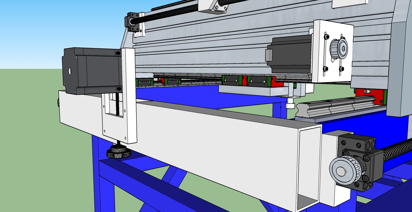

    Thanks - lots of really useful info. I know a lot more about limit/home switches now.
    So 3 switches it is. Based on the above, I cannot really see why you would want to use separate home switches - unless you want some very special home position?
    And let us switch tune. I have updated my model with a single Nema 34 motor for the Y-axis and an adjustable mounting flange, as suggested by Silyavski. Is 20T pulleys/idler pulleys ok for this, or should you choose larger ones?

    Quote Originally Posted by ngundtoft View Post
    Yes they will be fine arranged like this with nearly half the teeth engage. Don't want to go too large other wise the extra interia starts to affect things.

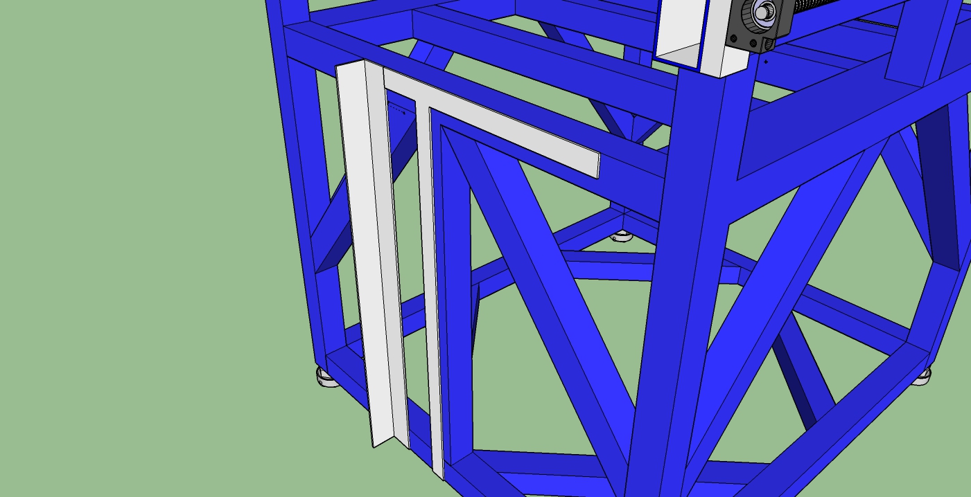

    I have been thinking about how to design a holder so that you can route dove tails at the end of boards.
    This is not a function I will be using every day, so it should be simple and it should not compromise the machine in other ways.
    I read the thread by EddyCurrent and how he has done it. It looks good and stable and I am sure it works very well.
    However, I don’t want this function to interfere with the precision of the bed, so I am not too happy with the removable plate. Also, for handling, I find it somewhat impractical to have this opening in the middle of the machine. All that is needed is a jig that will hold the work piece in an accurate and repeatable position. So I was thinking of placing it at the end of the machine, as shown in the model. You simply fasten the work piece with one or two clamps. I may have to extend the cantilevers/ rails to get sufficient overhang for the spindle or alternatively reduce the length of the frame, since this machine is already getting fairly large.

    I remember Jazz showing (it had a red frame I think) a design that did just this, it could take panels etc on the front to rout the ends. This is one thing that I'd on my list for mk2.......

    Something like this works well for holding boards on end.
    Slots with Pockets on backside.

  9. #49
    Thanks JAZZ. This is actually a brilliant design. It is simple to make, it can be removed from the machine when you are not using it and the width it can accomodate is adjustable.
    The only thing that may not be optimum is the thickness of the material you can clamp. I remember using this type of clamps (although much smaller) and the reach is not so big. I tried to find the reach for similar types. I only found this specification for a single one and it was 3". I am not sure if that means it will go from 0 to 3" or if it is just the maximum. Maybe you can use this type of lever clamp instead (although they are quite expensive):

  10. #50
    There are many ways to do this and many types of clamps to help but the simple and easy way's are often the most affective. In this case it would be a simple spreader bar which is bowed so when clamping wide boards pressure is applied in the centre.
    I was only really offering simple example of how to do it but not really being specific regards clamping etc.
