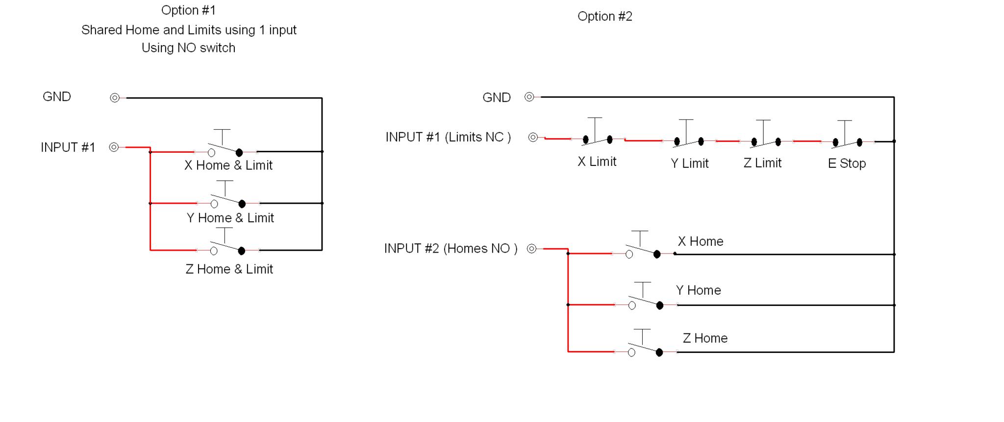

    Well kind of but your way is a bit mixed up because the (+) Limit is NC but the (-) limit along with Home are NO so doesn't have the safety on the (-) limit side if wire breaks.!
    If you used all limits with NC wired in series on one input and homes with NO wired in parallel then you'll be safer.
    Quote Originally Posted by Tom J View Post
    I was wonder how you get away with having only one sensor, must use soft limits in Mach for safety. I've seen 3 sensors solution: limit+ limit- and home in one axis, but I think is not needed.
    Correct me pls. if we I am wrong.
    No Softlimits are optional and not required you still have Limit switch safety.
    Maybe what your not realising is that Mach only Watches Limit Inputs when working and ONLY watches Home Inputs When Homing and Ignores Limits while doing so. It also by default Moves one axis at a time so only looking for one Input to change state. If all set to same Pin # then any will do for mach.
    This is why you can share one input for ALL axis homes & limits provided they use NO switches. Mach doesn't know or care which Switch triggered it just responds to the trip.
    So if cutting it see's this trip and knows it's a Limit so E-stops.
    If it's homing then it knows the Axis it's moving and when see's Home Input change state it sets the Home position for that Axis. Then moves onto next Axis and does the same. It doesn't care which switch tripped so in practice you can actually set say the X axis Home by triggering the Z or Y axis switch.!
    The ONLY time it won't work is if you have changed the HOMING sequence so 2 or more Axis home at same time. In this case you need separate Home inputs for each axis.
    Got it, but not quite to the end. How than having NO switch will provide safety on the limit side if wire breaks?
  4. #33
    You can't have continuity safety with NO switches which I did say this in other post.

    Summarize, if I use TB6550 or similar BOB which has only 5 inputs: 1-X, 2-Y,3-Z,4-Limit/E-stop,5-GND than 3 switches used as home/limits detect the ground signal (NC-active low). Mach knows that this axis is in home position.
    How should I wire if I use the same switch as Limit? Can not wire the same switch to pin 4 (limit/E-stop)
    Using pin 4 will collide with homing (all switches will be in parallel - remaining two will have NC contact therefore no homing)
    Jazz, could you please send the wiring - loosing plot.
  6. #35
    You got me bambozzled now and Not quite sure what your asking for but here's quick diagram showing 2 options. Option #2 is probably your best option.

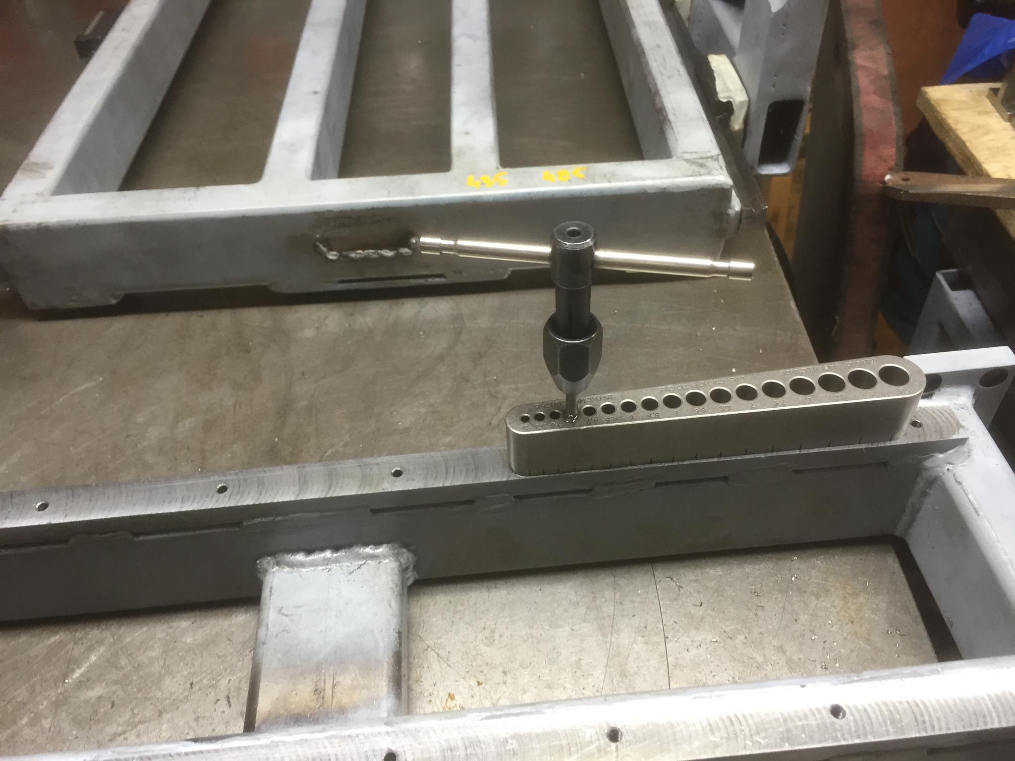

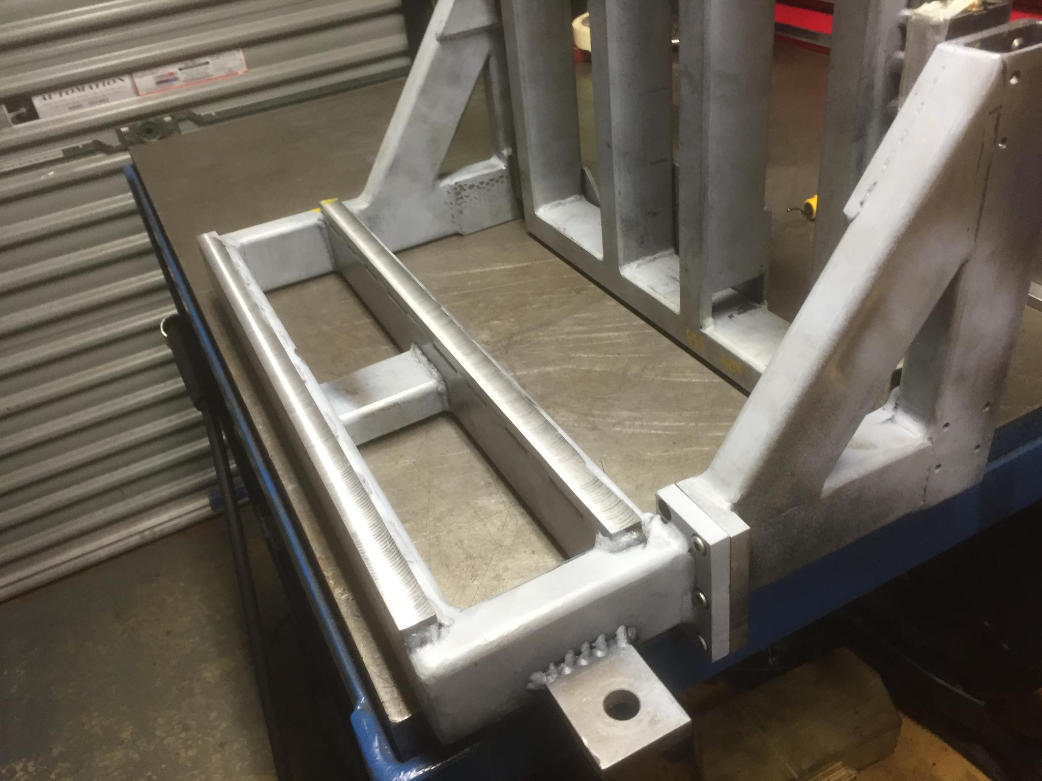

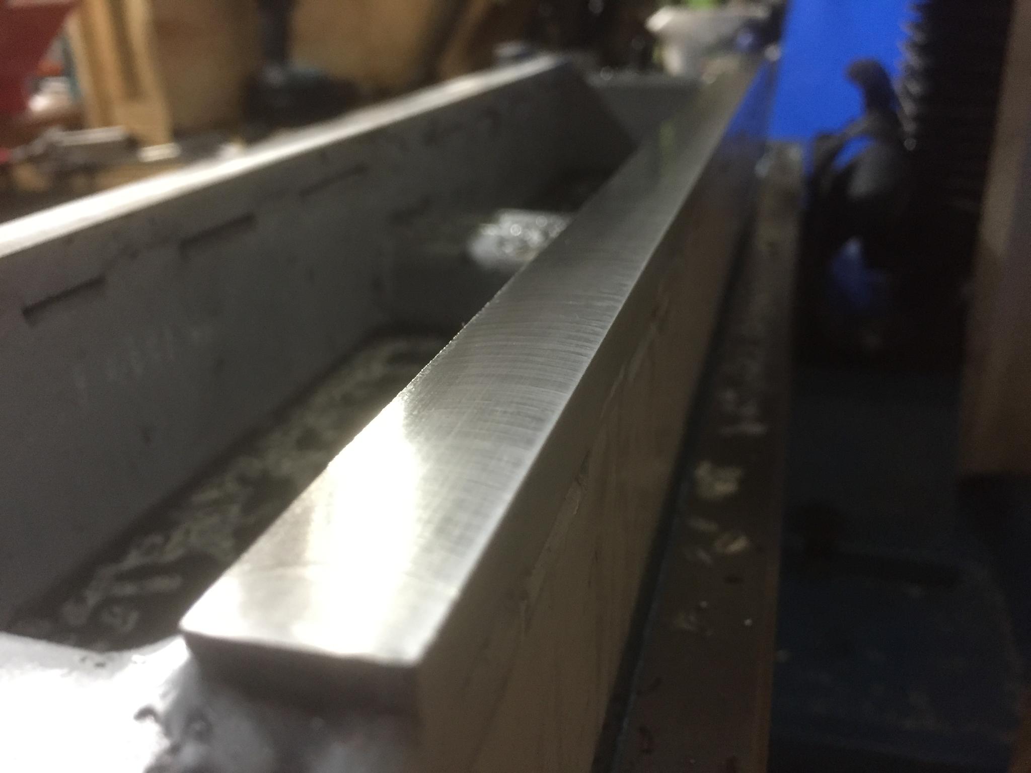

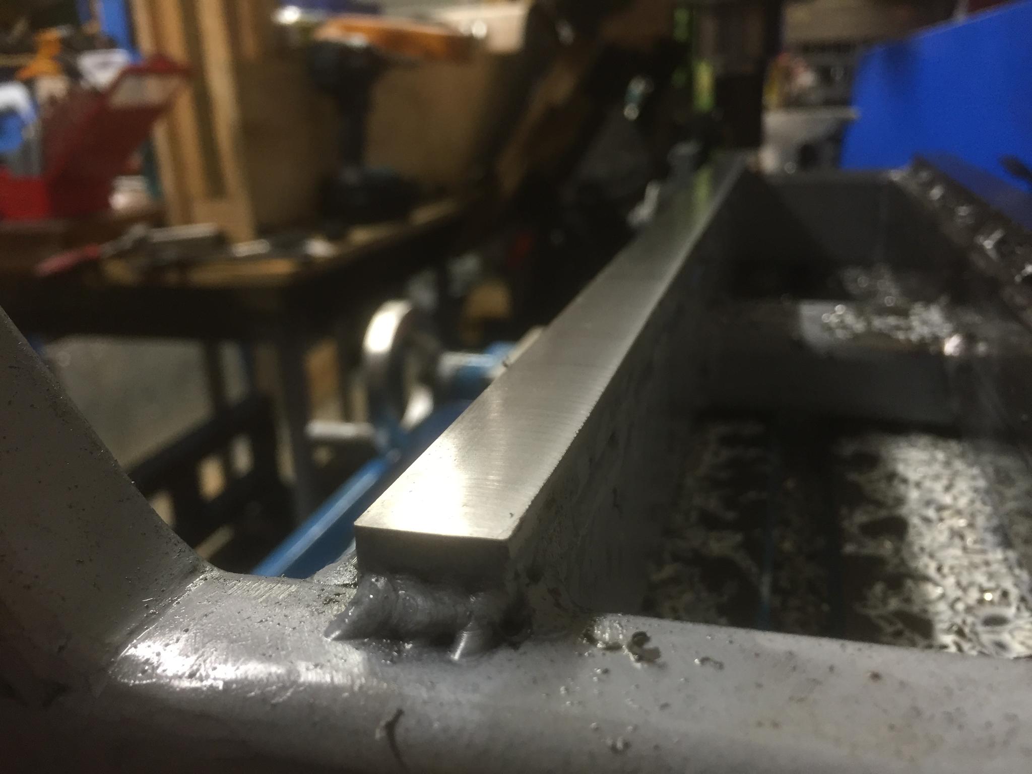

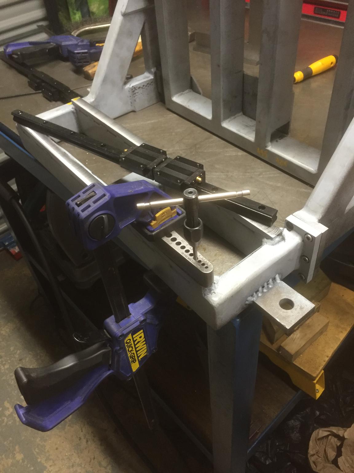

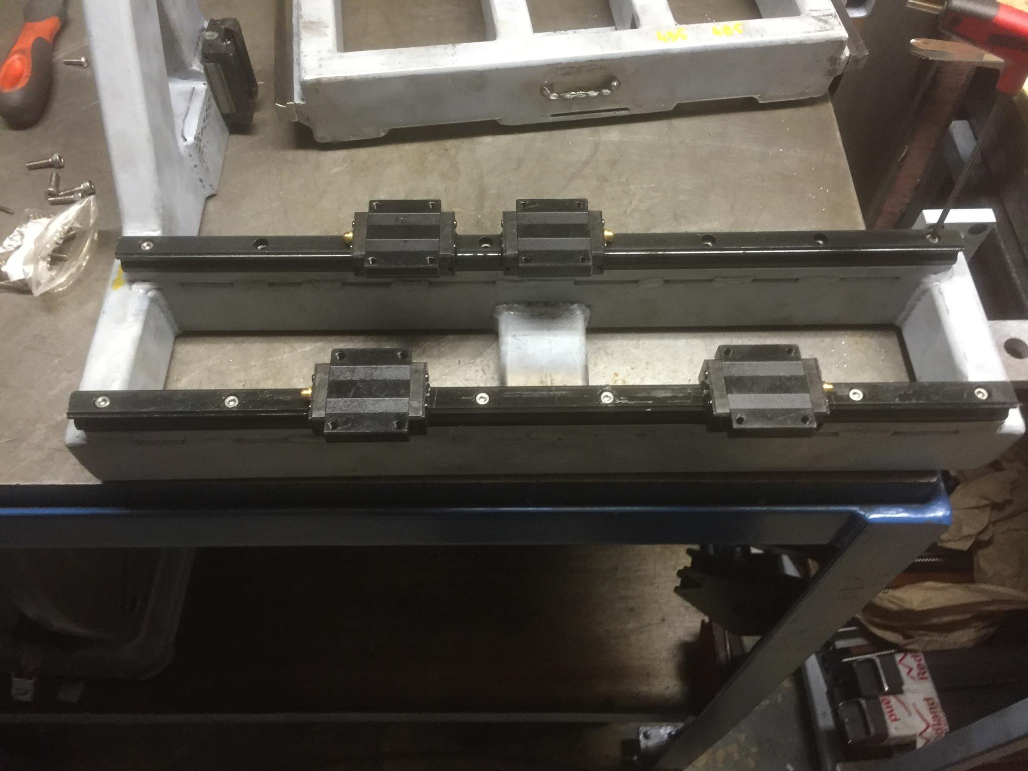

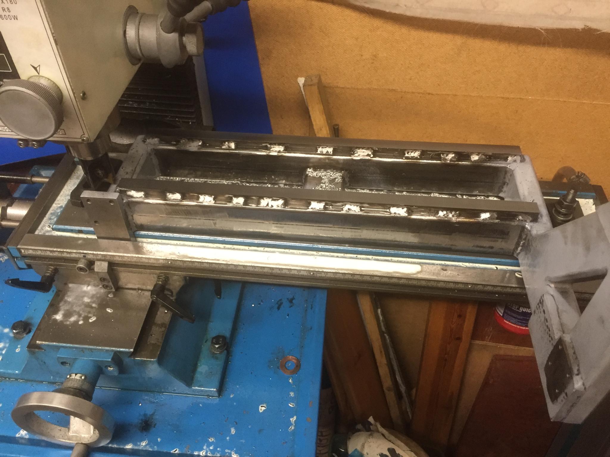

    Machining base for X -rails
Name:	2015-12-01 21.28.36.jpg
ID:	16667Click image for larger version.
Name:	2015-12-01 21.28.56.jpg
ID:	16668Click image for larger version.
Name:	2015-12-01 21.29.07.jpg

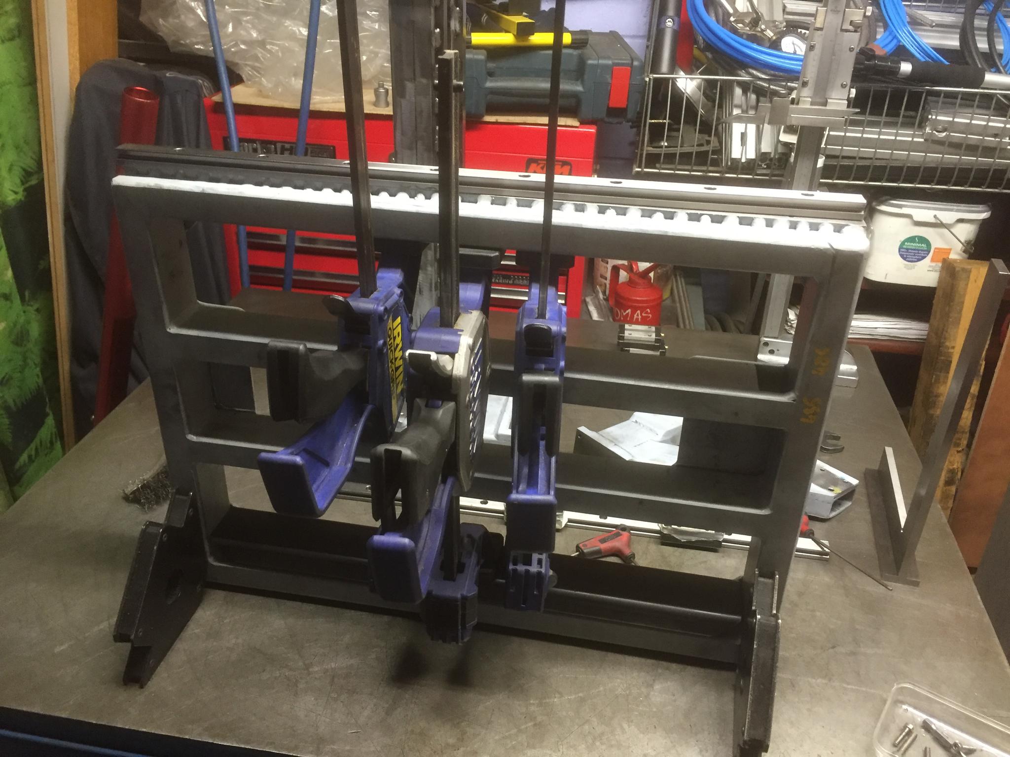

    Had to bend frame in the places to be perfectly straight - left those Irwin for overnight to see if 0.8 mm sag is dissapering
Name:	2015-12-01 22.01.09.jpg

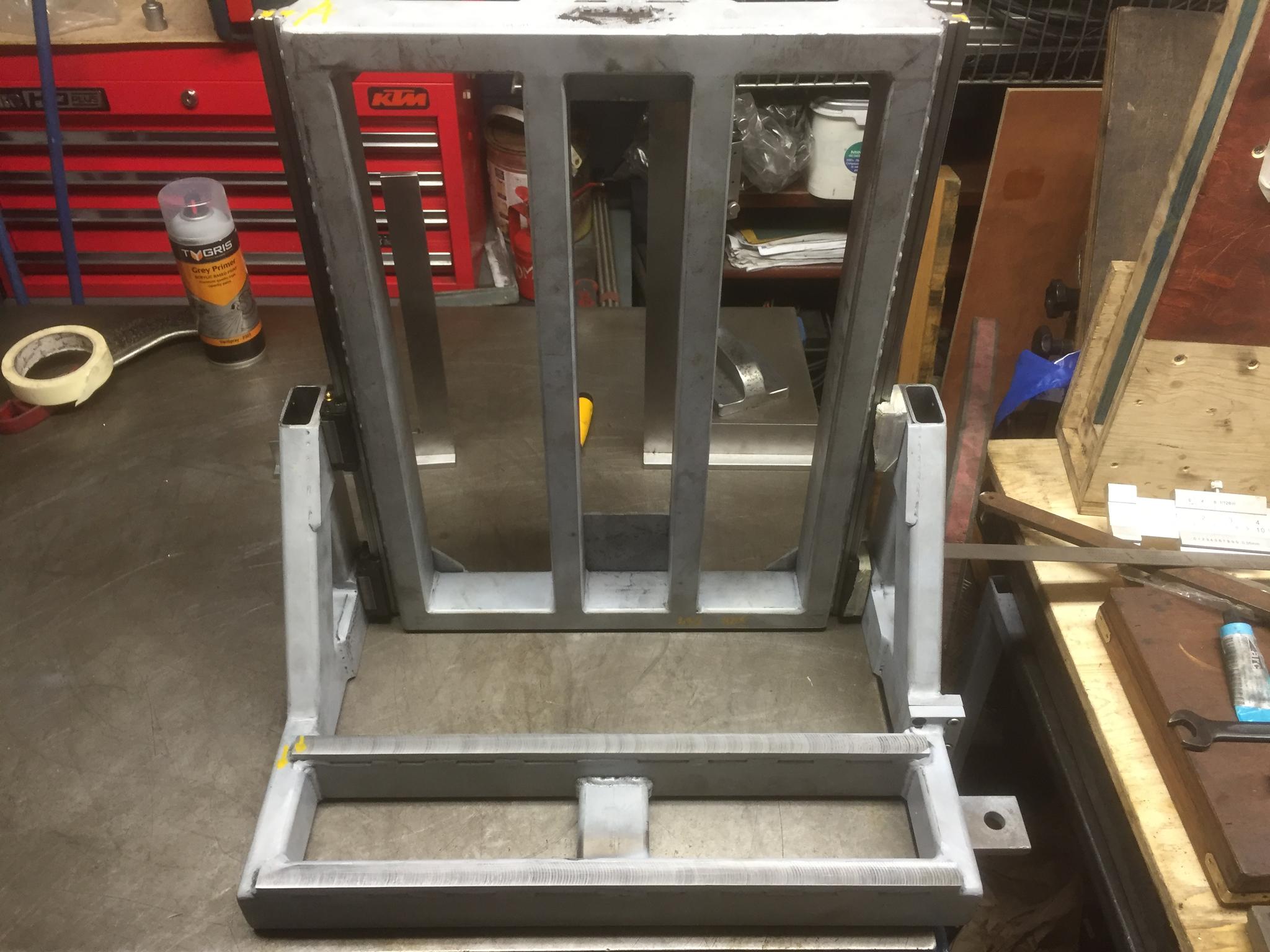

  10. #39

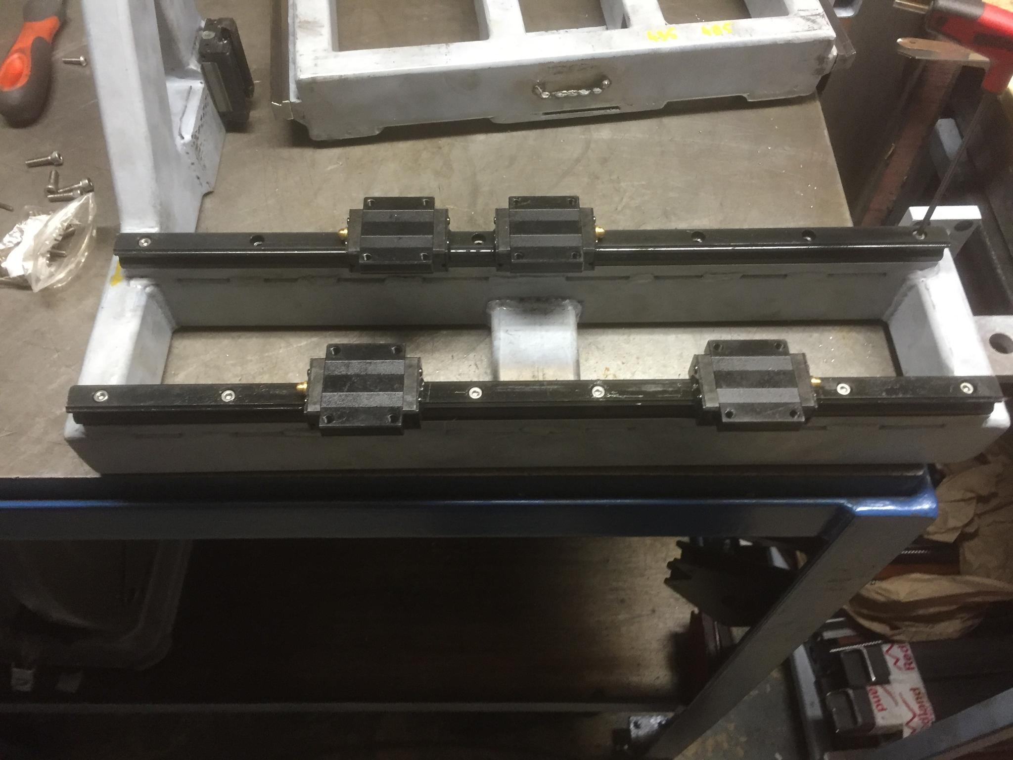

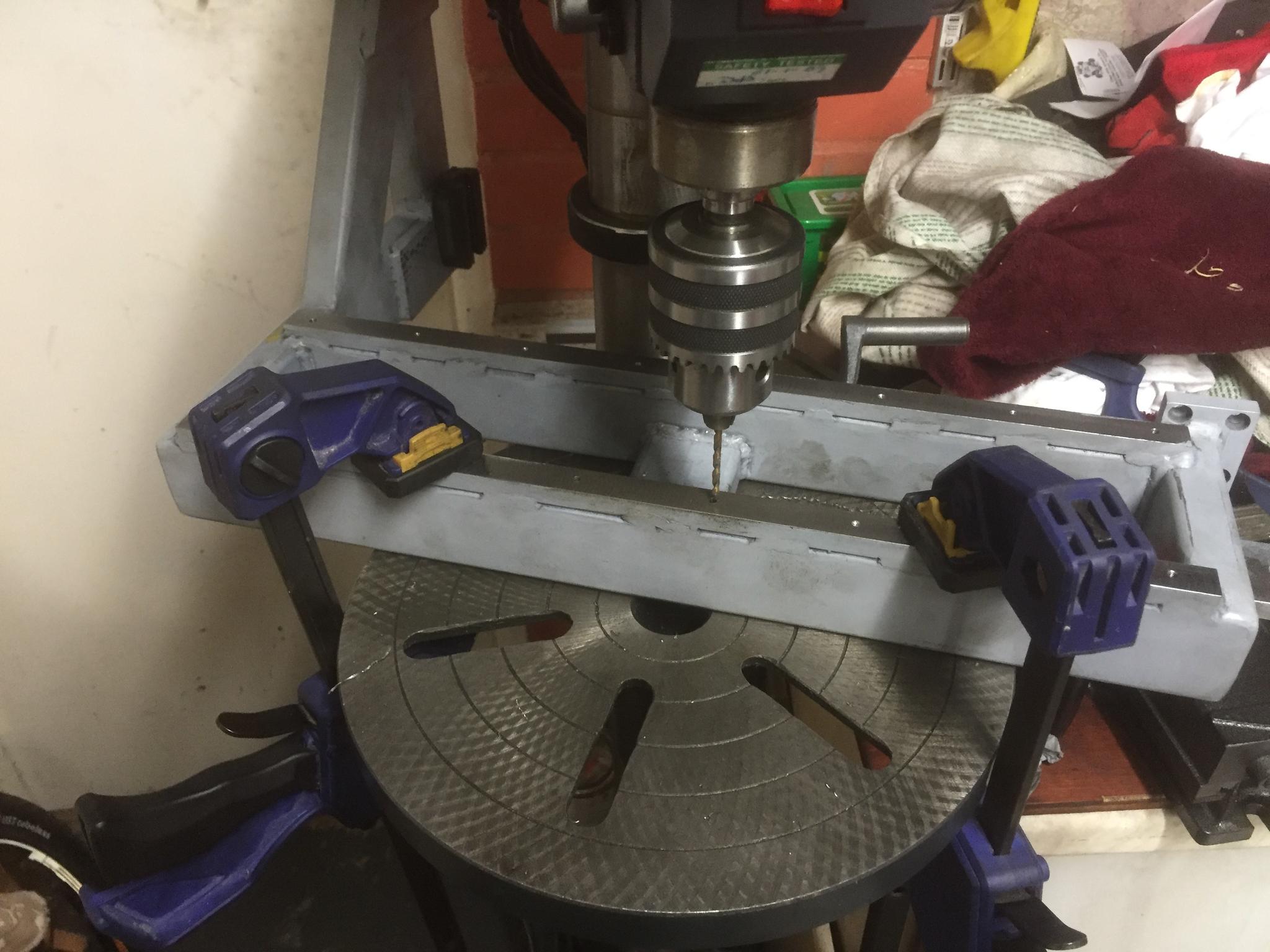

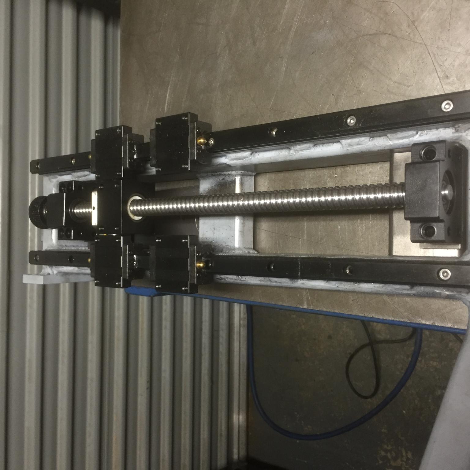

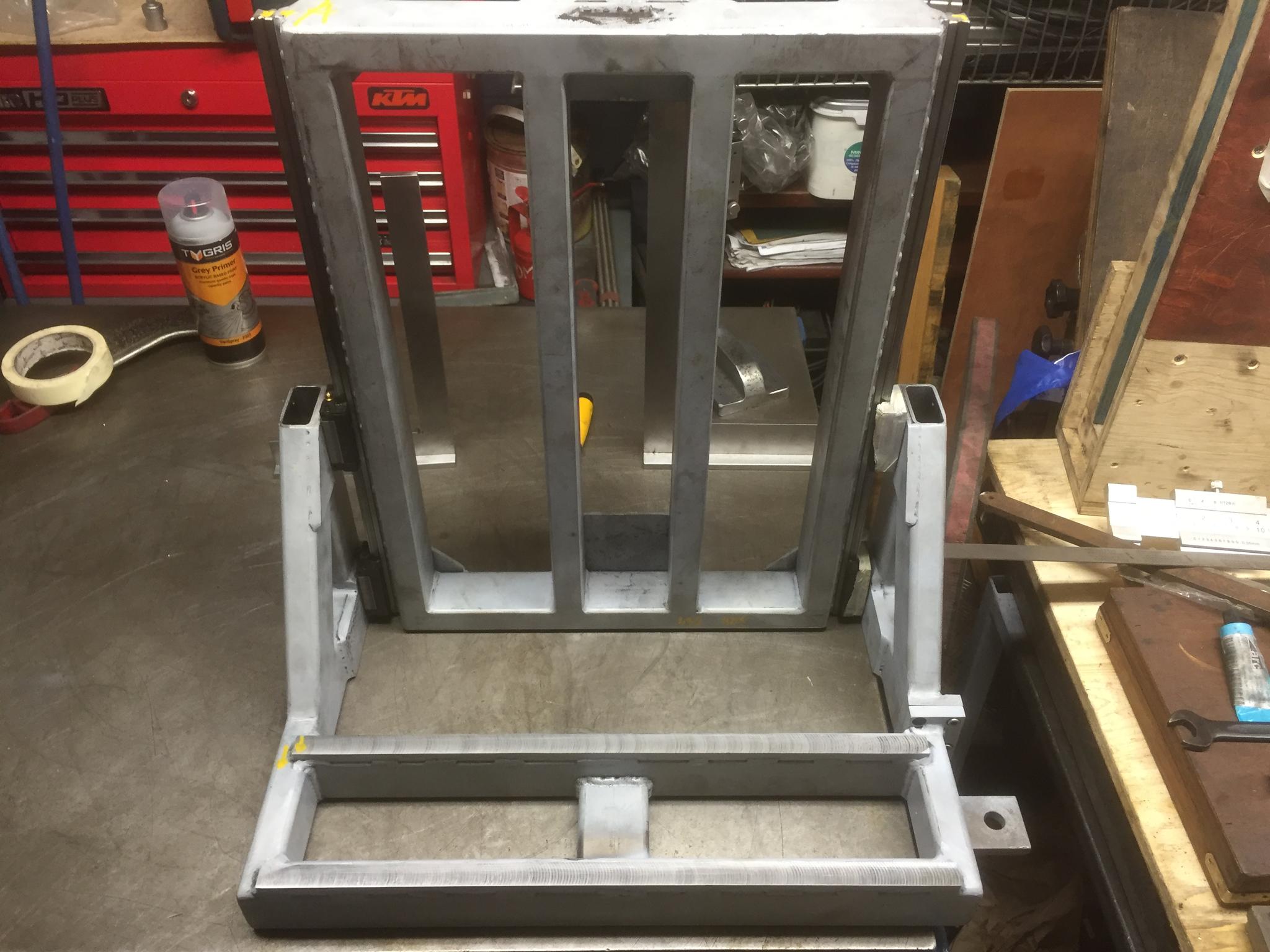

    I managed to get 0.4mm off the sag, better than nothing, will use the technique like those who do not machine the profile or base. Simply will use filler gauge - industrial sheet in the middle to compensate - do not want to have tension on the bearing block while is sliding from middle towards end.
ID:	16686Click image for larger version.
ID:	16687Click image for larger version.
ID:	16688Click image for larger version.
ID:	16689Click image for larger version.
    After welding so many frames came up with solution - there is not substitute for slow welding with min heat. Mean the welding bed have to be short and fully cooled before we weld again near by.
    I put all theory to the bin with current setting to metal thickness and speed wire on MIG.
    I use Clarke MIG TEC230 Turbo which is capable to weld up to 7 mm on max setting (switch pos.6)
    My profile is 2-2.5mm with plates 5mm and I use pos.3 - current/power and wire speed min as possible to stop splatter but fast enough to get good constant sound (not like a shooting gun)

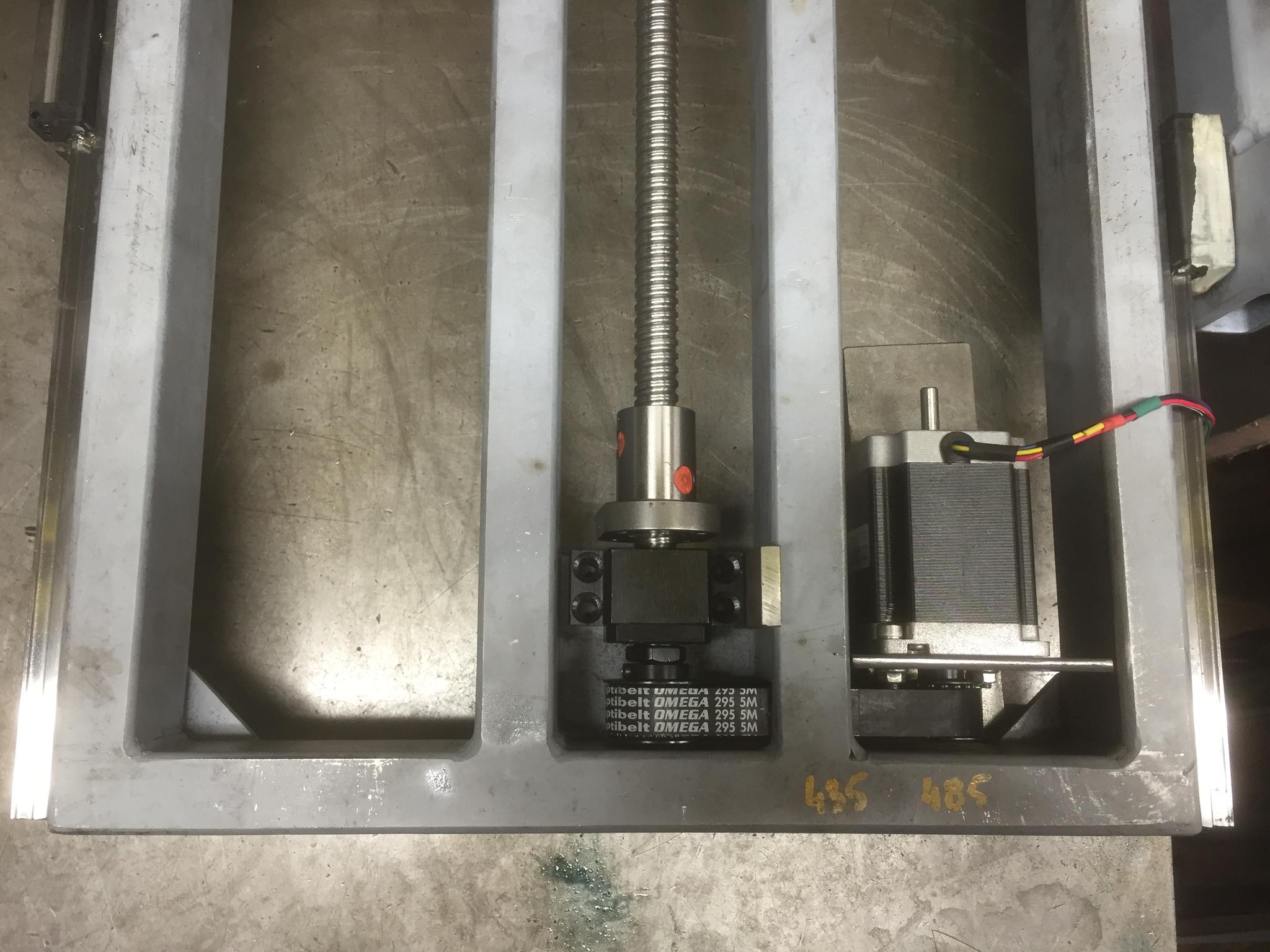

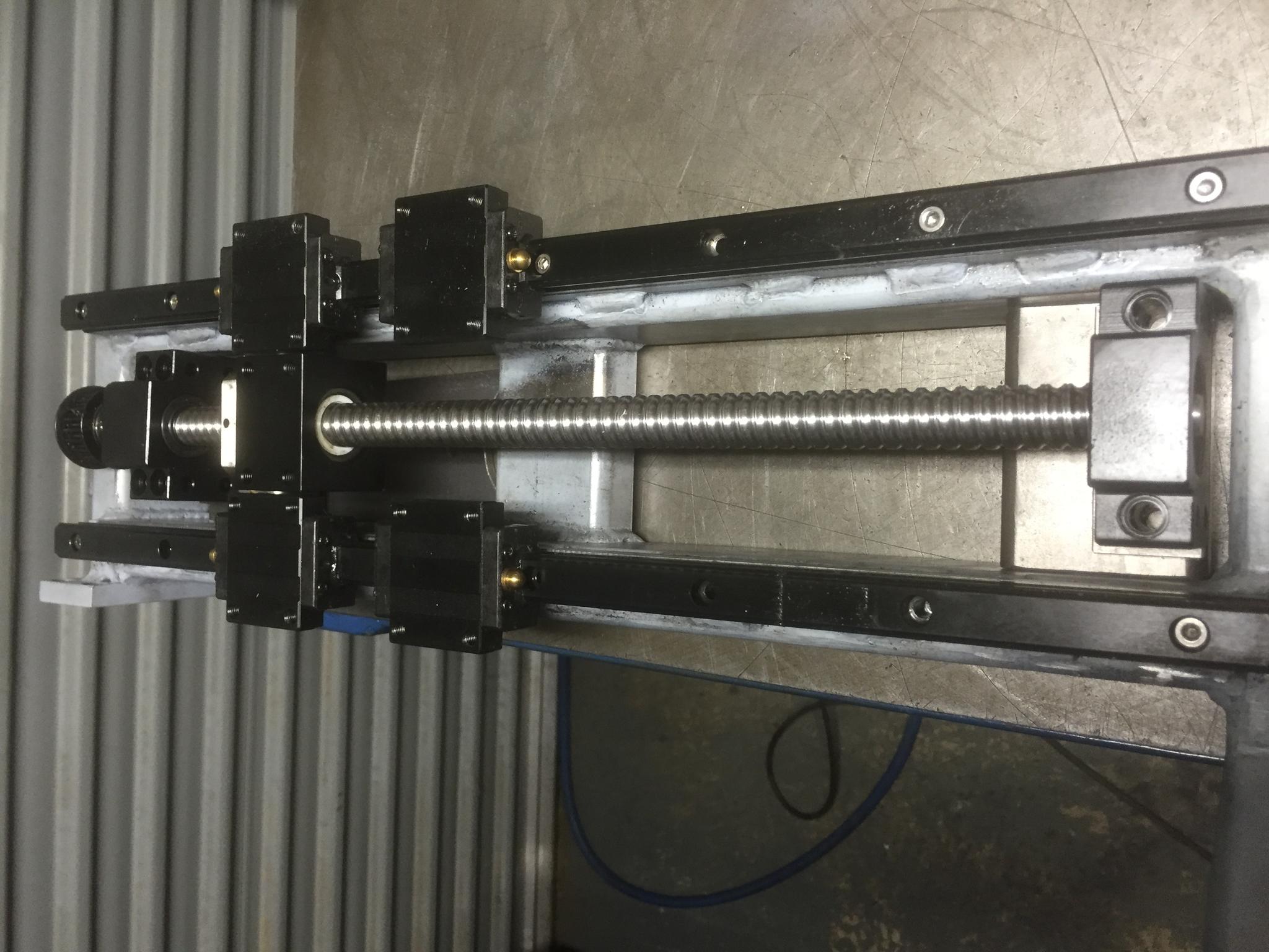

  11. #40

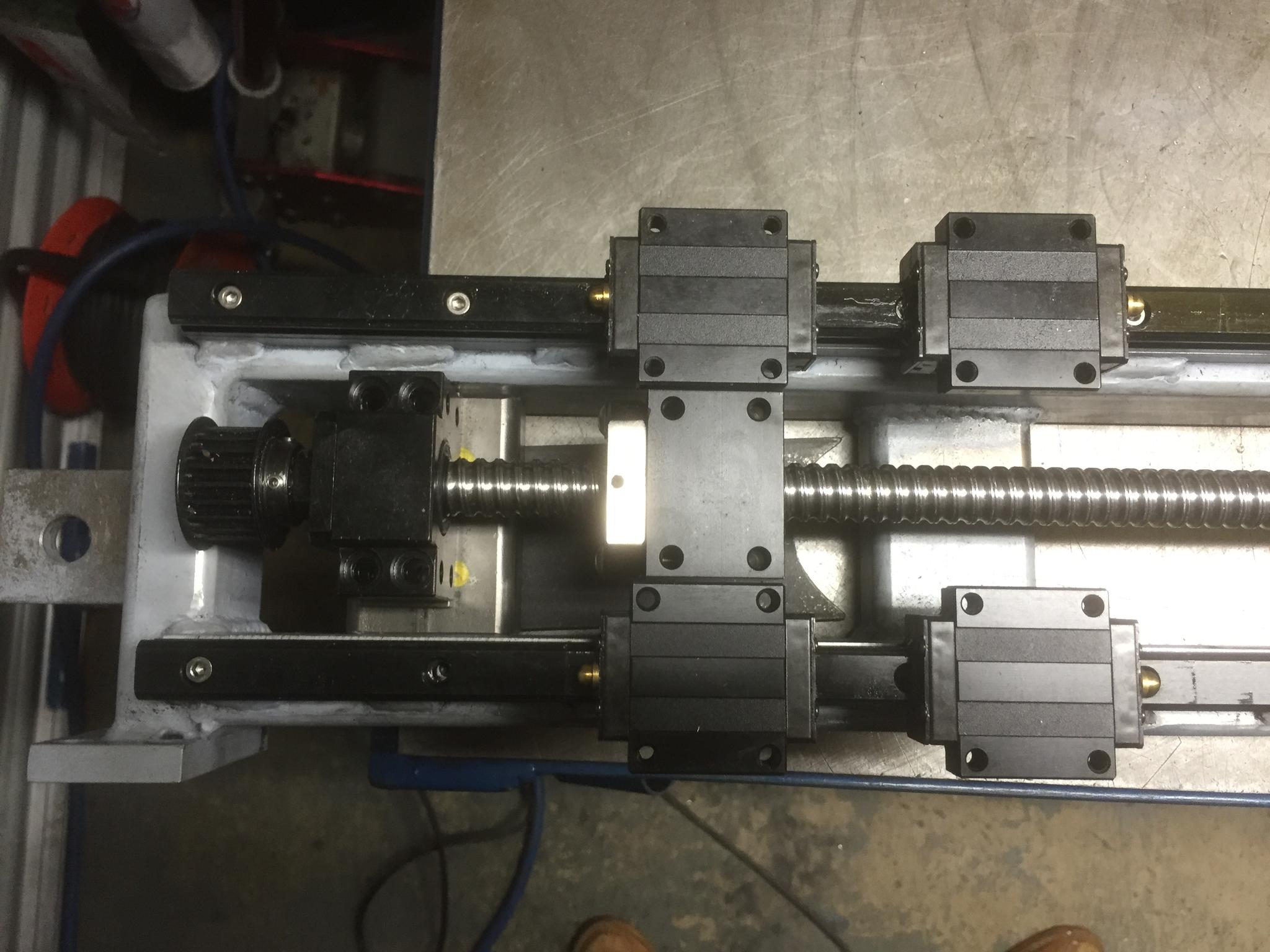

    Here is where design doesn't match reality - X drive motor bracket doesn't make the belt tight, I made all the parts in Solid Works myself - using vernier rather than dimensions data and with belt 295mm long error was like 5mm.
    No big deal - 1hr+ lost for fabrication.
    Here is the gantry. X motor bracket I will made longer and than will cut slots for adjustments. Lesson learnt
