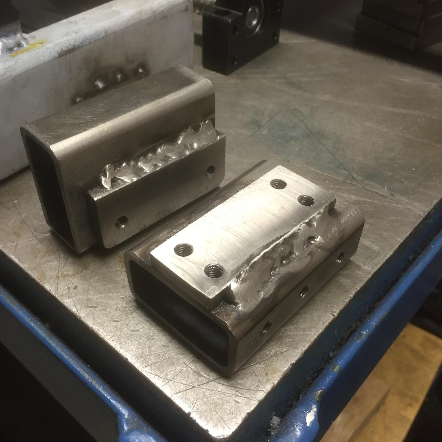

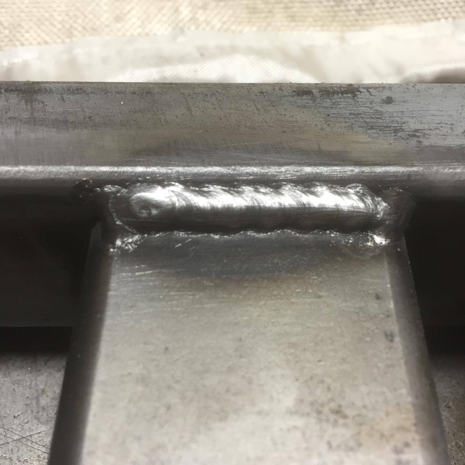

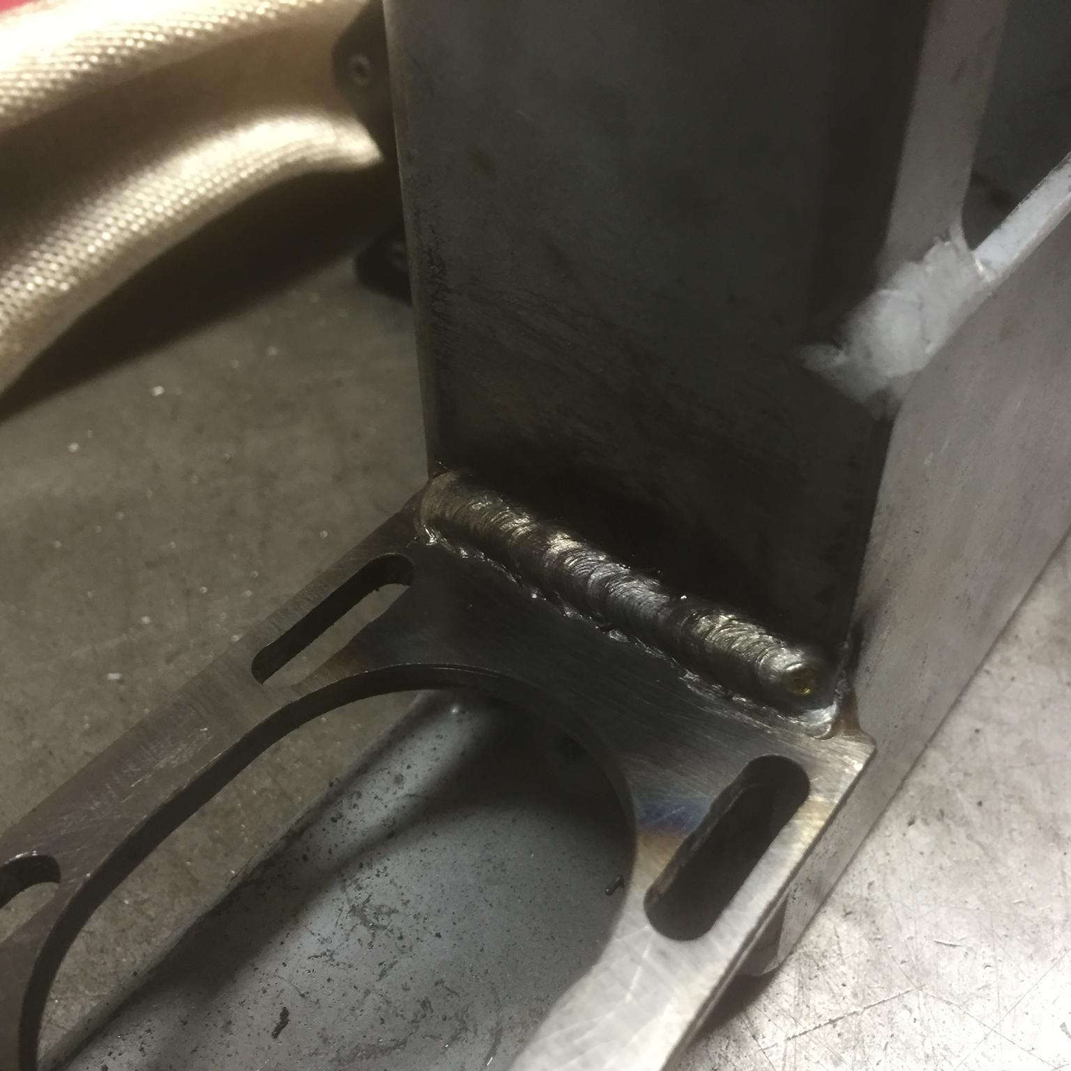

    Another fabrication day.

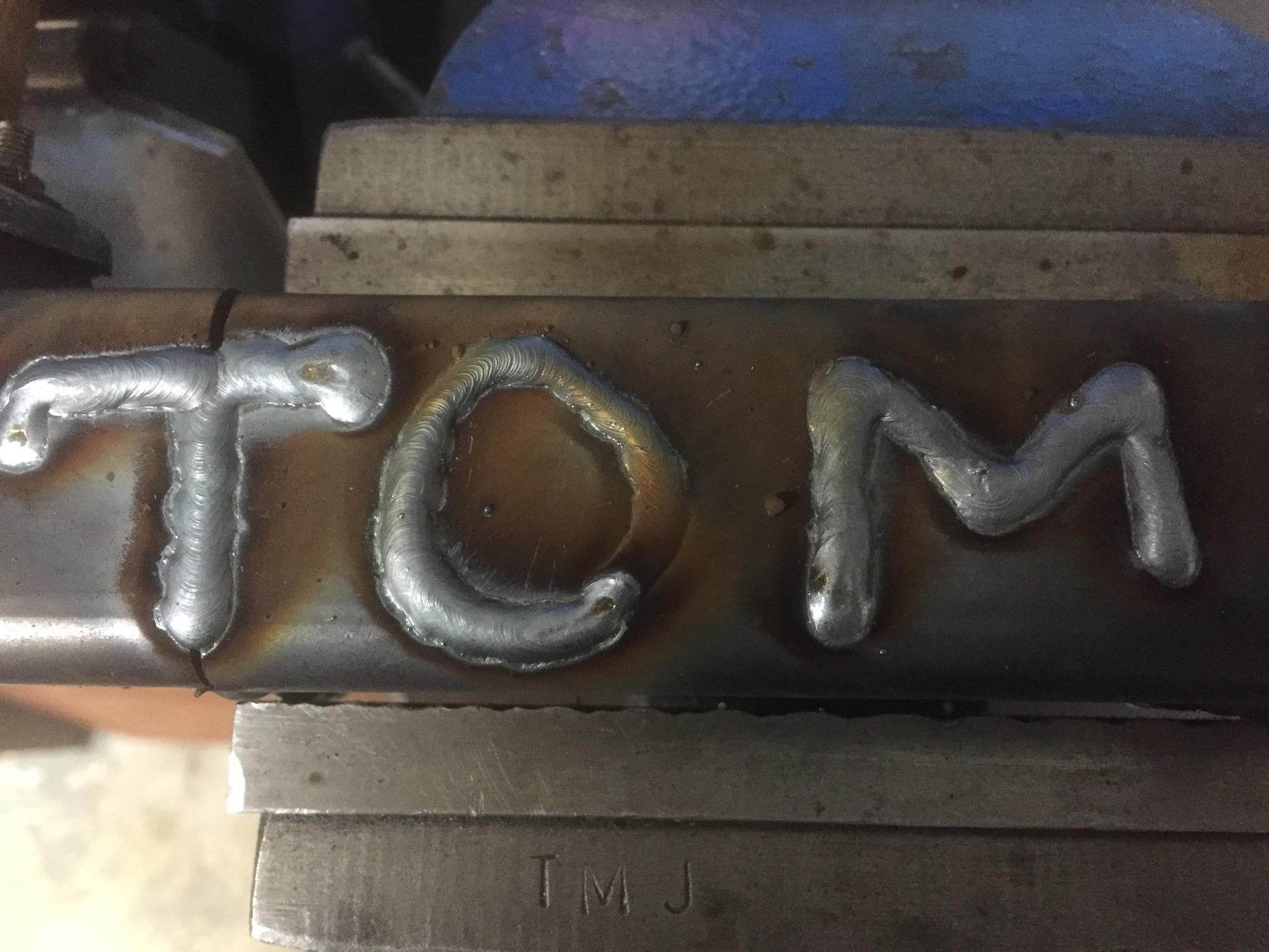

    Done some welding, this time I used 0.6mm wire for trial. Have to say that I am happy with results as my profile thicknes is 2.5mm and other plates are 5mm at this stage.

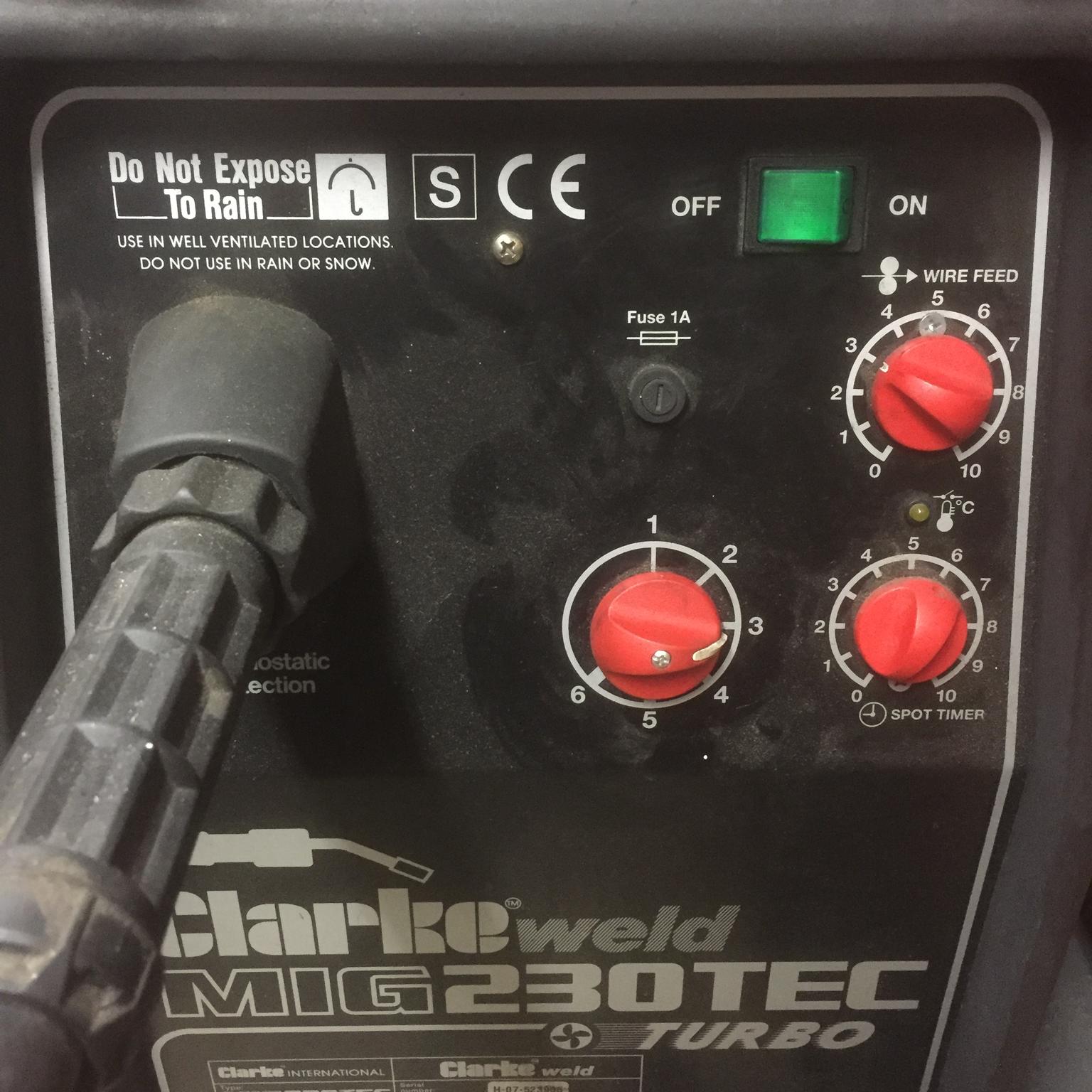

    Welding is all about heat control and avoiding distortion.
    Here is my setting for 0.6mm MIG

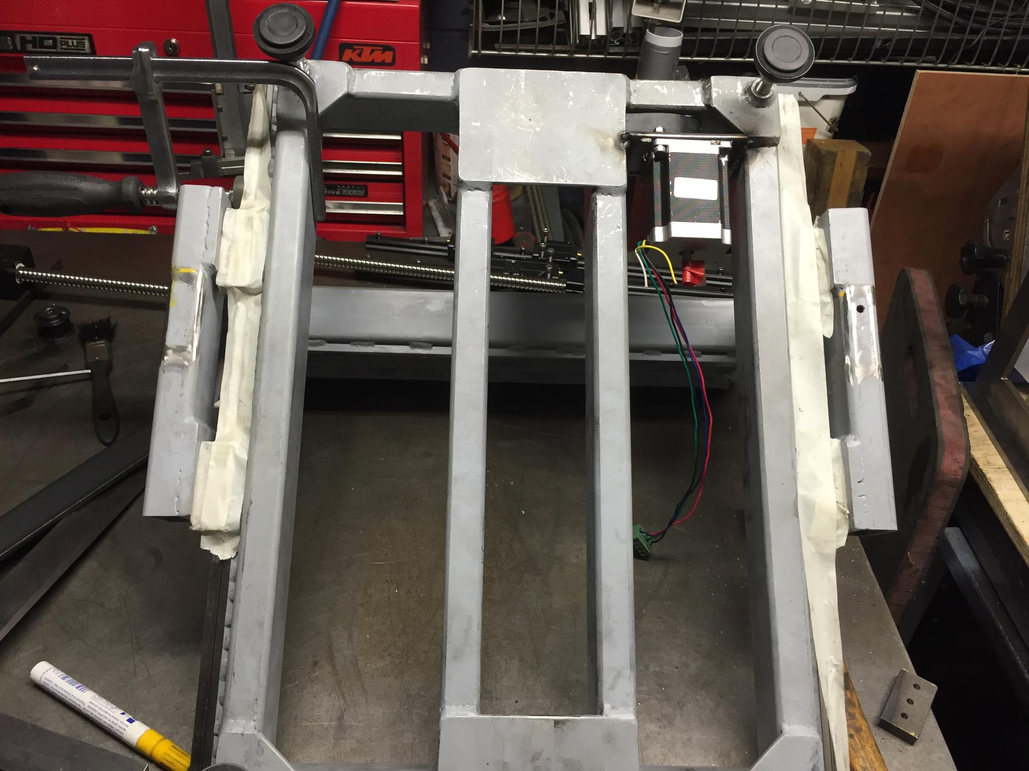

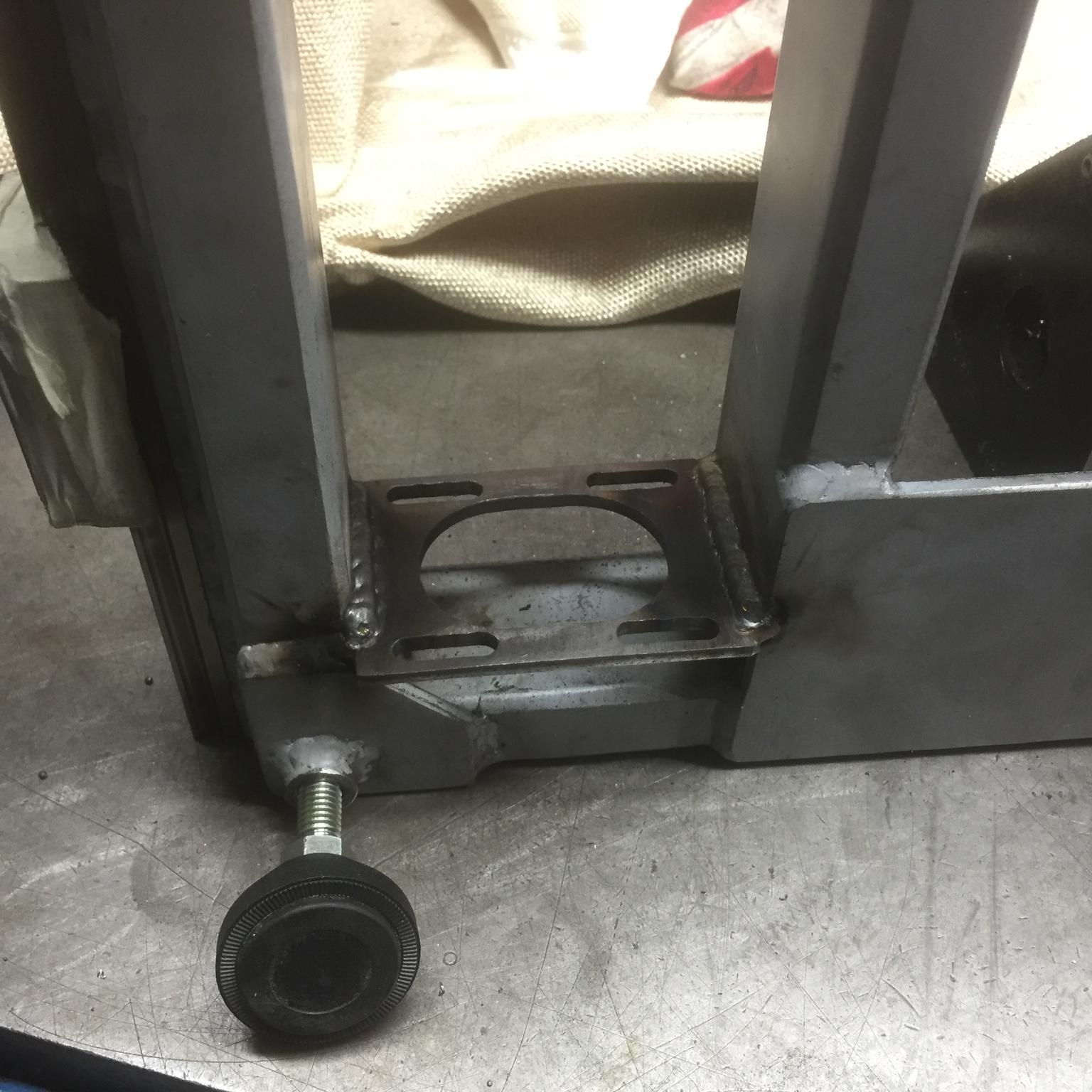

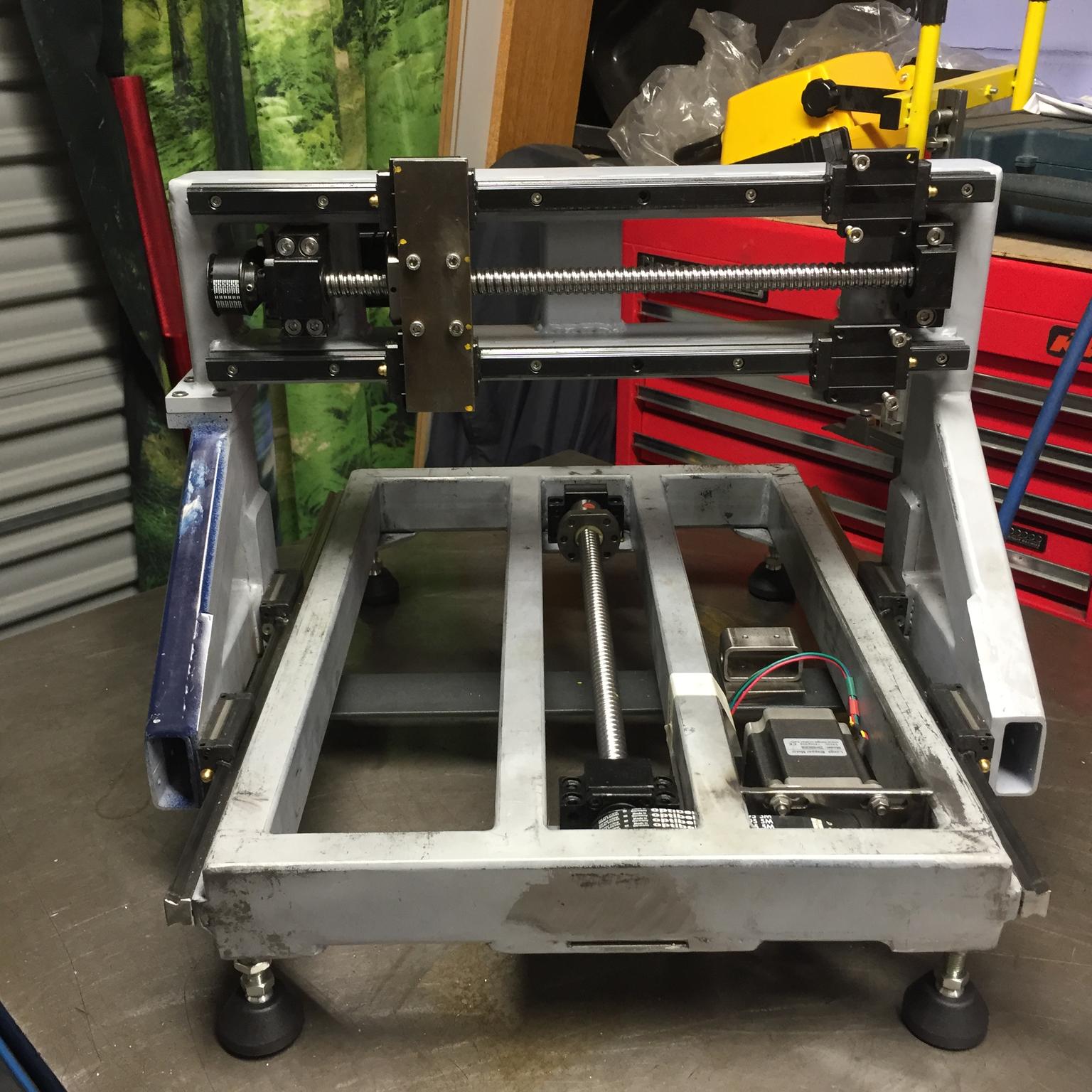

    All major welding is done I believe. Cable chain-carier, table top, sensor will be bolted.
    Here is some shots from today:

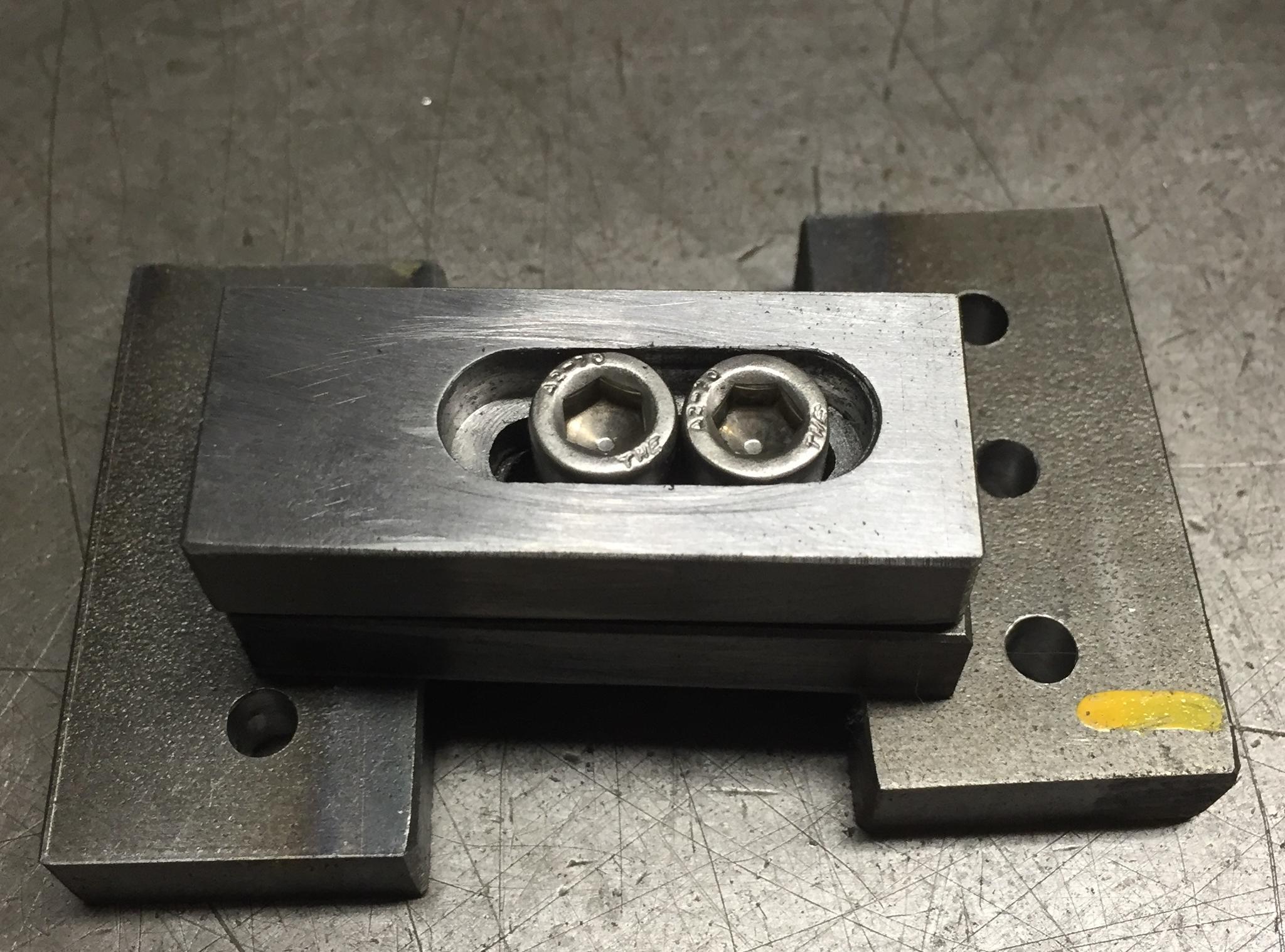

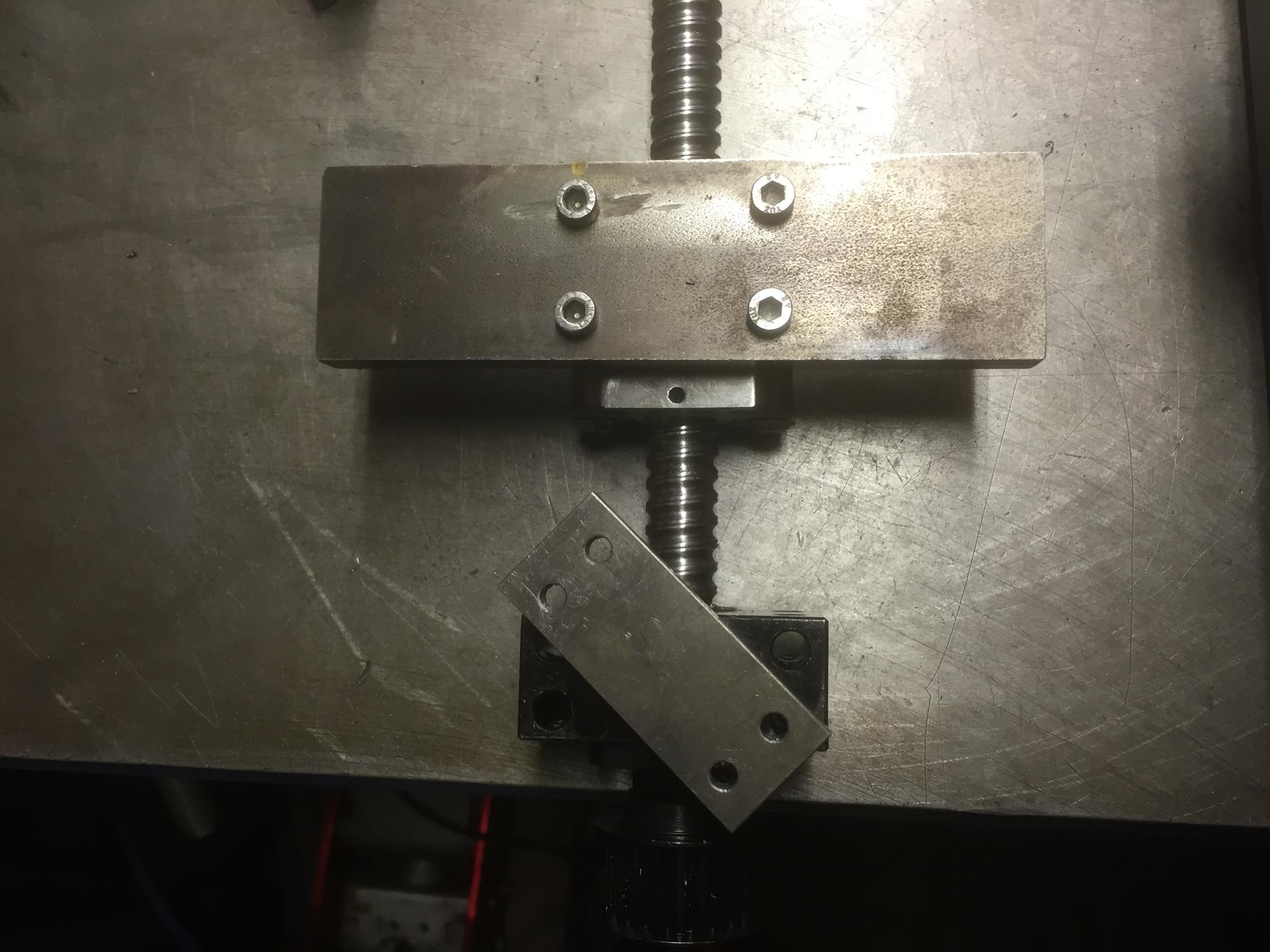

  2. #42

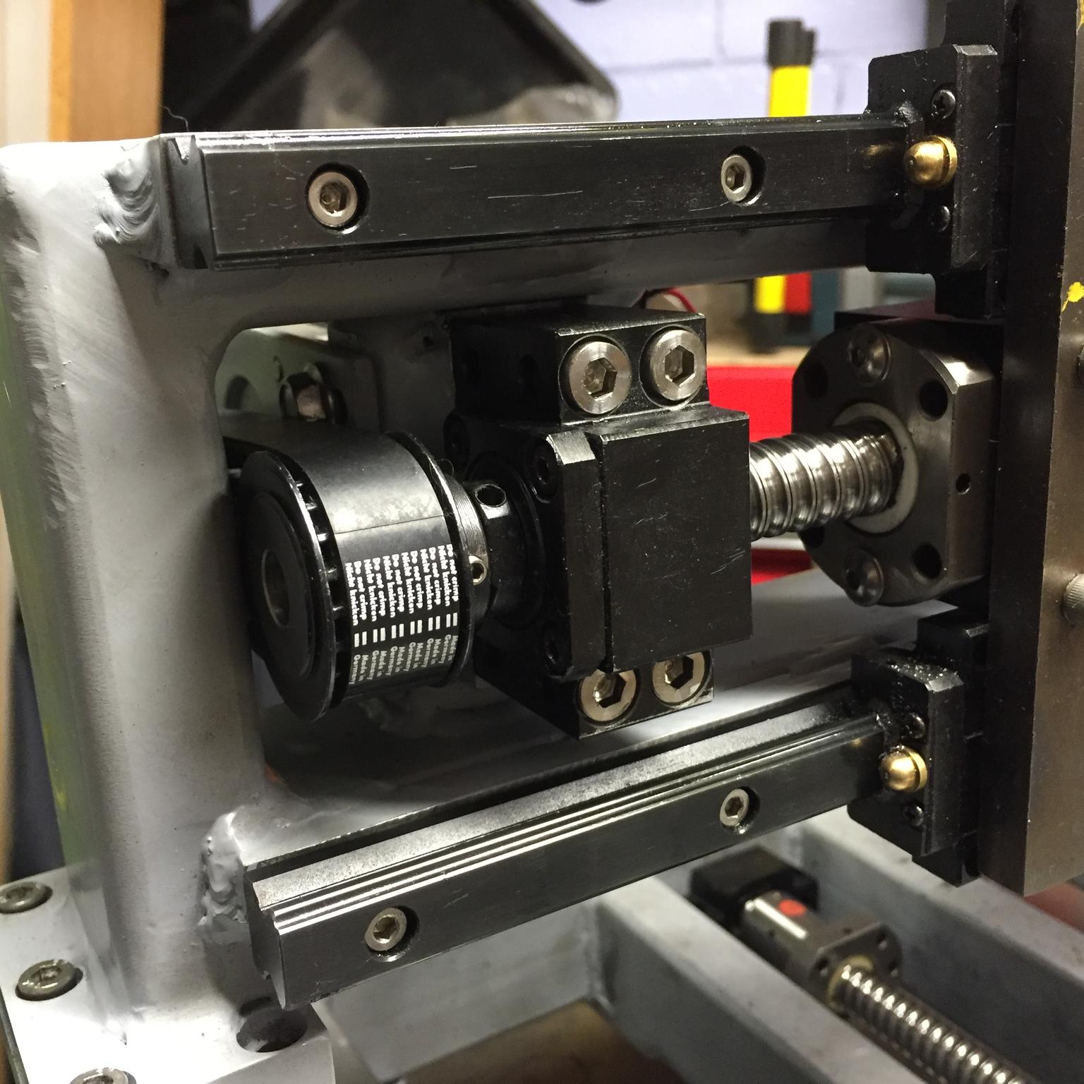

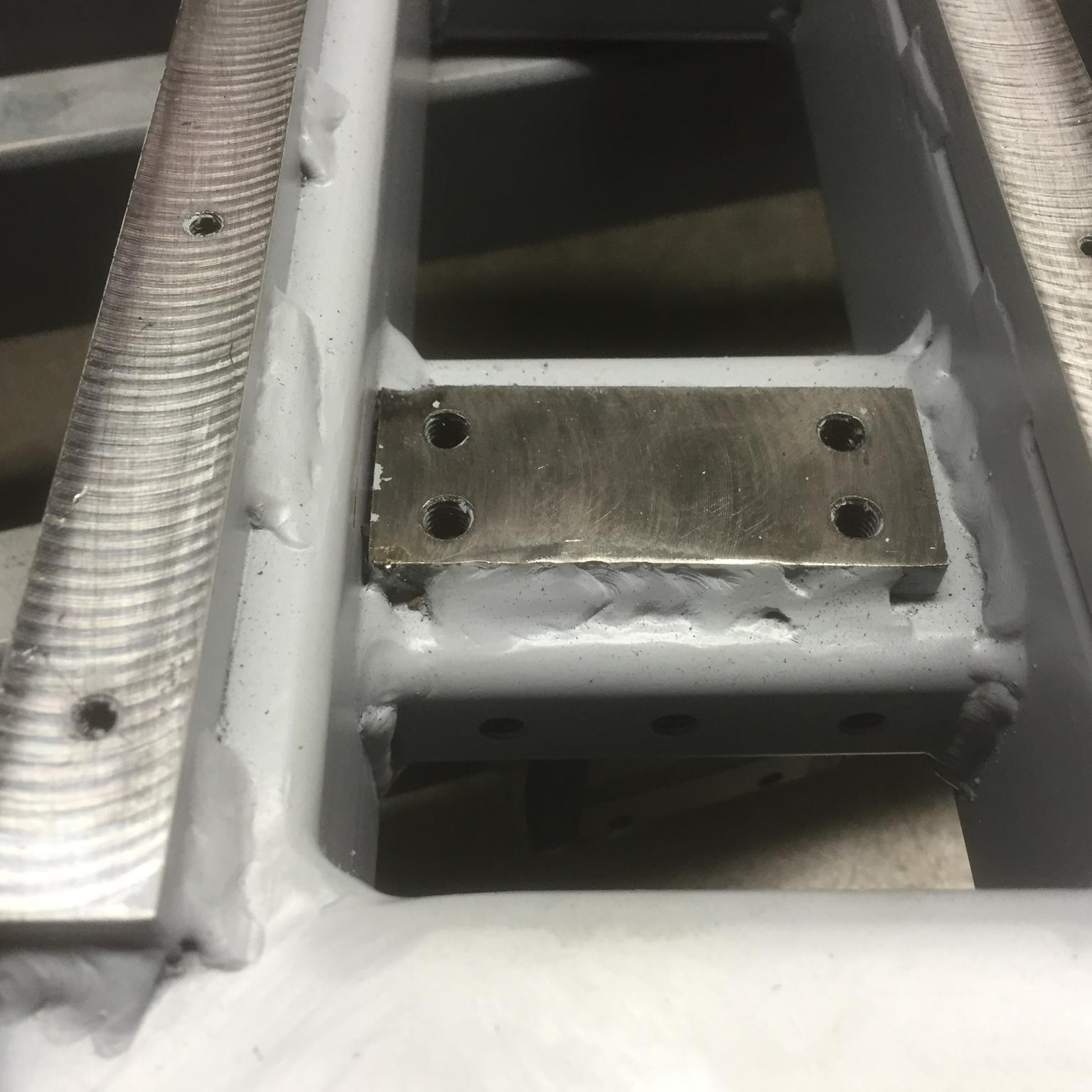

    Time for Y axis drive. Gantry legs will be connected under the bed by flat steel 50x5mm.
    I will use only one ballscrew for moving the gantry as this is desktop size machine (travel distance from left to right is 300mm, forward and backwards only 220mm).
    I sacrificed 80mm of travel on Y for bigger distance between bearing block - stiffness won.

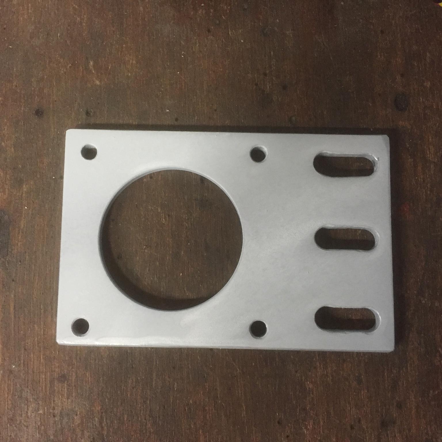

    Had to fabricate Ballscrew nut bracket today - picture later.
    Than I can center the ballscrew mount (front and back) so there is no tension on screw when turns backwards/forward.
    A lot of steps in fabrication depends on previous - all related. Can not jump forward without doing something which have to be done first. Sometimes I loose the plot and do something what shouldn't be doing at that time like - pick up for sensors:
ID:	16842Click image for larger version.
    or sensor bracket/s

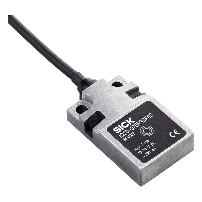

  9. #47
ID:	16887Click image for larger version.

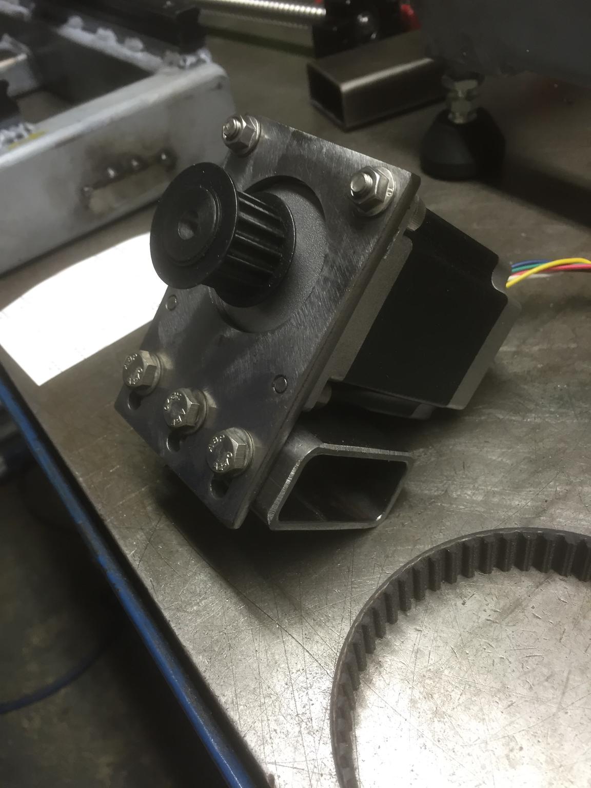

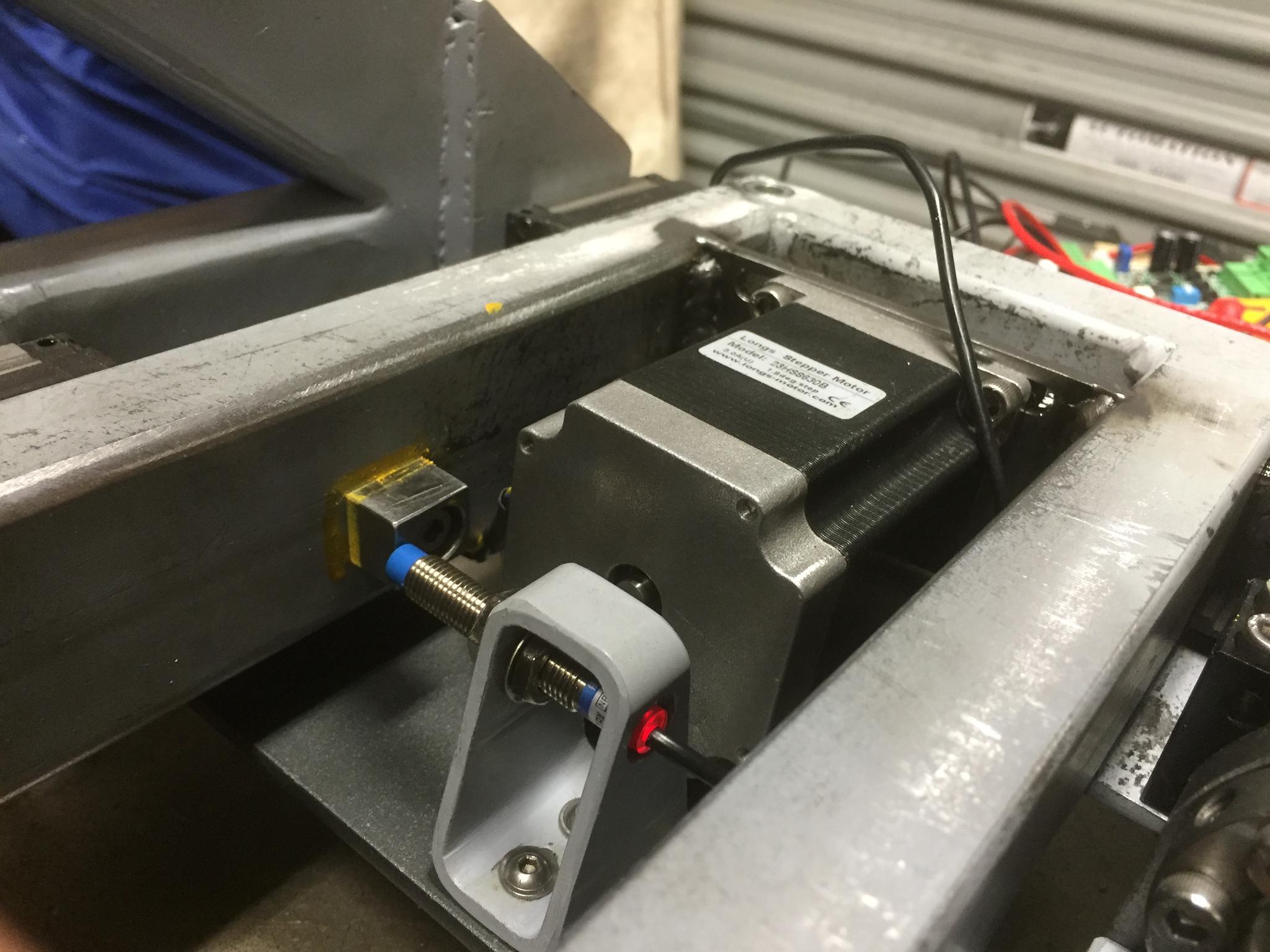

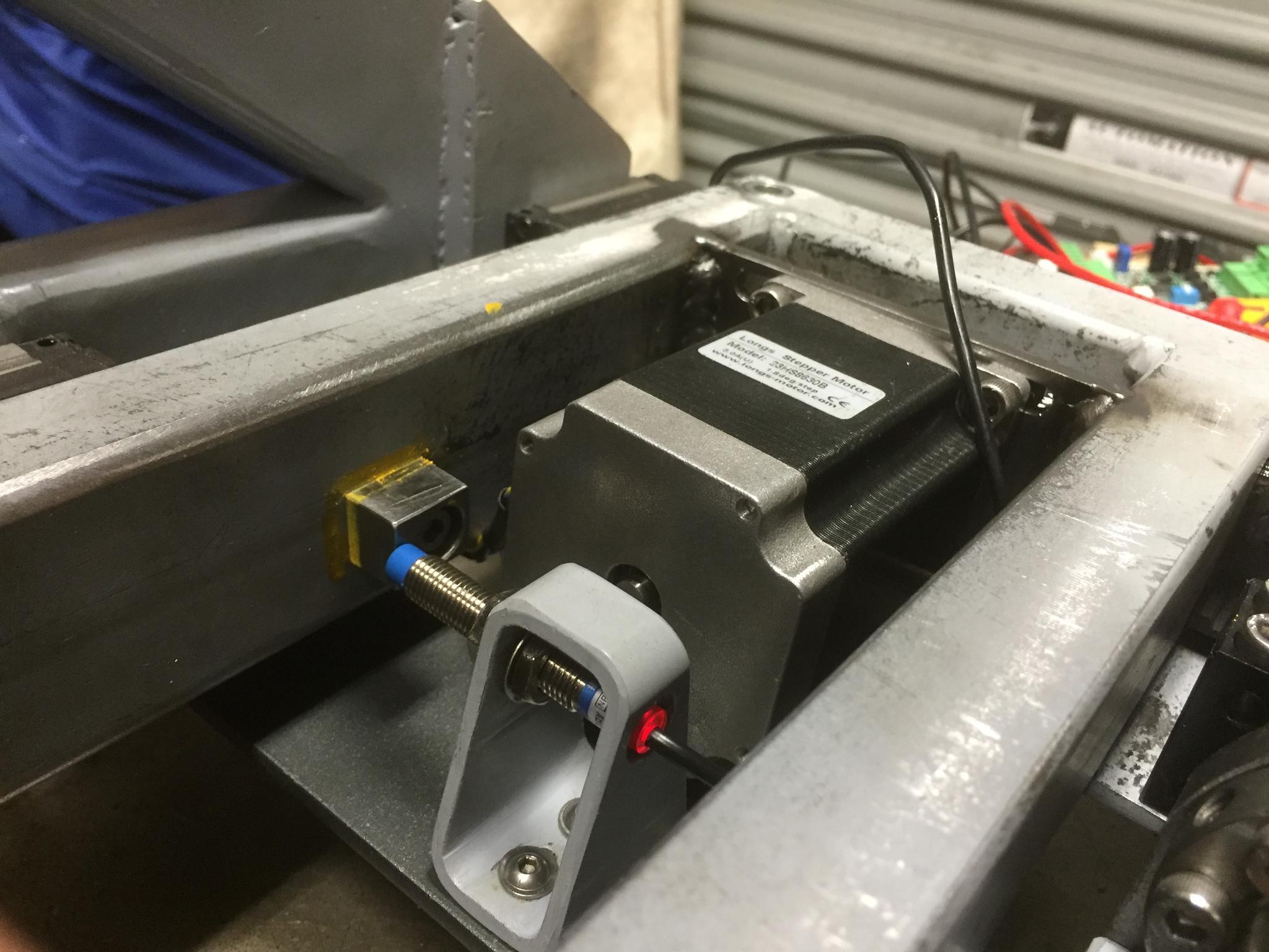

    Got problem with proxy sensor in X axis - not too much room to fit.
    Any recommendation for flat body type and 1-2mm range PNP NC like that:
  10. #48
    I find the Round type better has they give more adjustment. Use traveling switch then you'll only need one per axis and it can travel with Z axis facing down there's plenty of room on back of there for a bracket and loads of room on top of gantry for targets.?

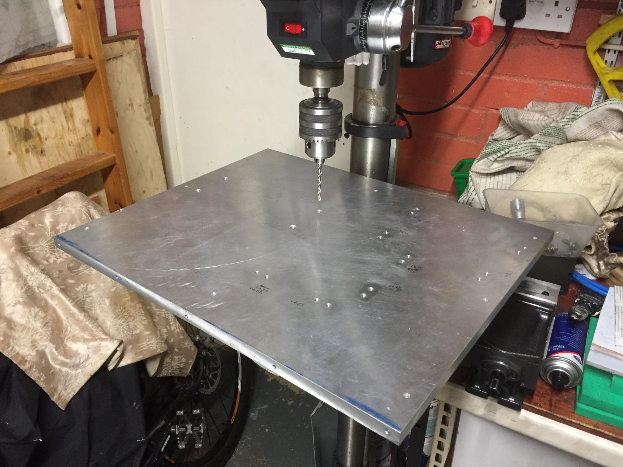

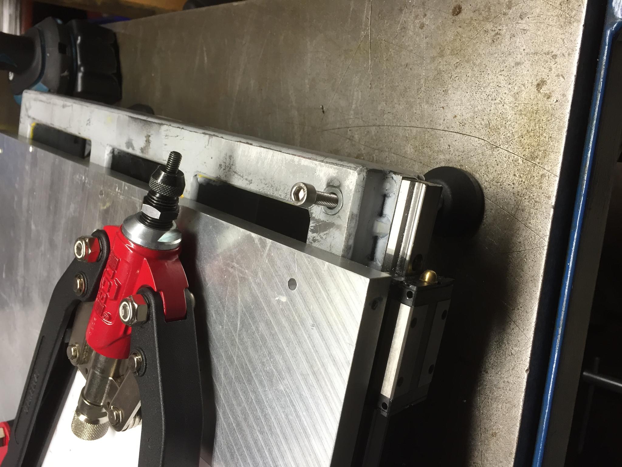

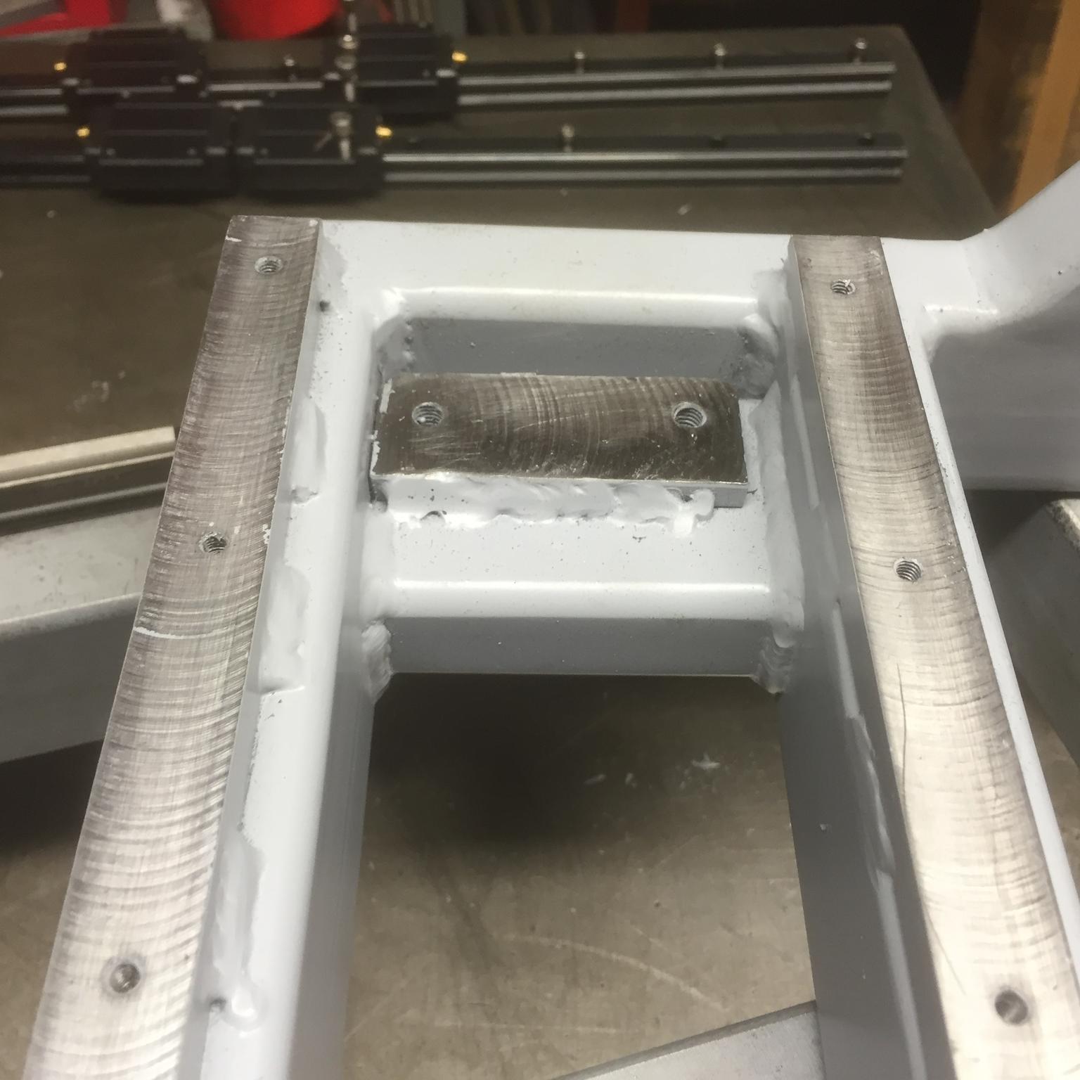

    Got some old alu plate - enough for table

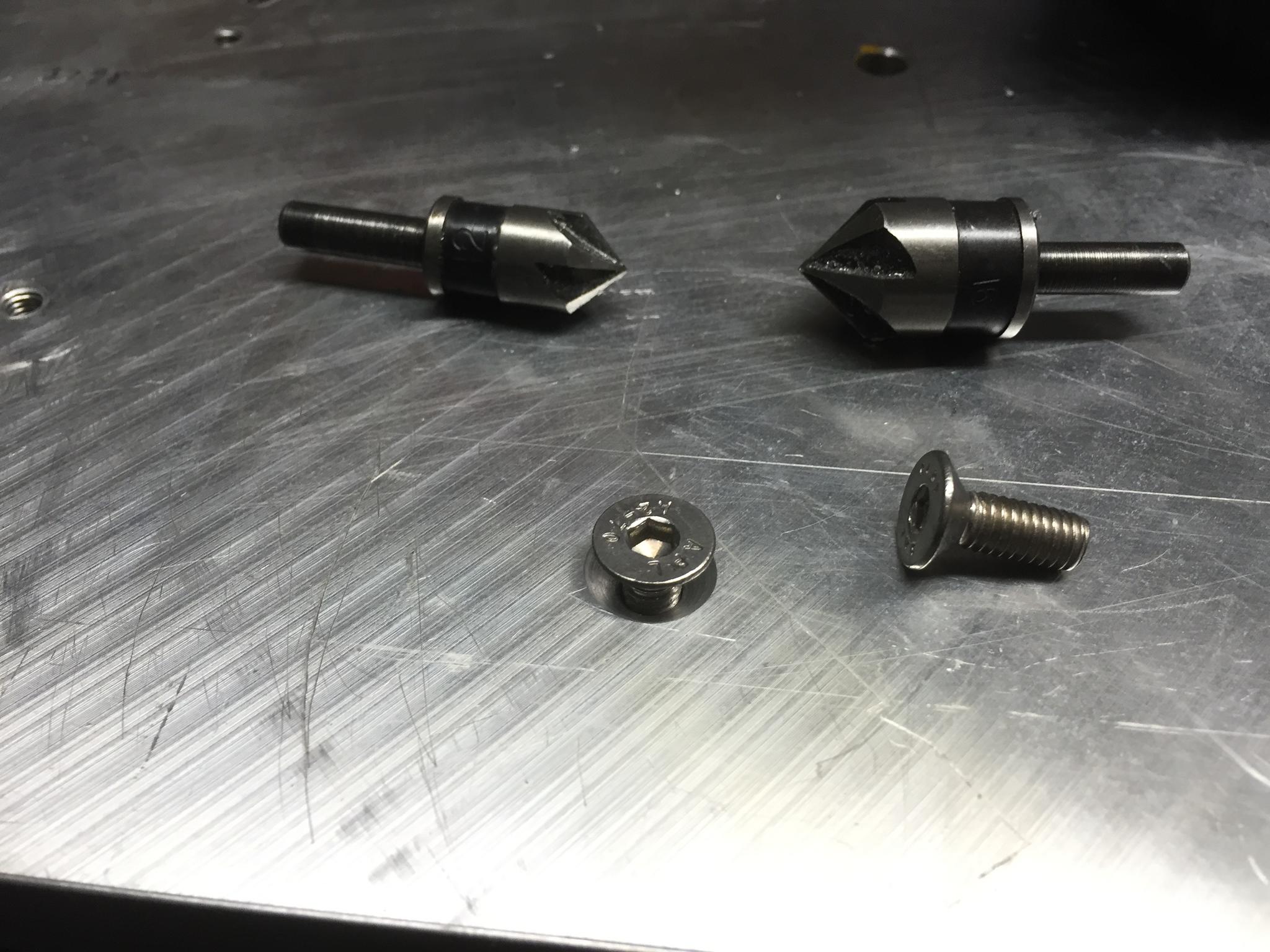

    Bed profile was 2.5mm thick before. Now after surface planing is a bit less so I used thread rivet to fit the table top.
ID:	17584M5 countersink bolts
ID:	17585 One Y sensor for Home and Limit (PNP NC)
  12. #50
    Ali plate will make a nice bed. Any reason you didn't put the proxy on the other side where it can't run into the stepper motor?
    Neil...
