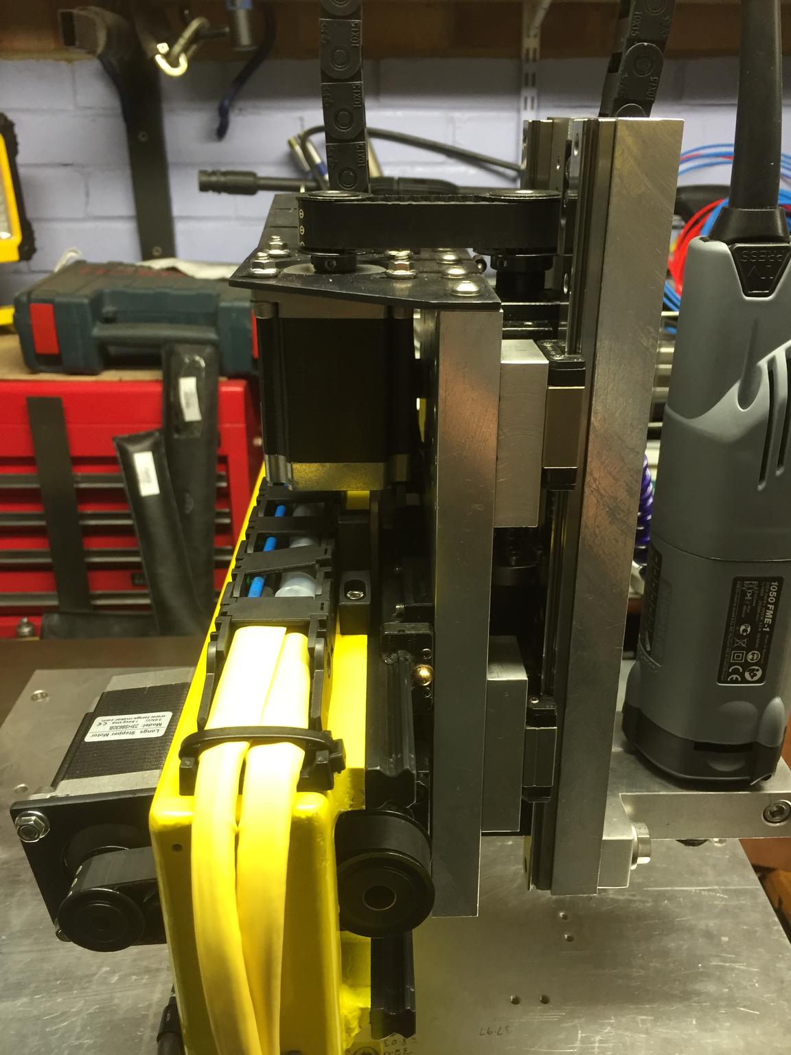

    Yes Neil, here is the reason:
Name:	chain location.jpg
ID:	17586cable chain took space on other side

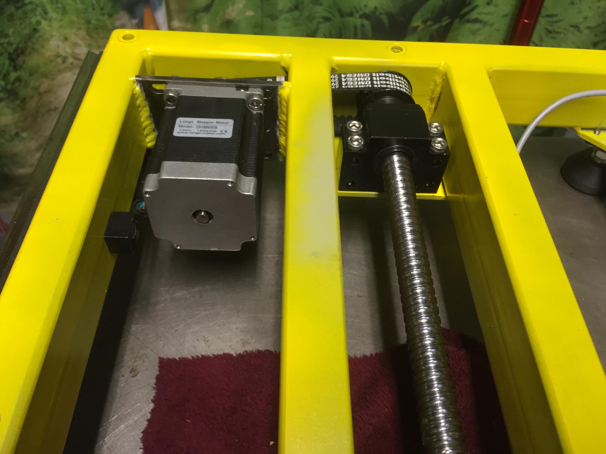

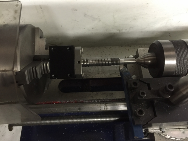

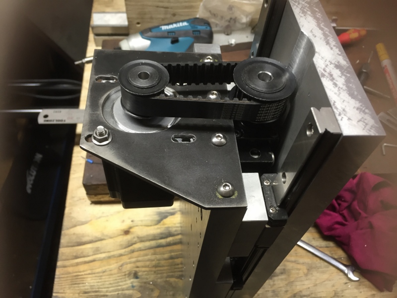

    Working on Z plate. Many problems with low profile rails - will never buy them again. Original plan was to use 5M belt rather than RM14 ballscrew

    I do not recommend Chinese sensors, few of them failed before I finish calibration (one I managed to smash)
    I tried 2mm and 4mm seems to be no difference in accuracy. I wanted to improve accuracy for homing but there is no difference with decent omron mechanical switch - wasted money in my case.
    I use Z18 and Z20 pulley which gives 0.8 gear ratio. Machine mend to mill alloy, so do not need super speed 1400mm/min at 64 microsteps. Might change setting when start cutting P6 alloy or similar.
    I use Digital drivers DM 542 - thanks Jazz for advise, much better, smooth, quiet run.
