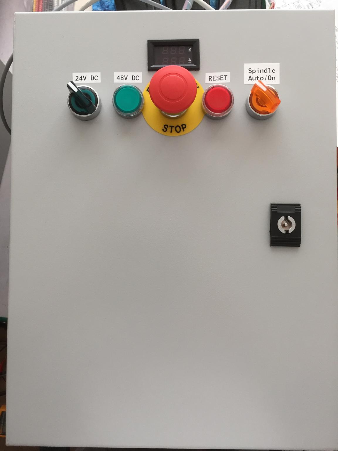

    Here is my new box
ID:	21285Click image for larger version.
ID:	21286Click image for larger version.
ID:	21287Click image for larger version.

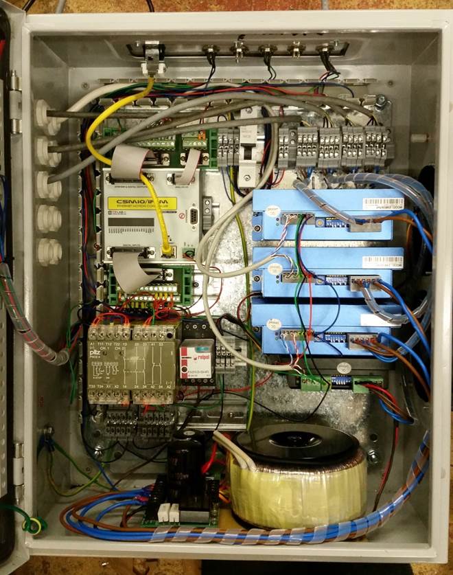

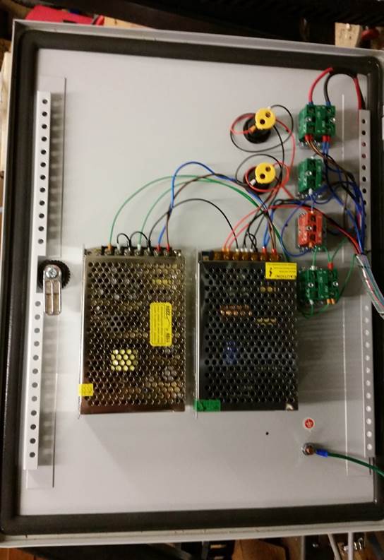

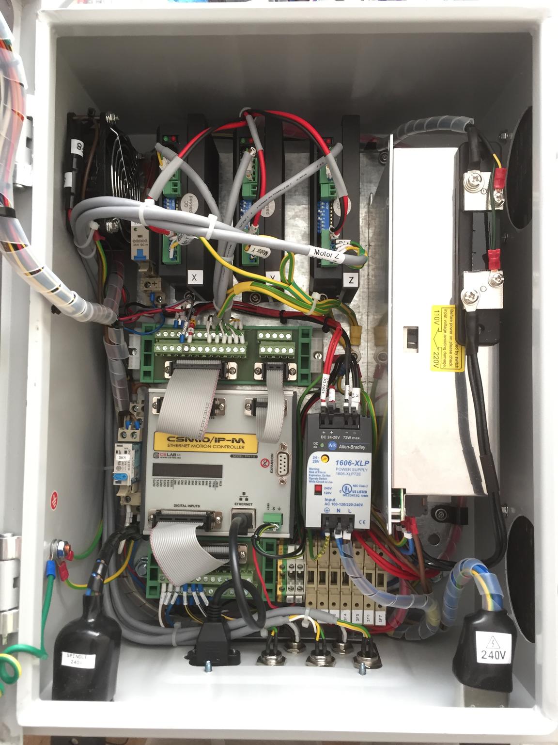

    And our control boxes aren't a million miles apart either:
Name:	cab outside.jpg
ID:	21293 Click image for larger version.
Name:	cab inside door.jpg
ID:	21294 Click image for larger version.
Name:	cab inside.jpg
    I have made some slight changes since I took the pictures - driver feeds to axes are via a row of XLR connectors on the LH side of the cab. I found that I was fitting and removing the cab fairly often when setting up the machine and the hard-wired connections were a pain in the neck. Literally, given their position...
